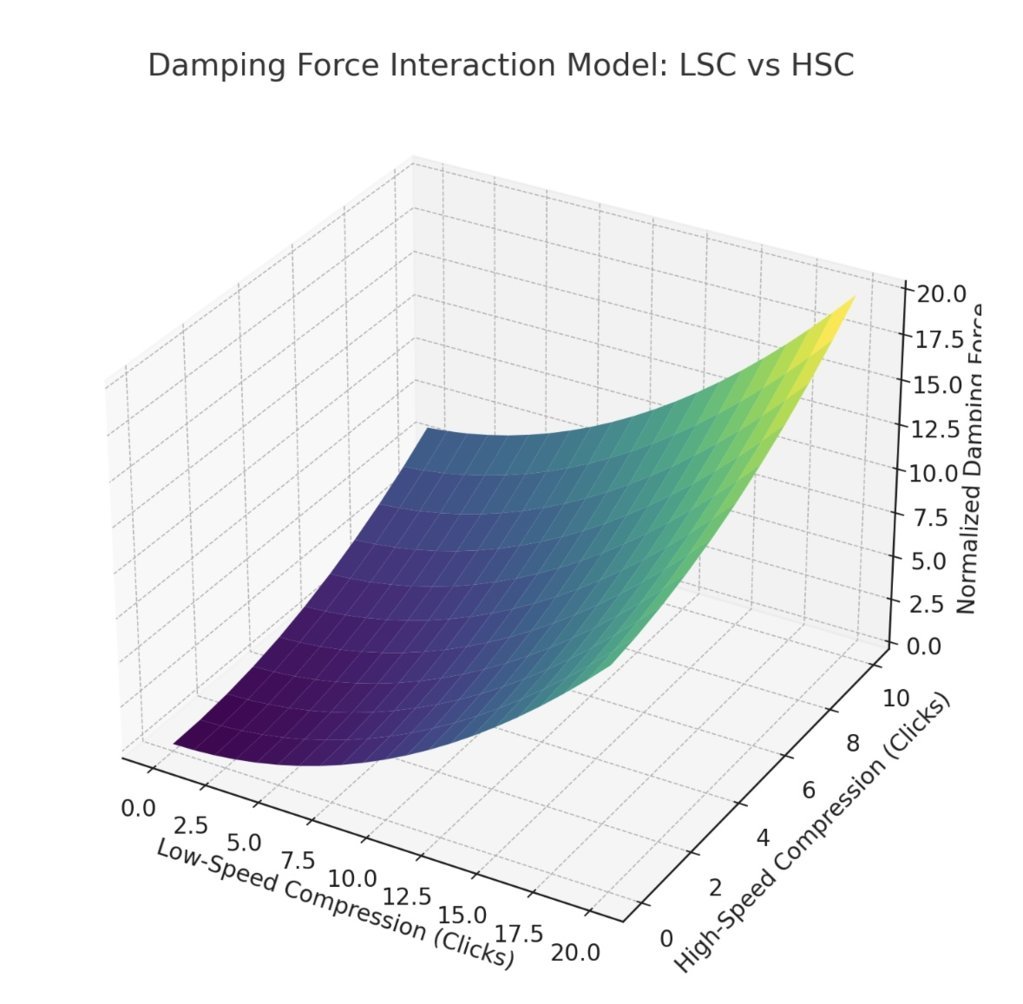

    Also I made a tuning guide using AI if anyone is interested. YMMV.

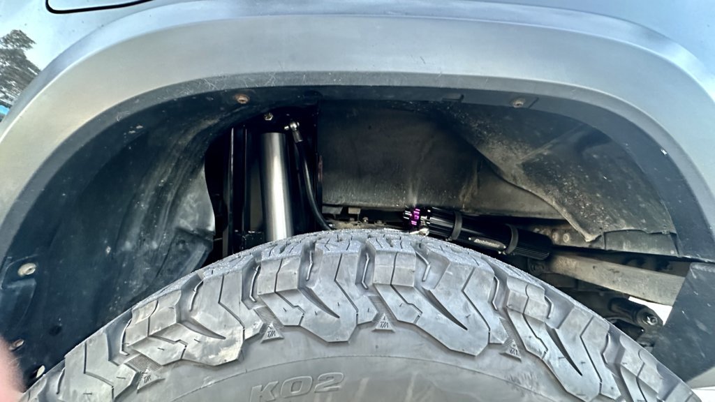

    I also recently replaced my Kings with Dobinson, including the 12" shock in the rear. Happy with the ride quality for the 2 months it's been installed.

    That's awesome, can you also post some photos of how it's setup?

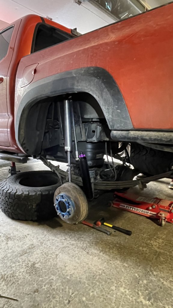

    I really like this rear shock but don't really like the way the reservoir hose looks on the Archive kit. Dobinson hose goes straight down at a 90 where king and fox goes straight out. The only other shock relocation kit that I know of is from BAMF but I don't think the hose will fit in it either.
    @Crikeymike, are there any other relocation kits that work better with this shock and hose that fit on a Tacoma?
    This is the only other Taco I have seen online running these dobi shocks in a 14". They look sweet.

    No, I'm not familiar with any others. If I had those, I'd probably trim out where the hose is by the shock tower down near the bottom to tuck the hose in better. Keep in mind that both ends of the hose have full swivels, so it's possible to get a better angle on it. I also would have rotated the resi around so the hose fitting is on the top, not the bottom of the resi, just to keep the hose higher up. And then take some spare heater hose or that corrugated plastic split loom stuff and wrap it around the hose so that nothing rubs. That hose is going to move around a bit the way he left it, so I'm sure he figured out how and where to hold it down.
    Thanks for sharing that video though, I hadn't seen that yet. Such a big difference with all those changes he made.

    I replaced my 12” king with 12” Dobinson. The hose angle doesn’t bother me, I like how I can rotate it. I’ll try and get another photo.

    Here is a plausible tuning guide after Dobinsons Florida emailed the engineers in Australia. It feels dialed for now until I visit some scales.

    For page 6 of the tuning guide, the "clicks" are counted from fully open, correct? I am almost positive this is the case, but want to double check. Thanks!
  18. Apr 15, 2025 at 11:35 AM
    #198
    Crikeymike
    Crikeymike ExitOffroad.com Vendor
    Oct 17, 2016
    #199985
    2,055
    Jax Beach, Florida
    Lefty loosey all the way out is zero. Right to tighten, like a regular bolt.
    BlueFourMike likes this.
  19. Apr 15, 2025 at 11:47 AM
    #199
    BlueFourMike
    BlueFourMike What does this button do?
    Oct 2, 2018
    #268185
    311
    Vlad
    North Carolina
    2018. Black. Tacoma. Professional.
    Many.
    Yes. Clicks from open on compression and rear shock rebound adjusters.
    Front coilover rebound doesn’t stop at fully open so just to be safe and not lose a detent ball I subtract the recommended clicks from 25 then count from fully closed.
    bttrbsch[QUOTED] likes this.
