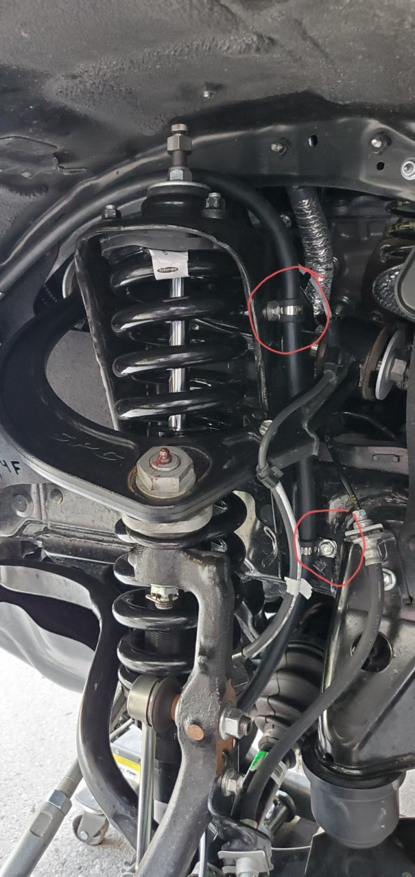

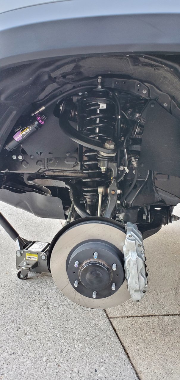

    Right now I have the front set at Rebound 3, LS 6, HS 5. Rear Set at Rebound 2, LS 3, HS 2. Probably will play around a little more but this has been very good so far..
    I attached pictures of the drivers front and one with where I drilled and tapped for the hose clamps.

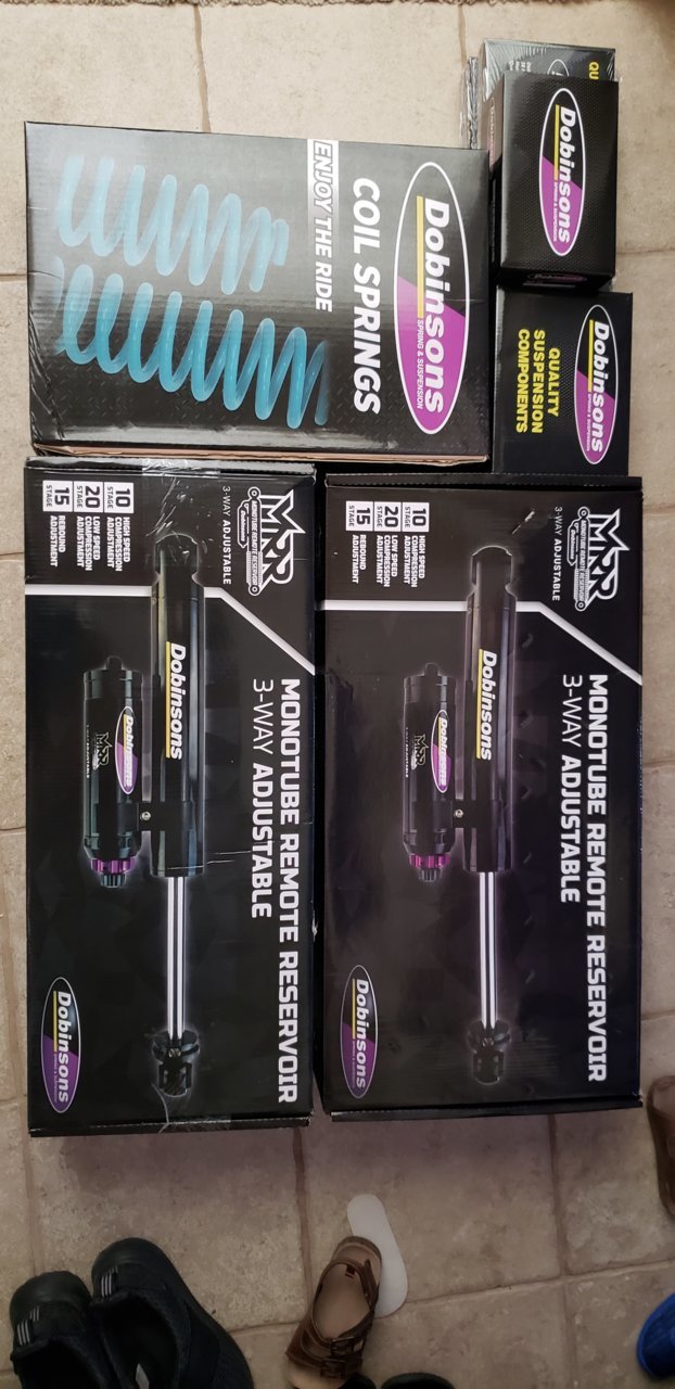

    My package came in today, waiting on the dirt king ucas on Tuesday before I start...
    @Crikeymike , what adjustment would you recommend for mostly hwy driving and occasional light trails???

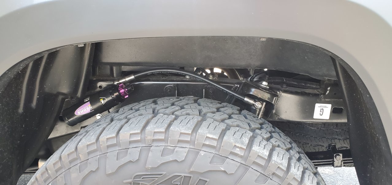

    The Rear MRA has a RR with adjusters. Or are you looking for nonadjustable?
    Pic of my rear RR
