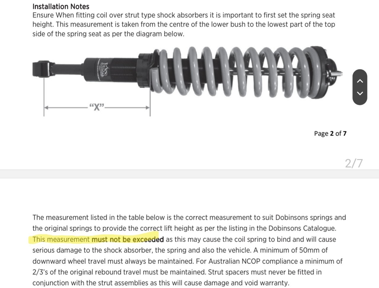

    Was wondering after around 2 months of install Id like to adjust the ride height.. rather than go up and down with the collars, which way should we go...
    Make the coil tighter increase ride height?

    If you turn the adjustment nuts up on the shock body (make the coil tighter in your terms) it will increase the ride height. It's about a 2:1 ratio, so if you adjust the collars up 1/4" it will change your ride height about a 1/2" but YMMV.

    Im not sure about height as the instruction refer to exceeding the parameters.
    Must be some wiggle room... Not sure how much tho.. kinda pointless haveing adjustable ride height if it's not recommended to do so

    What spring do you have installed? @Crikeymike can tell you what seat height not to exceed. When I had the 314 spring he recommended not to go over 230mm seat heigh on those.
    The max would be just so the coils don't bind when the suspension is fully compressed but you don't want to go that far. If you set ride height to high then there is no down travel left in the shock and it will affect ride quality in a bad way. In an ideal world setting the shock in the middle of the stroke would the best.

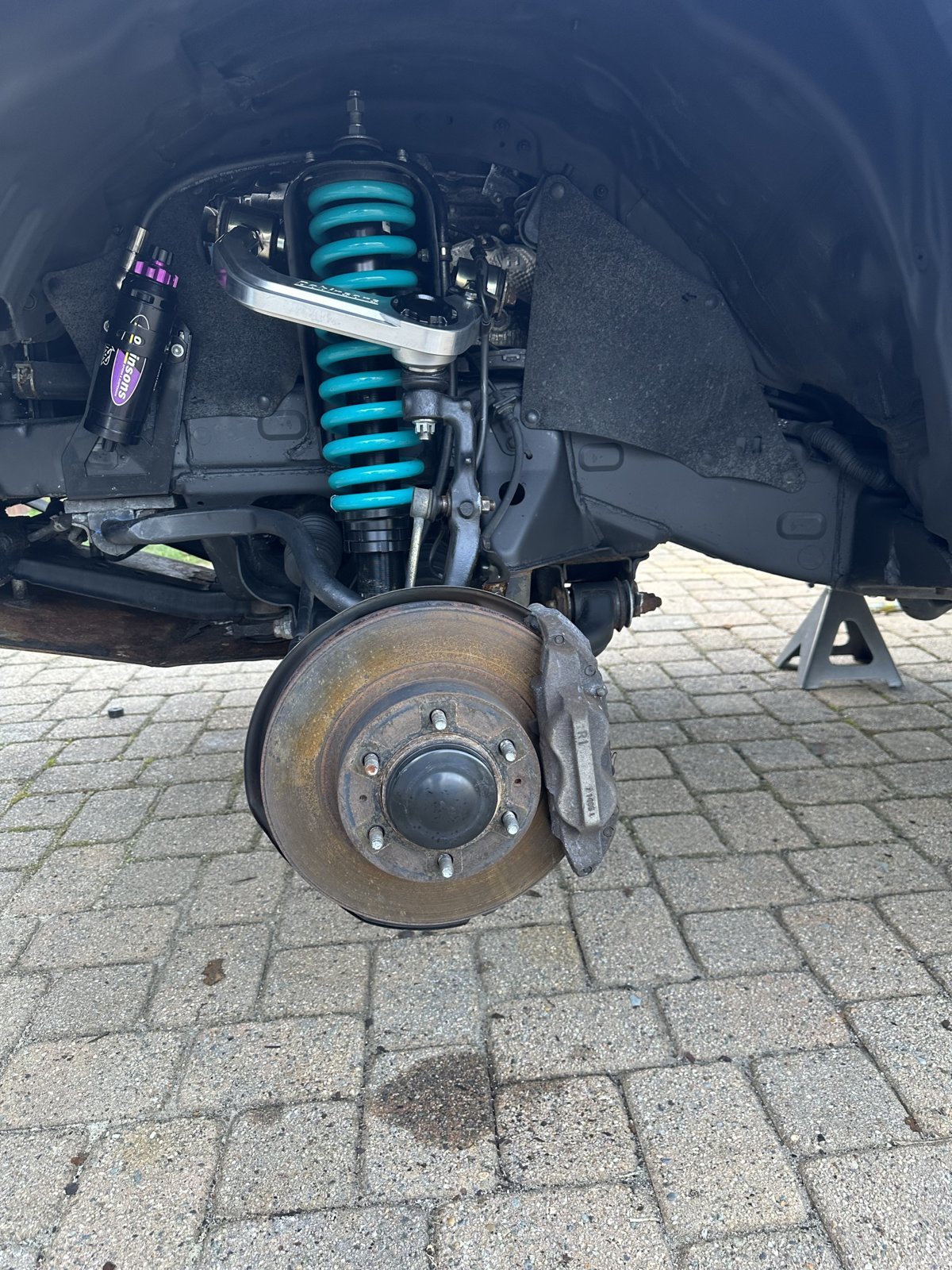

    Anyone have any tricks adjusting these while they're on the truck? Got some installed a few weeks ago and got some settling to handle. Looks like best way to take the wheel off and drop the sway bar?

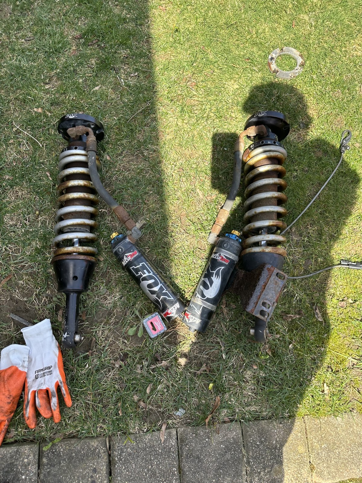

    My Fox were toast after 4 years with a rebuild at year 2. Rarely driven. Car wash with under carriage weekly.
    Replaced with MRRs this week.
