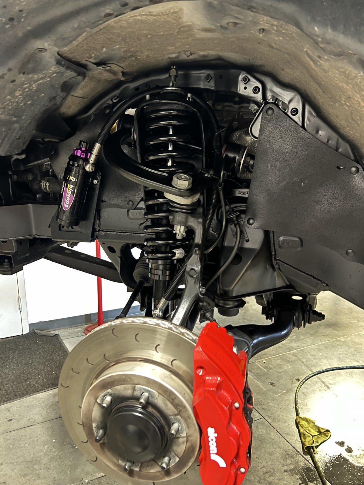

    Installed my MRR setup a few months back and was sure to give everything a healthy coat of fluid film.

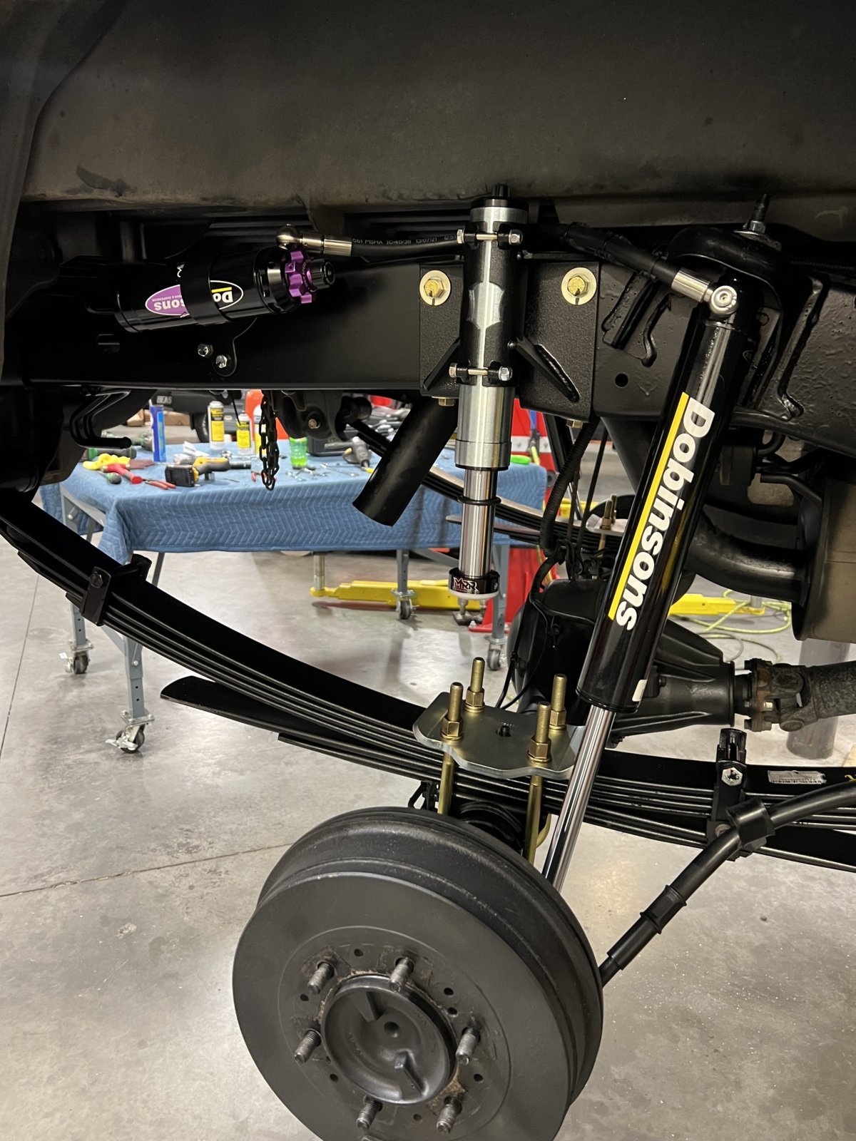

    Finally got a chance to install my setup. Hydro has already been changed over to a 2.5. Was just testing the 4.0 to see clearance. I'm running 318 in front and 111R in rear. I have a 112 leaf that I'm installing sometime this week. Need a little more out of the ass.
