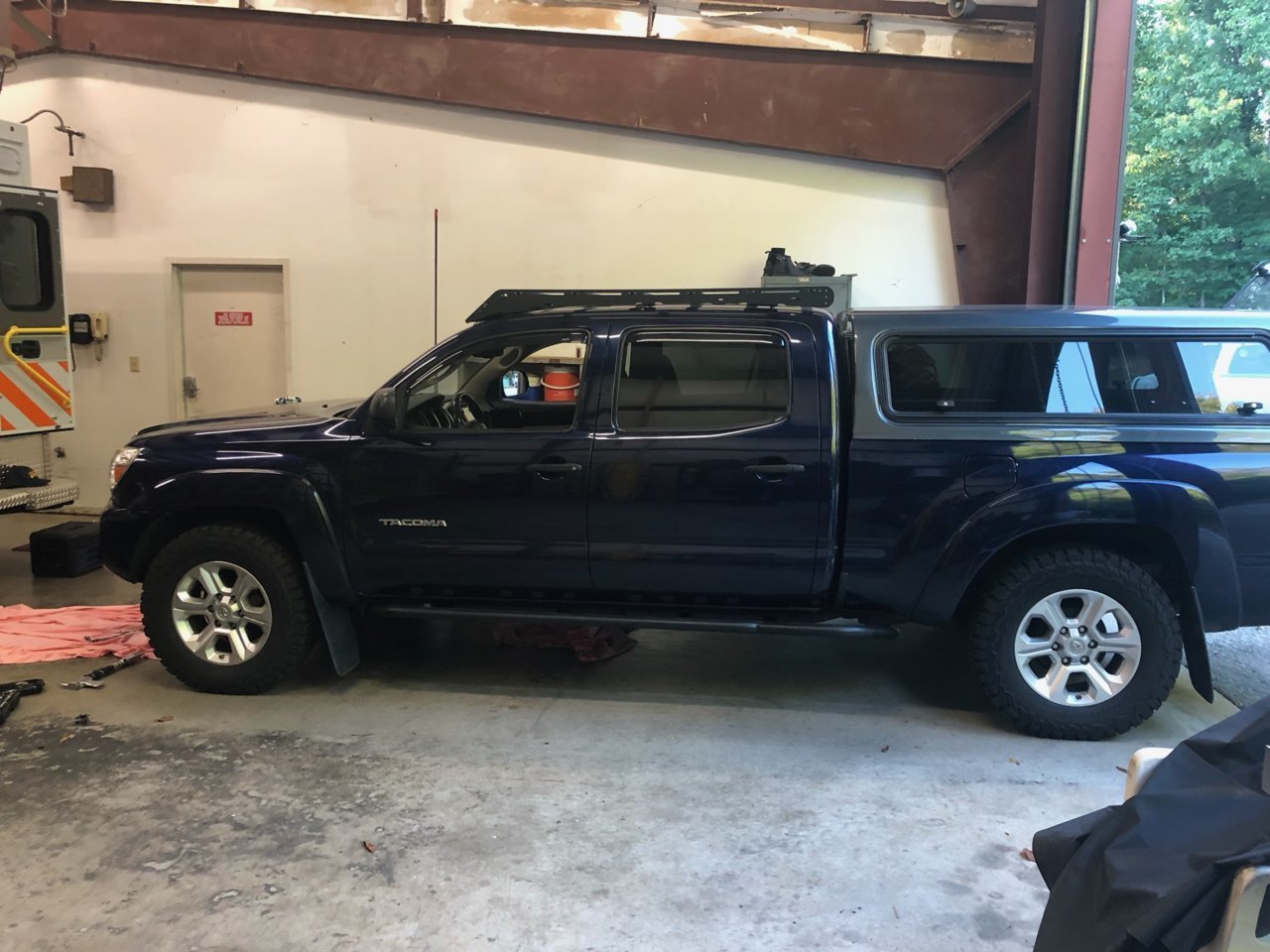

    I'm running the Dobinsons IMS adjustable front struts(2"-3") with springs along with the rear HD leafs with JBA UCA's. I set mine right at 2".
    I didn't do a diff drop, but I did get the ECGS bushing along with a carrier bearing drop.
    @Crikeymike was a great help answering my many questions while I tried to decide on a lift. He never bad mouthed the other companies I asked about, just gave me the numbers comparing Dobinsons to the others. His customer service is second to none. He earned a repeat customer out of me.
    Stock with full @SOS CONCEPTS skids, sliders, camper, and decked system. 255/70/17
    Post lift(same stuff as above)
