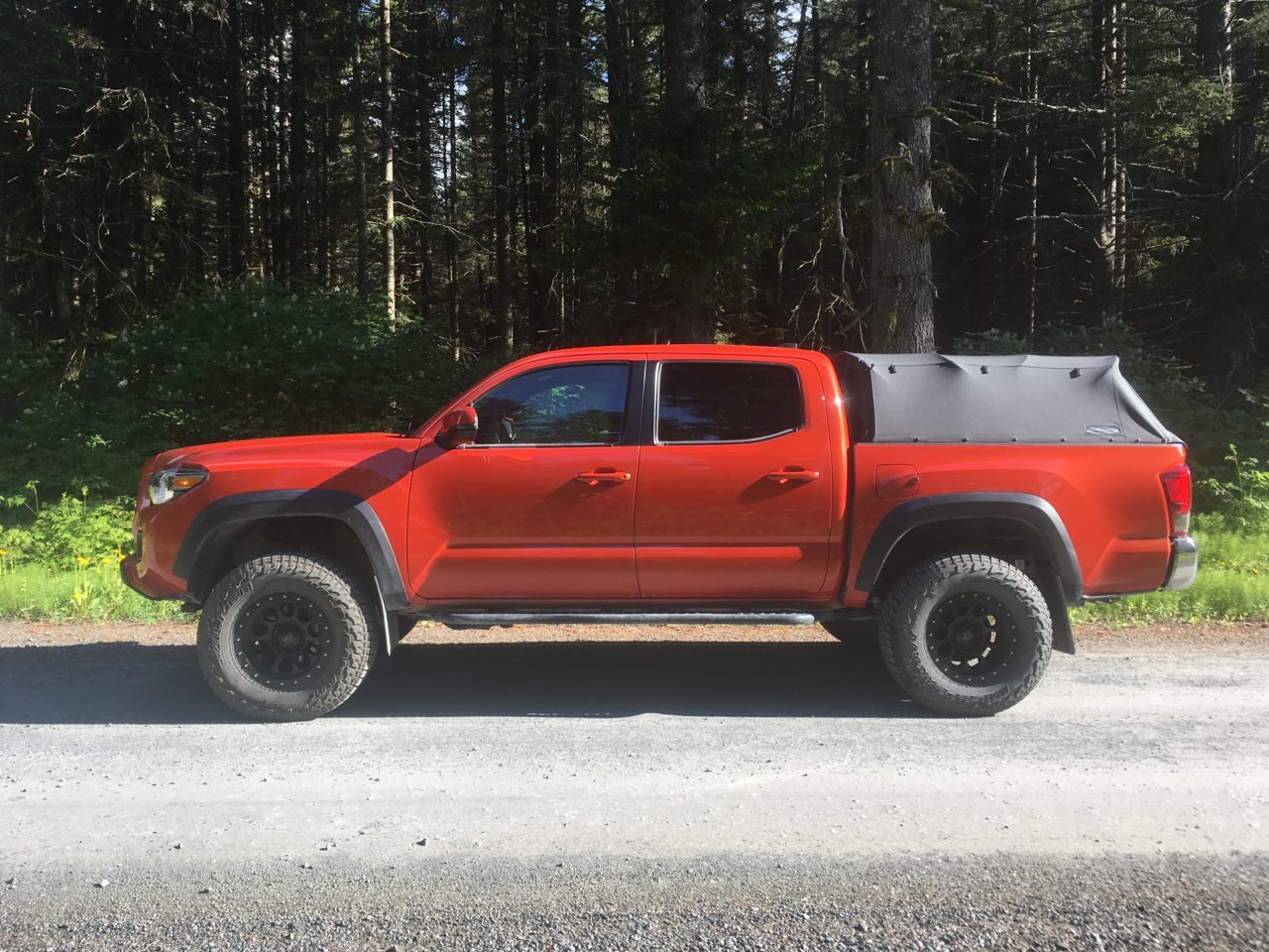

    220 strut with 302 coil. 3leaf aal in rear with OL out.
    23” hub to fender all the way around.

    Timm
    St. Louis, MO
    So. Many. Stickers.
    Gotta say it again, that color .... :drool:

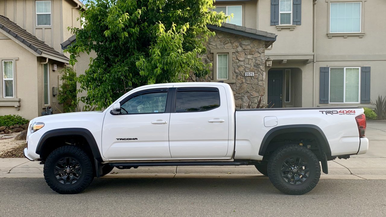

    Dobinson’s shocks currently with C59-300 coils. Gives me about 1.75” lift up front. Having this corrected next week. Shops replacing them with the 354 coils Monday to give me the 3 inch lift upfront I wanted. 110R left packs with a 1 inch block in the rear gives me 2 inches. Dobinson’s UCA. Set at 4.7-4.9 degree of caster ready for some 285/75/17 Nitto Ridge Grapplers in a few months when funds are allowed.

    Wouldn’t the 110r leaf pack+1” block give you 3” of lift in the rear?

    It’s only giving me 2. I’m assuming it’s due to the weight of the LB. my installer recommended this one for now u til I get a camper/diamondback cover and a steel HC bumper and add an AAL just so it wasn’t so stiff.

    @Dobinsons Mike is this the case with the 110r pack? Does the pack yield less lift on the long bed than the short bed trucks? Thanks!

    For my application so far yes. I do have RCI sliders and a Peragon tonneau which is about 60lbs over the bed. From my understanding Dobinson’s did their testing on Hilux’s since they don’t have Tacoma’s in the rest of the world.

    Not that I've seen before, although more weight reduces lift height. I've never seen the 110's not produce 2" of lift, although I think this is the first LB to post photos.
    No, Hilux springs are different, these were tested on Tacomas here in Miami.

    My fault, I went back and checked my front coils they are C59-350s. These were the coils that were designed for the Hilux. I knew I got that name from somewhere.
    As far as the rears go, that’s my assumption too is due to the long bed, it didn’t provide enough lift and the shop installed the block to achieve the lift without using a heavy duty leaf pack.
