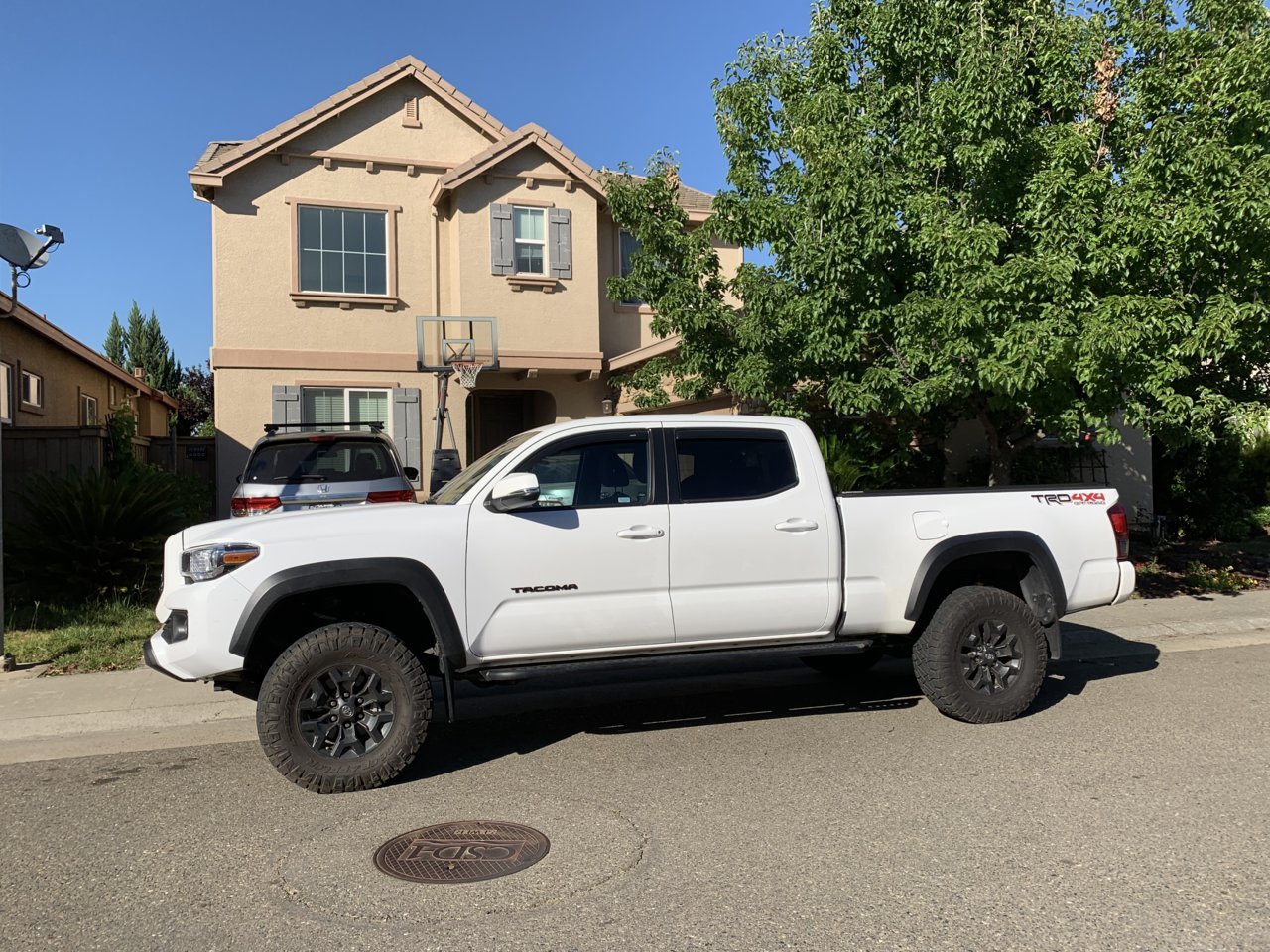

    The whole set up is Dobinson’s including their UCA. AD78ABB3-2FF2-41D0-ABF3-71A6B4309099.jpg

    Did your fronts ever really settle? Any clue what your current height is?
  4. Jun 26, 2019 at 11:20 PM
    #224
    AndyGuy317
    AndyGuy317 Well-Known Member
    Aug 1, 2018
    #261365
    134
    Andrew
    2018 Super White Tacoma TRD OR
    I measured it yesterday, and they haven’t settled. Still sitting around the 2.75 to 2.8 inch mark. Which is what they rate it as. So quite happy with that result. We’ll see once I get a bumper and skids on. Hopefully it’ll still give me the 2.4 inch lift. But we’ll see. It’ll be a while before I can get those.
