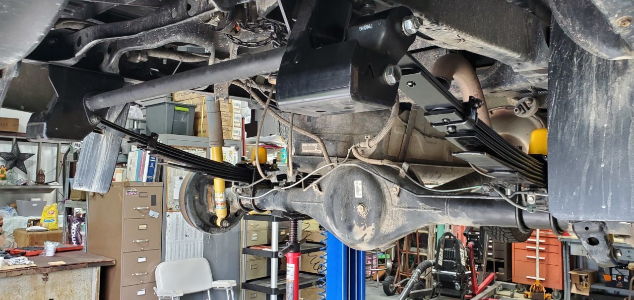

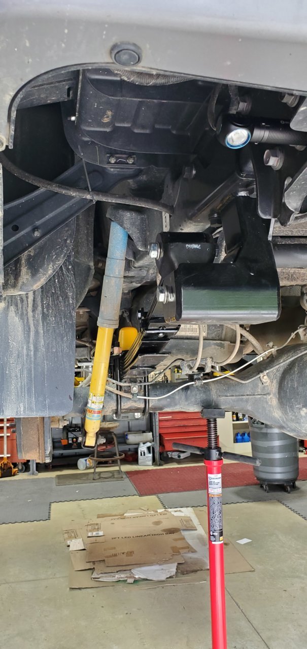

    So most all of my edc (tools, recovery gear, 285/70r17 spare, etc.) items are out in the photos/install.
    Took pre-leaf measurement off the hitch bottom:
    Before 16.25"
    After 19"
    Install of the L59-111-R leafs went pretty smooth. Drilled out the e-brake bracket to mount using the @cubie fix a la the front bracket bolt.20200524_152132.jpgI ended up using some formula 5 poly bushing grease that was at the inlaws, turns out to be some pretty tacky goodness!!! Even saw torture tests using a pressure washer.
    RyanDCLB, Beachdog77, cubie and 3 others like this.
