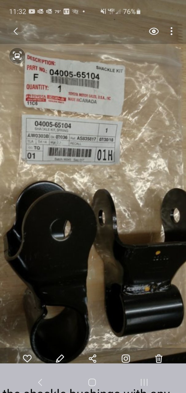

    Far cheaper in time/$ to just buy the OE part, they're like $25 bucks...that's my plan once I decide it's necessary/OE bushing is squeaking/run its usable life.Screenshot_20200529-113255_Gallery.jpg

    Nice! I plan on doing some BAMF or Archive rear spring hangers, so I'll probably go this route!

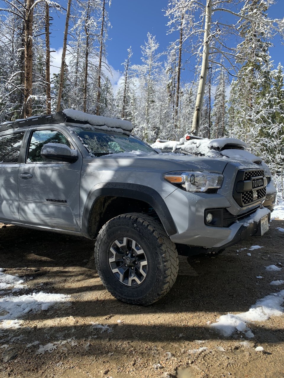

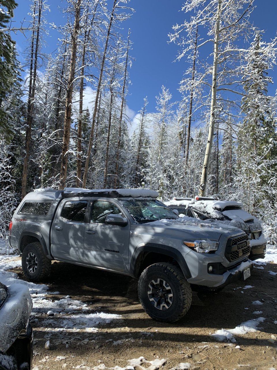

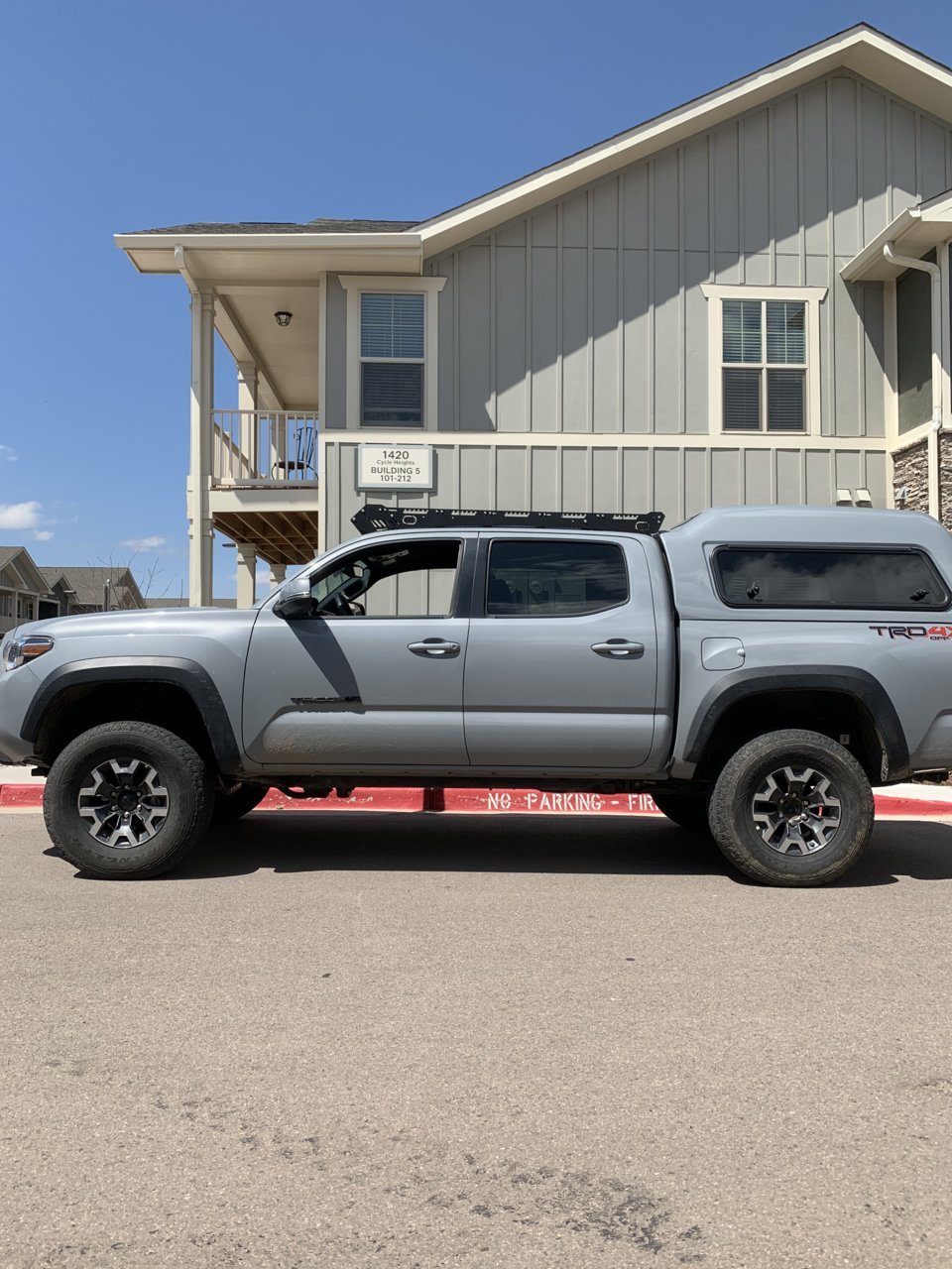

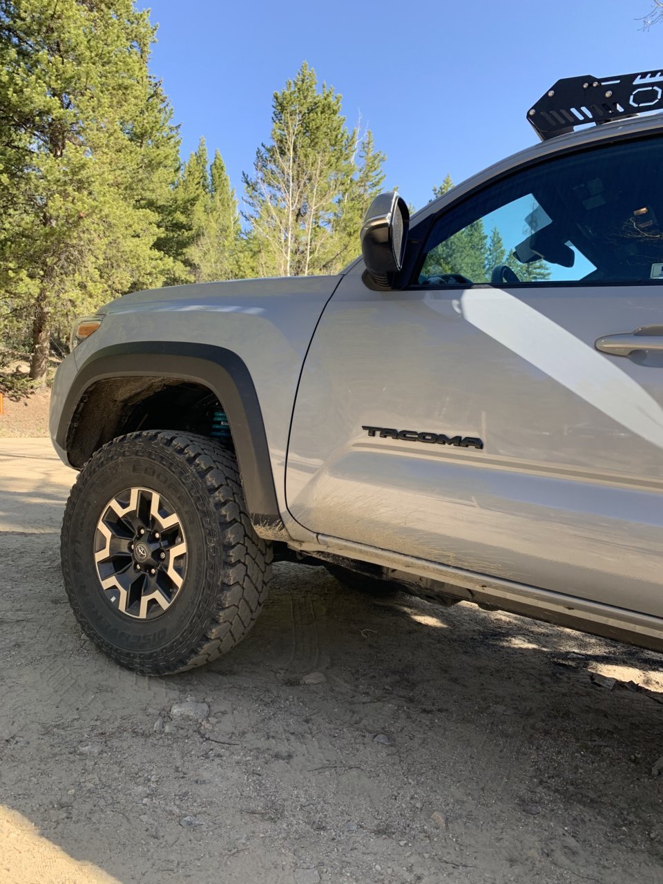

    ~5 weeks into my Dobinsons lift and loving it so far. Nose dive is gone at stoplights, tight body roll around roundabouts, and handled great on a difficult rated trail with some pretty gnarly features.
    2019 DCSB OR
    Only extra weight is a shell @ ~190 lbs and camping gear that never leaves the truck ~ 75lbs?
    C59-302 with GS59-220 struts (2.6" estimated lift by specs)
    110-R leaf springs
    59-940 rear shocks
    Stock UCAs - alignment passed on day of install, and 2 weeks later again.
    Pre vs Post (+ Gain)
    FD
    20.5" 22.75" 2.25"
    FP
    20.5" 23.0 " 2.50"
    RP
    21.0" 22.5 1.5"
    RD
    21.0" 22.0 1.0"
    I have a somewhat uneven load in the back of the truck right now on the drivers side, and a full tank of gas which I am comfortable to attribute to the 1/4" less up front and 1/2" less in the back. Or maybe just shitty pre-measurements who knows I was in a hurry!
    First photo: lifted on stock wheels / tires.
    Currently with 255/85/16 Cooper ST Maxx on stock OR wheels
    Gained 2.75" up front before settling, now at 2.5" as desired
    Gained 2.5" in the rear before settling and I think now it's at 2.25 but I'd have to do measurements again to be sure. Overall slight rake which is perfect and what I wanted. If you're hesitating on this lift it's 100% worth it and @Crikeymike is always a DM away was very helpful.

    no airbags. even when I sit on the tailgate, the compression of the springs has significantly less sag than stock. It was the first thing my buddy noticed when he sat on the tailgate. Nice and firm, hard to say what the rake would be like without the camper shell but im right in the ballpark of the weight rating for the 110 springs.
