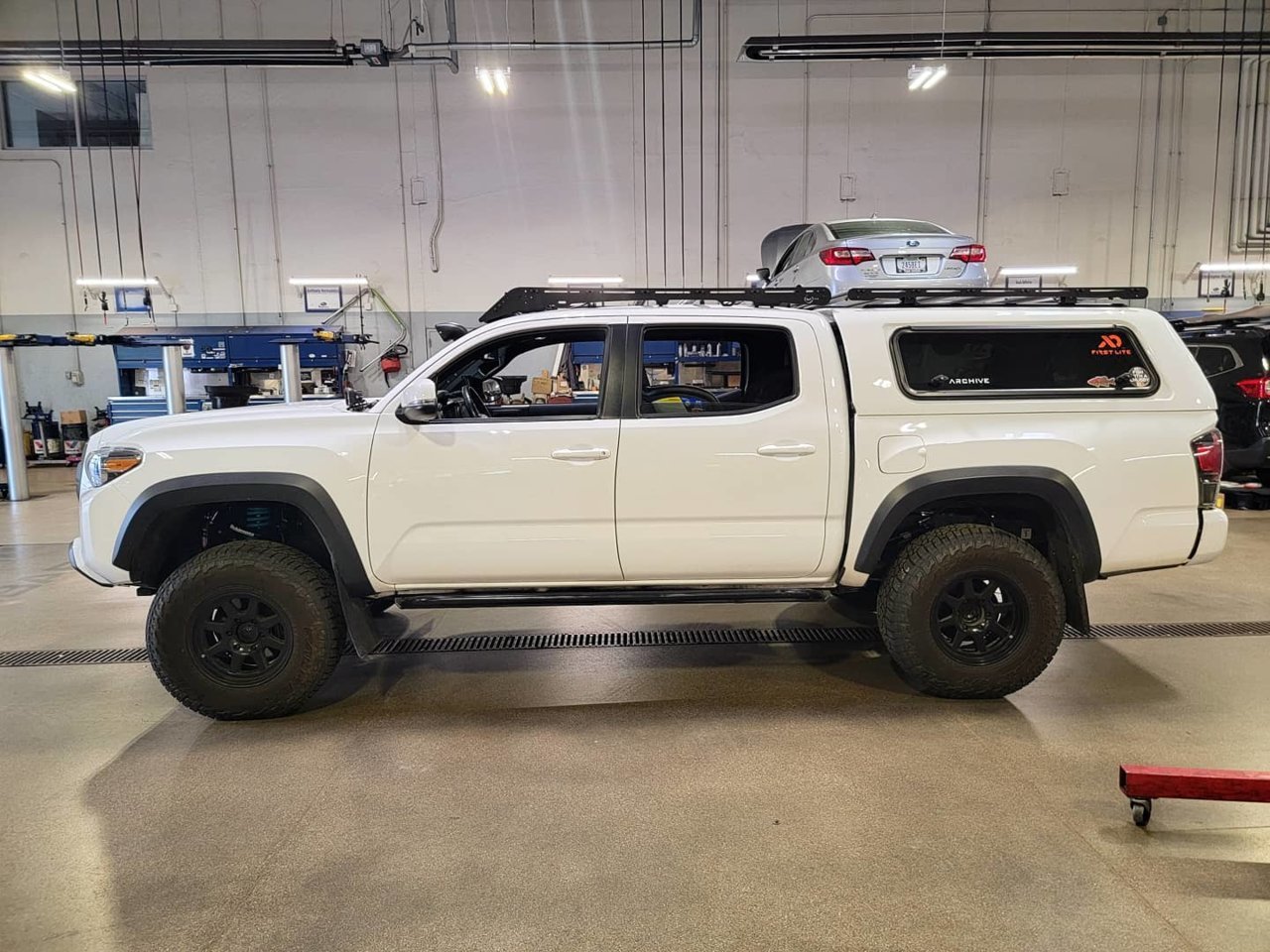

    Got my rear packs today, but can't find where it was posted about which leaf to remove on the 111 to make it a 110.

    There are 2 leaves the same from memory with no clamps attached to them. 4th leaf down from the top I think. One of those come out

    @Crikeymike @RyanDCLB my fourth one has the brackets attached to it, maybe the third one down??

    Better post a pic of your springs. My 111’s have the top 3 leaves bracketed together the 4th is free

    Didn't get a pic today before I installed the leaf pack , just ripped out the third and slapped them. Road fine and was at 37inch ground to fender. Maybe assembes wrong at factory? Idk. The front settled by the time I got home.IMG_20210625_204732_059.jpg

    Got time to align my truck on Saturday. Had 4.5 degrees caster and zeroed out the rest. Measured 37ish inches on all four corners ground to fender. After thinking about the install it may help dobinsons to make specific instructions for install. All the extra hardware could be eliminated to save money and save time on a confused end user or installer. Found a spot at work for a flex test, and I think it still has some droop left. With recommended settings truck drives great. Now to find time, a babysitter, and get outta town.
