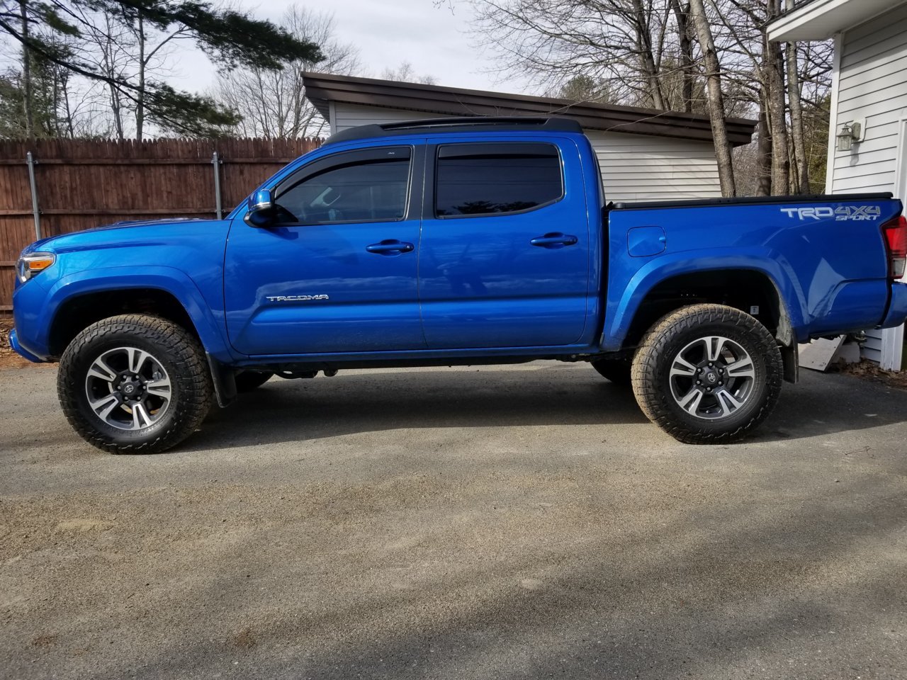

    Depends on your application. The stiff sport suspensions are great for technical tarmac and for trailering. The softer OR feel is good for .. well, off roading. But you already knew this :)

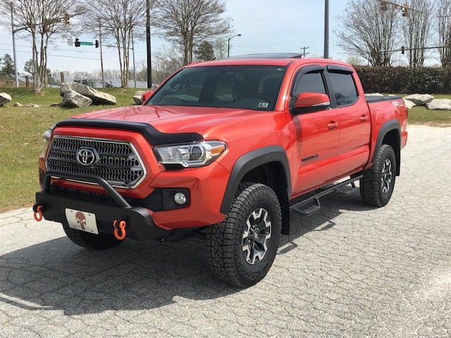

    Thanks Dobinsons Mike
    Just finished up my install on my lift kit
