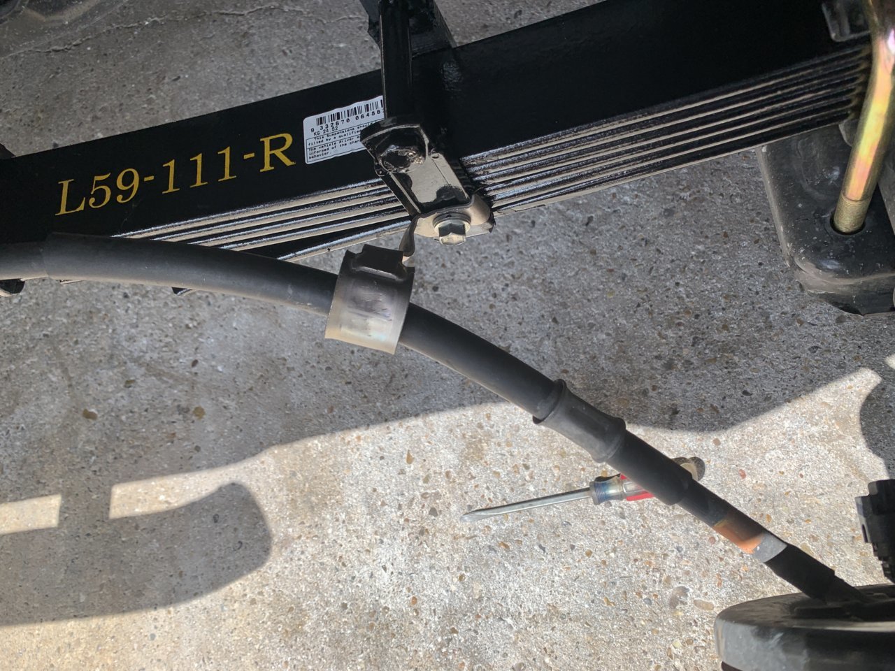

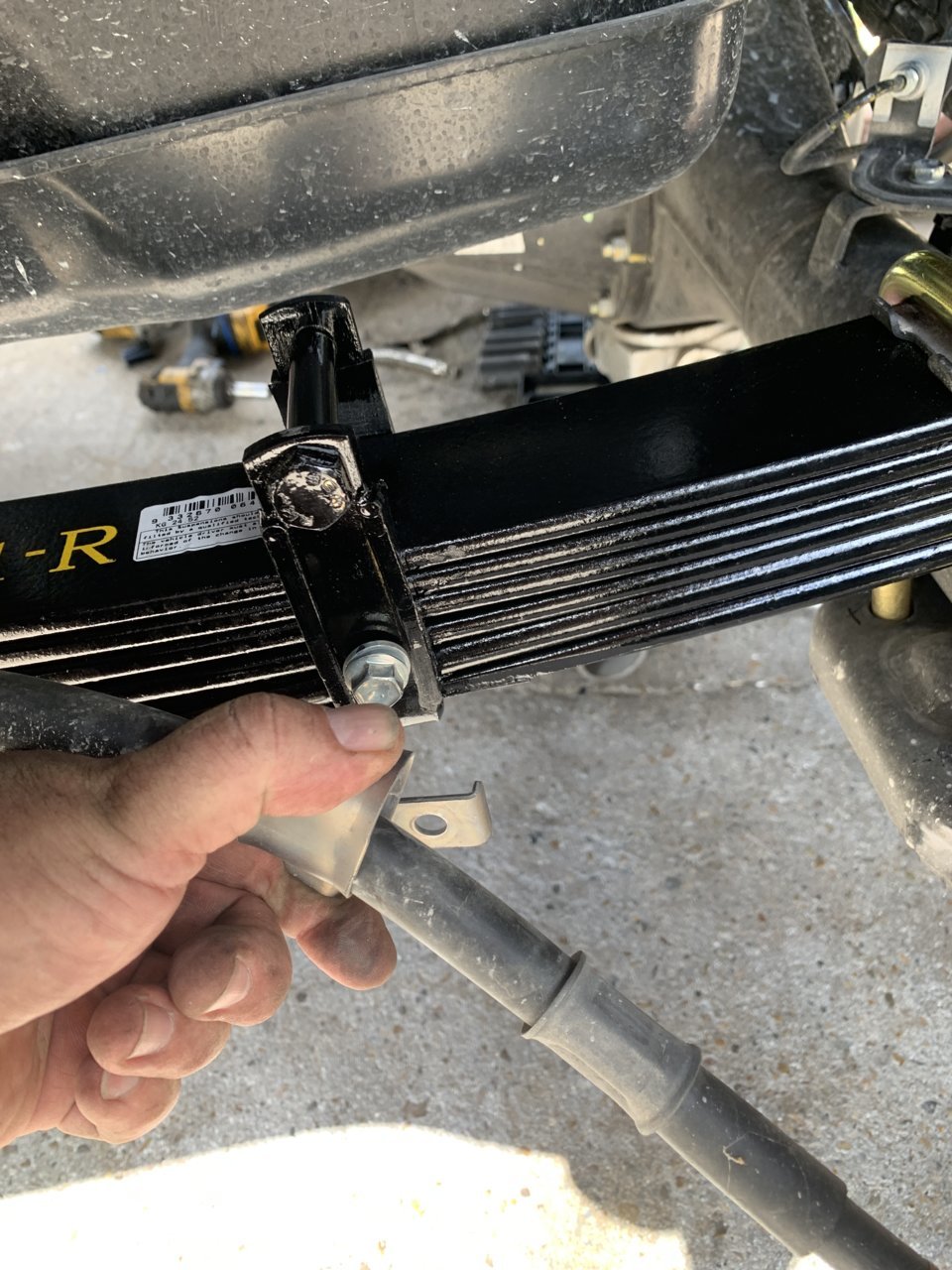

    Got mine all installed over the weekend. Jmscheider1983 has a lot of good information here that I found helpful. If I were going to do it over again knowing what I learned from this install I would do it a little differently.
    - Forget the greasable bolts. They are too long. I ended up only using 2 on the end without the shackle where there is plenty of room. I also chose not to replace the lower shackle bushings.
    - You will need to modify the bracket that holds the brake line that runs along the leaf springs. If not it is super tight and looks like it will fail in some capacity very soon. Just move it to where it will attach and then once you do attach it get some channel locks and bend it where it relieves the pressure from pulling and stretching the line. I also squeezed it to where the line wasn't getting cut into by the edge of the bracket.
    - UCA'S I would consider not changing them and seeing how the truck rides first before ordering them. Too much of a pain. We cut, bent, pryed and beat each of the 2 bolts out. The passenger side required the trimming. On the drivers side the bolt head gets stuck every step of the way against the ribs underneath where the battery sits. There is also a big wire loom in the way. Neither side was as easy just grabbing some channel locks and and bending some metal out of the way.
