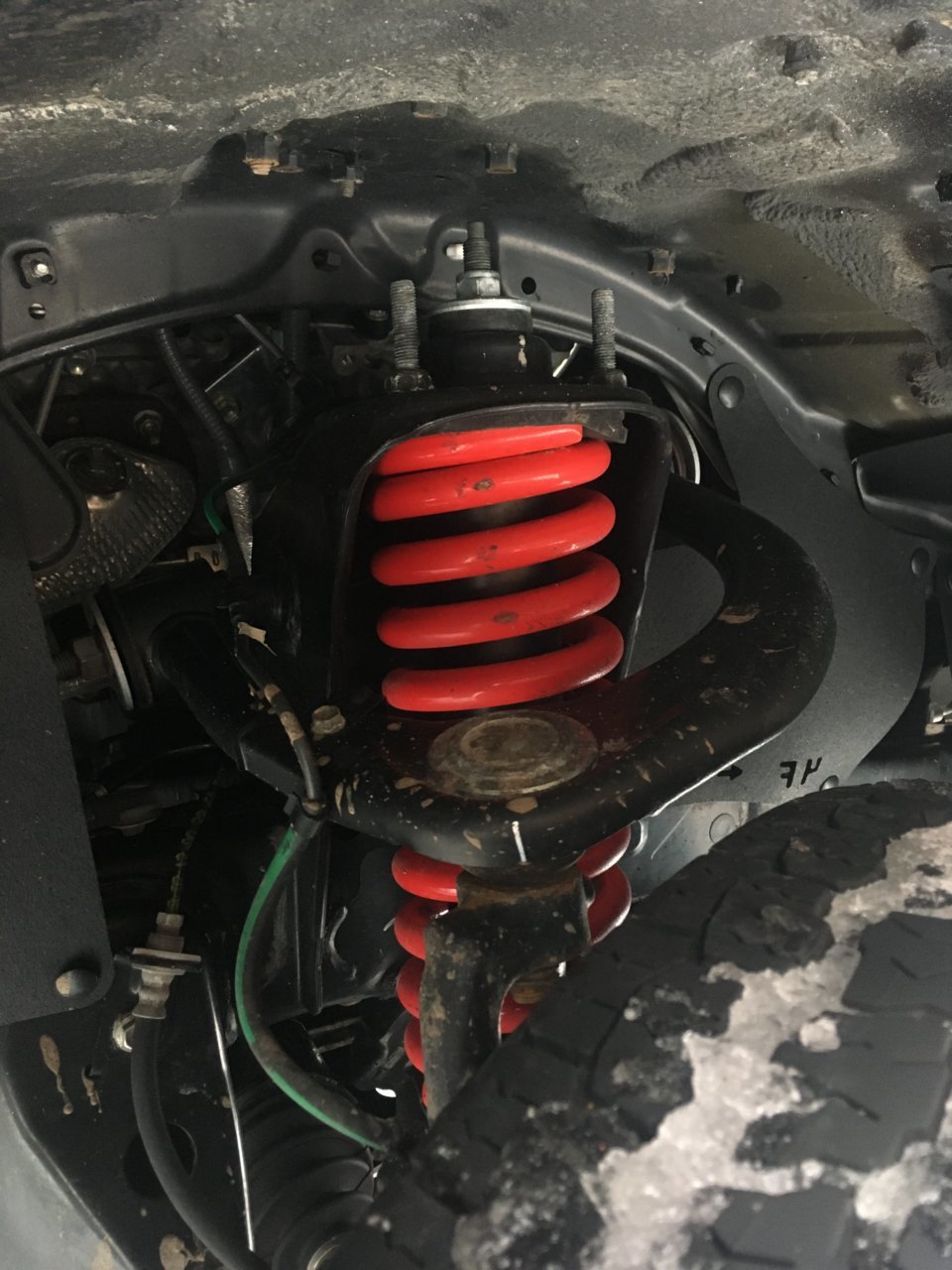

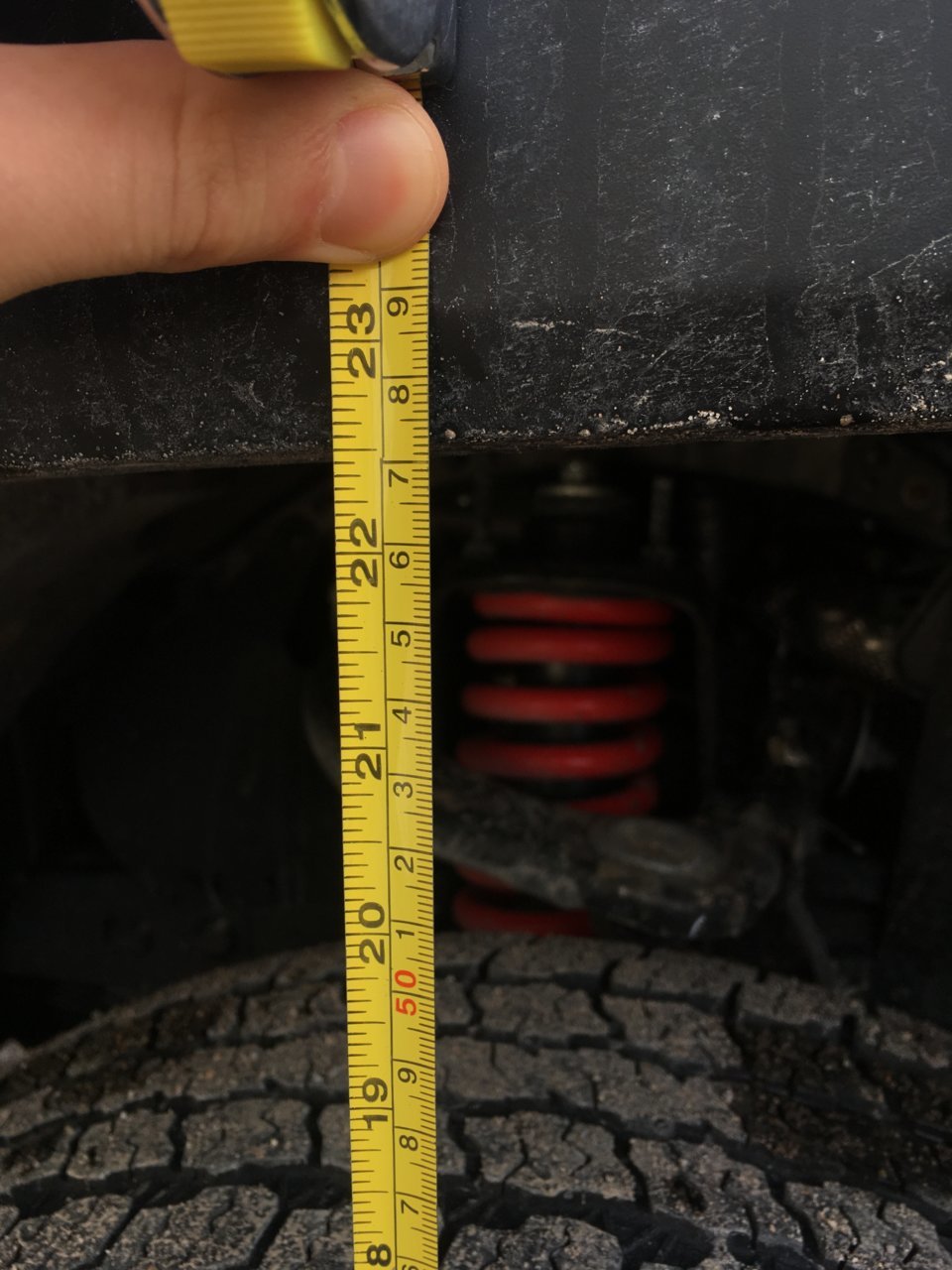

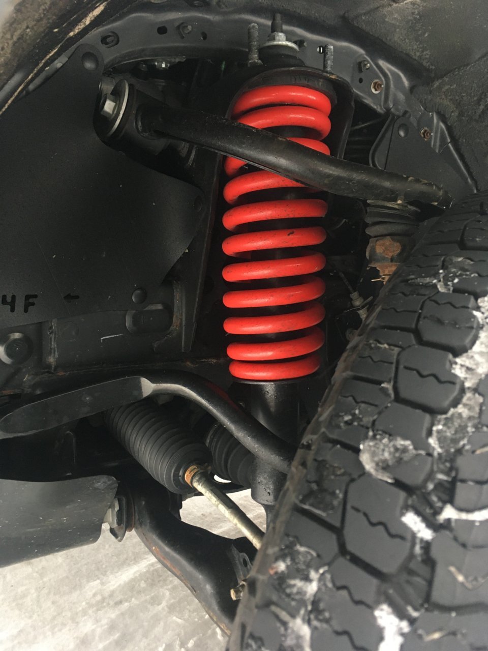

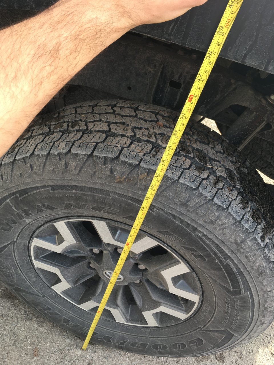

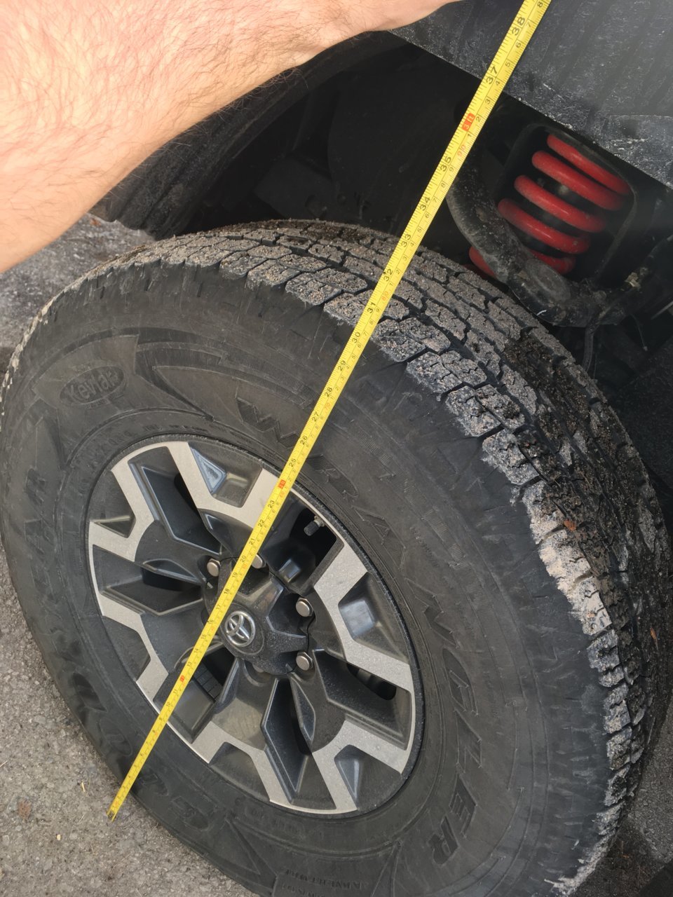

    Taquitoma
    Taquitoma Well-Known Member
    Mar 6, 2018
    #246466
    171
    2017 OR DCSB M/T

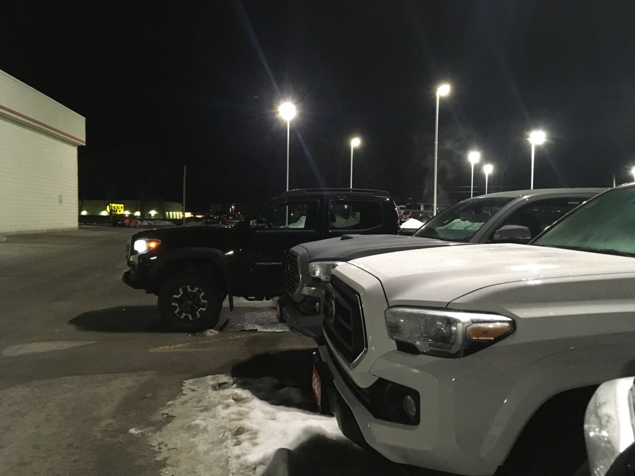

    Lucky you, that was the height I was after! The 302 springs with the 220 coils should be giving me the same numbers up front...
    For the rear, I had a thought that maybe it was my MX4 tonneau pulling me down (even though the springs are recommended for 100lbs constant load), so I took it off and gained a whole 1/16th in...at least you can add some more accessories up front to bring it down, there's not much more I can do to bring it up short of adding spacers. :annoyed:
    And yeah I took both measurements, they show the same results as my wheel/tire setup is still identical. Before install I had 21in hub to to fender up front, 23.5in after. And now after a week 22.5in...
    Here's some showing ground to fender driver's side...front is at 36.75in, rear at 37.75in:
    Just to double check my before numbers, I made a stop at the dealership last night and measured the 4 ORs they had on the lot (Yeah I was that guy crouching in the dark between tacomas with a measuring tape). All four were at 35.25in ground to fender up front, and 36.5in in the rear.
    That feeling when you drop $1500 on a suspension but still blend in with the stock Tacomas...
