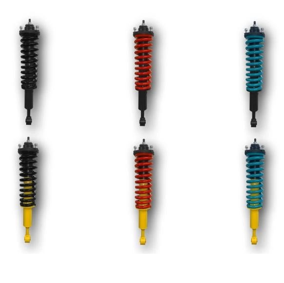

    Here's a good example of the different color combinations of teal, black or red coils with the yellow or black struts.

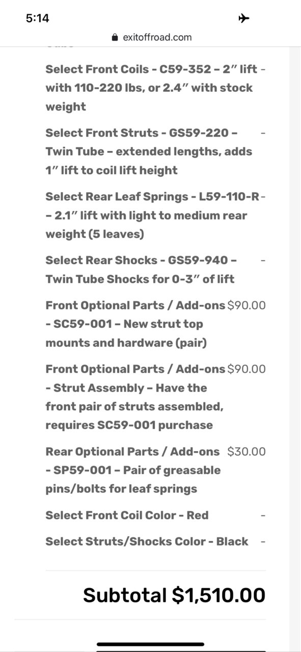

    This has gotten me very interested, was just about to pull the trigger on a Old Man EMU kit and started seeing the horror stories with the newer generation of leaf packs.
    Just trying to figure out what’s best for me. It’s a 2017 TRD OR dcsb with tired suspension (71k) I’ll be running 285s with 16x8 0 offset wheels. Truck is pretty loaded during the summer months with a mid height rack and a rtt in the summer. Trips will be loaded with camping gear.
    This is what I put together. Not sure if I need to go a little heavier on the leaf or not. A leveled ride when loaded and a rake when unloaded I don’t mind.
    Any inputs?

    Hey man. Yeah, here's a good option for you without the drama of noises in some other brands.
    Do you have a front bumper or winch? Otherwise those front coils would be too much for you. The C59-314 with GS59-220's are pretty popular on the newer taco's for 3" front lift, and add some UCA's for the best wheel alignment and driving in the front. You don't need Dobinsons UCA's necessarily, but you will need UCA's for a 3" front lift.
    I would suggest the L59-111-R rear leaf springs, the next step up from what you selected, due to the projected weight. If it stays empty most of the year though, you could always remove a leaf for less lift and load support for when you don't need it.
