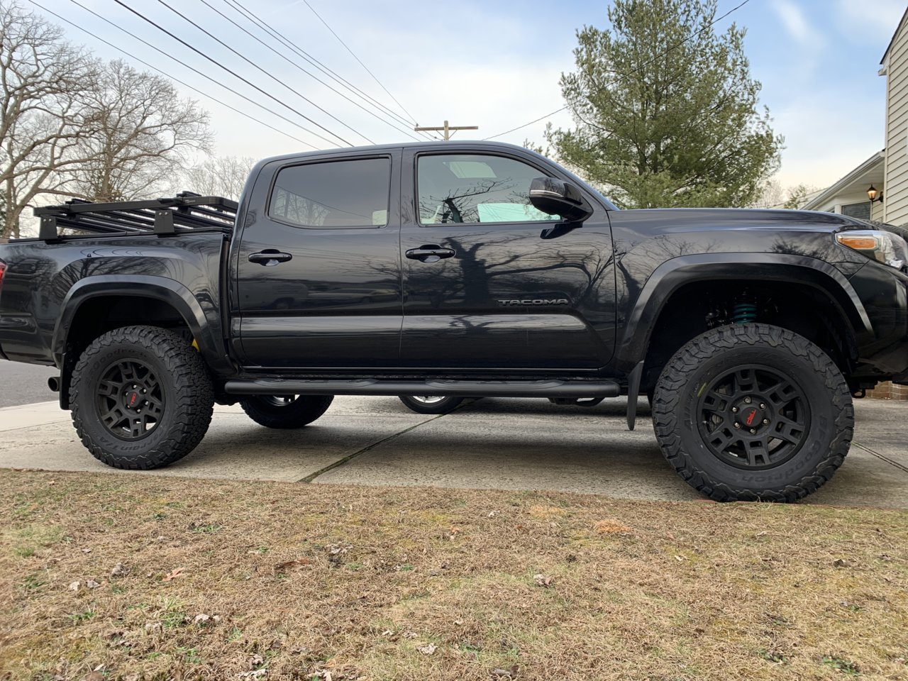

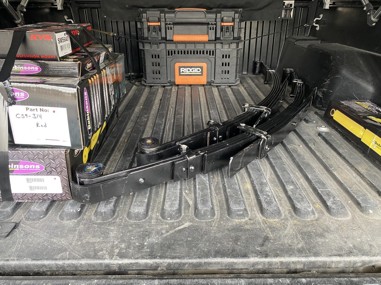

    Just added the dobinson 220 with 314 spring and 1/4 inch spacers each side also had Dakar med leafs installed

    Nice! How much lift over stock did you get in the front?

    I was going for 3 but actually don’t know. From what I read 220 with 314 springs would give about 2 3/4 -3. But settle to about 2 1/2. Adding the 1/4 spacer from head strong gave me a guaranteed 1/2 lift in addition to the possible 2 1/2 lift after settling. If I get that’s ok. I also added spc ucas. The ecgs bushing was installed also and diff drop and carrier bearing spacer added. I had them install 285/70/17 ko2 there no rubbing at all
    @cubie hope it answers some questions
