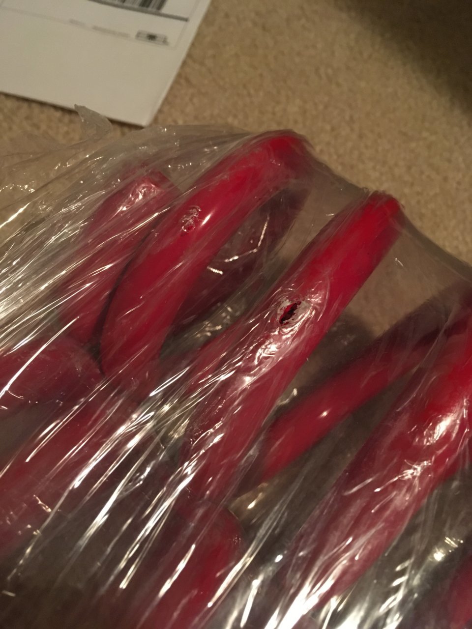

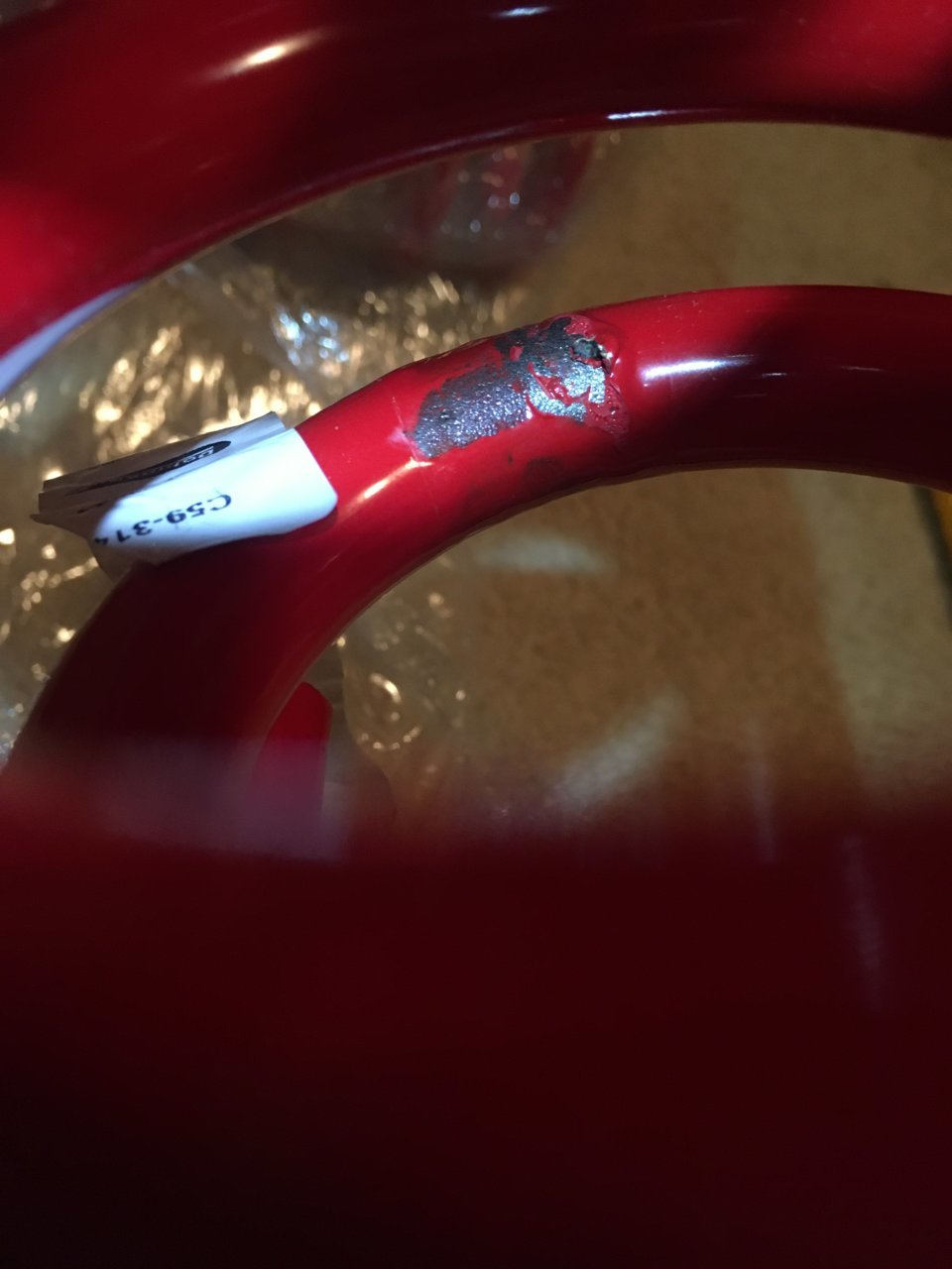

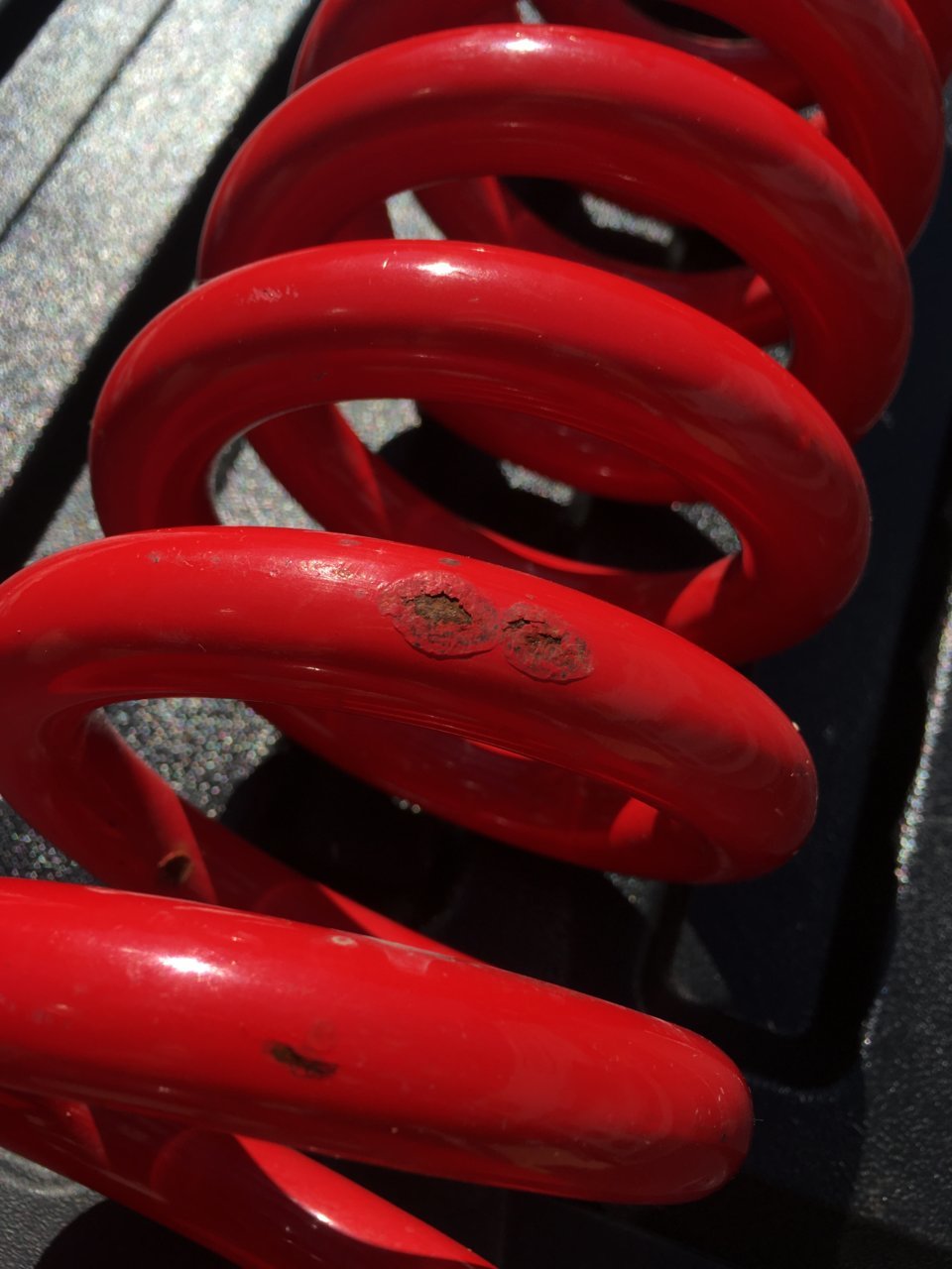

    Taquitoma
    Taquitoma Well-Known Member
    Mar 6, 2018
    #246466
    171
    2017 OR DCSB M/T

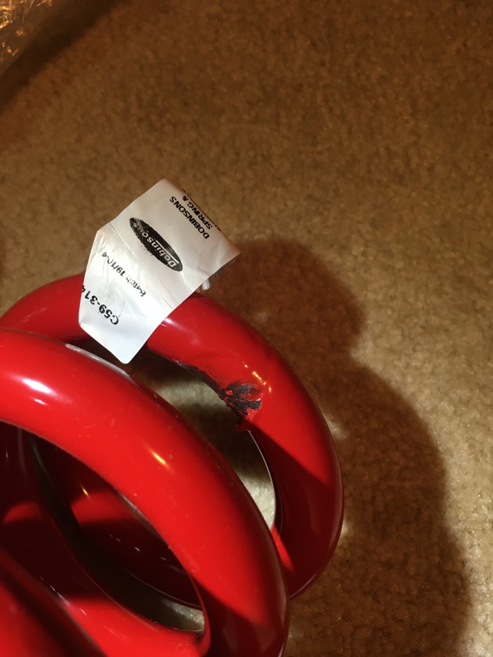

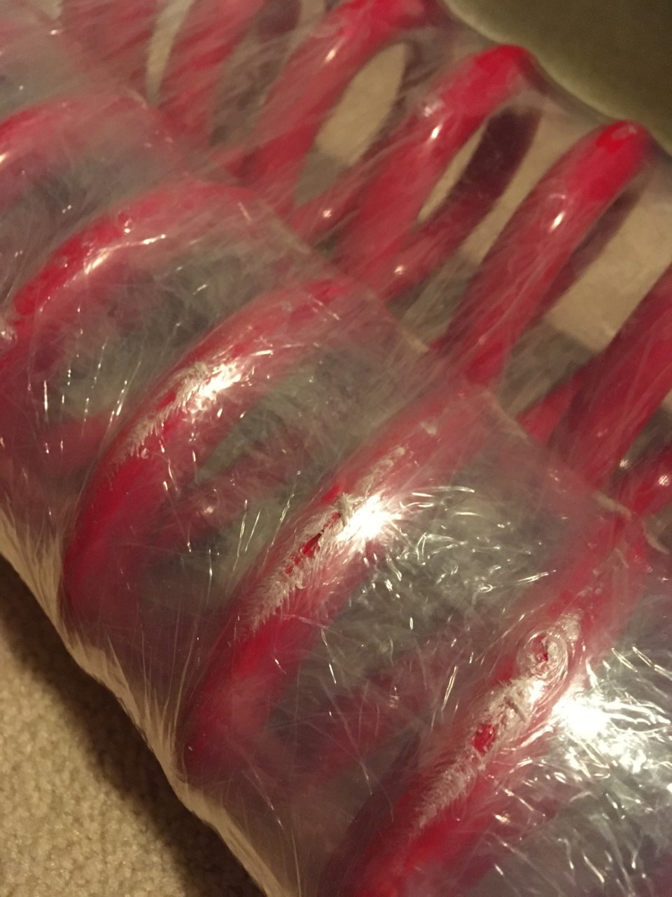

    Well I just took apart my suspension to swap from 302 to 314 coils, and as expected after two months out east in the salt, any bit of exposed metal had developed rust on it. On the shocks, these were just little knicks/scratches from the install, however, the coils come with pretty decent sized chips/knicks out of the box (they should use more padding inside the box IMO), as well as a big unpainted spot on the end. My guess is that's where they hang the coils from while they're being powder coated, but instead of touching up this spot after, they just slap a sticker around it. I would highly suggest a couple of coats of paint on these spots before installing otherwise your coils will be brown before you know it.
    Here's how the coils arrive. Note the abrasion through the ceran wrap, and the unpainted spot under the sticker.
    Here's what you can expect if you don't touch up those spots. (302 coils after 2 months)
    After learning my lesson, here are the 314 coils ready for install with a couple coats of spray paint on areas in need.
