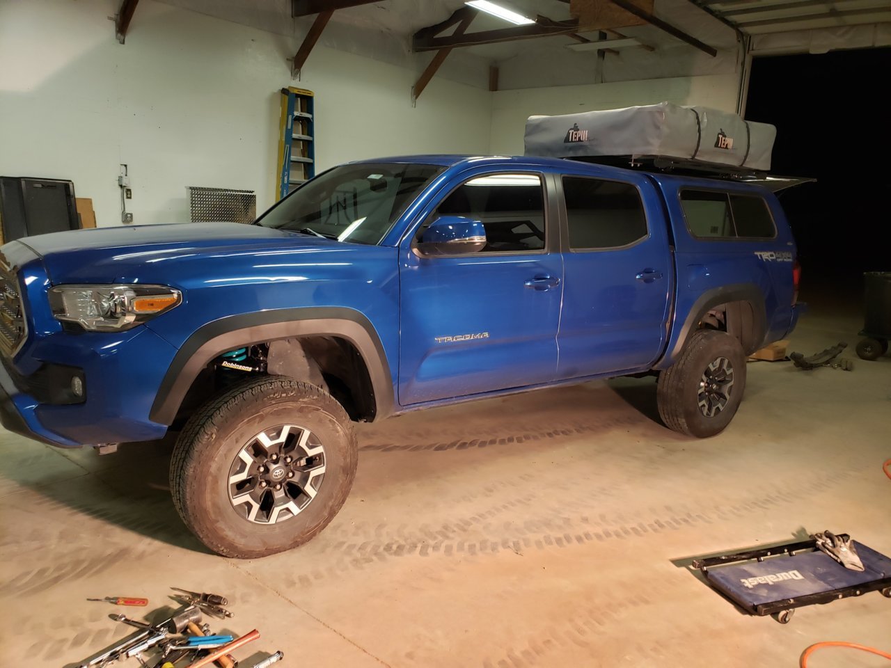

    Looking at doing a Dobinson lift after being introduced to the brand by my 4x4 shop, especially after reading the large majority of positive comments seems like a step up from 5100’s. Based on everyone’s experience want to make sure I’m on the right track parts wise for my build.
    My goal is to achieve 2-2.5” leveled lift, stock UCA’s on 275/70/17 with a 0 offset 4.75 backspace wheel. Truck will have a bedrack and RTT mounted in the summer, no weight in winter. Don’t plan on having aftermarket bumpers or wench.
    I am looking at installing the 314 coils paired with 221 struts in front, the rear will have the 941’s with a AAL. (Thinking this will better support weight over the block but stay budget friendly, but open to comment)
    Thoughts? Any concerns I should have with alignment, rubbing, leveling or other?

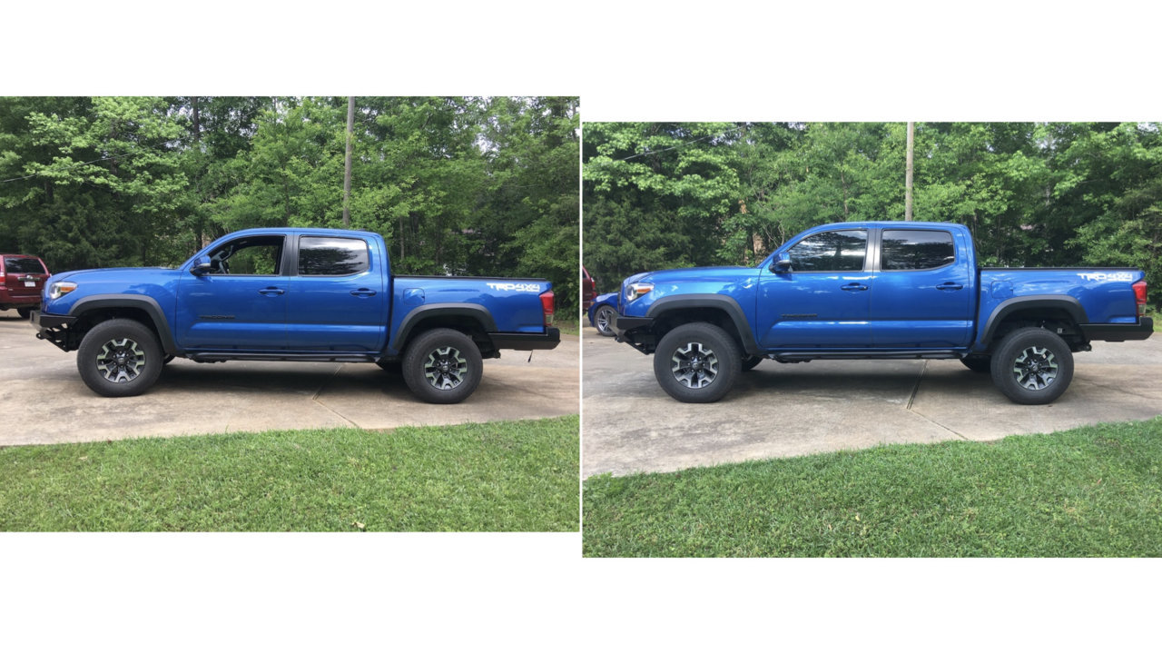

    I installed the Dobinsons kit and really like the look and the ride is so much better. Nose dive when braking is gone. Handles bumps and dips on the road much nicer. Even my wife is impressed and said the truck rides better now than before!
    Here is what I used.
    Dobinsons kit:
    C59-352 Coil springs
    GS59-221 front shocks
    L59-110-R leaf springs
    GS59-940 rear shocks
    Top mount spacer ¼ inch for taco lean
    Truck has:
    210 lbs front (winch & bumper, don’t know what the crap I took off weighed)
    Also RCI front skid (don't know the weight)
    125 lbs rear bumper (again, don’t know what the OEM rear bumper with receiver weighed)
    After putting on the bumpers and winch.
    Front down 1/2 inch
    Rear down 3/8 inch
    Difference from bumpers and winch to bumpers, winch, and lift
    Front up 2 inches (no taco lean thanks to the spacer)
    Rear up 1 3/4 inches
    The difference between the left and right side rear is less now than before the springs. Left used to be 7/8 lower than right and now only 1/2 lower than right side. I guess these springs handle the gas tank weight better. Gas amount is pretty much the same since I haven't driven anywhere with the stay at home order in Louisiana.
    Thanks @Crikeymike for all the information. If you need anything Mike is the guy to talk to.
    Also, thanks to @cubie for posting about the emergency brake hoop. I drilled out the hole in the hoops and attached them to the front leaf spring brackets. Works like a charm. (@Crikeymike told me about this and sent me a link to @cubie post, thanks Mike.)
    Here is before and after. I tried to line the wheels up for the comparison.
