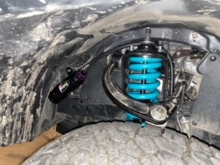

    Measurements, all taken center hub to fender....
    Pre vs Post (+ Gain)
    FD 20.5" 22.75" 2.25"
    FP 20.5" 23.0 " 2.50"
    RP 21.0" 22.5 1.5"
    RD 21.0" 22.0 1.0"
    I have a somewhat uneven load in the back of the truck right now on the drivers side, and a full tank of gas which I am comfortable to attribute to the 1/4" less up front and 1/2" less in the back.
    Crazy that you got that much settling... self install or a shop? Did you do strut assembly yourself?
