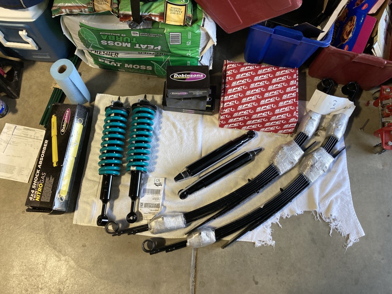

    This just in! Just picked up my lift from RSG Offroad in CO. Great guys over there, they were very helpful and I felt like I was surrounded by people as excited about my truck as I am. Justen from RSG helped me out.
    Front: 221 struts with 314 coils
    Rear: 112r leaf springs.
    UCA: SPC
    They recommended a diff drop, which I already had. I went with the driver side 1/4” strut top spacer because my drawers and tools are also more loaded on the driver side.
    I don’t have any extra weight up front (besides a supercharger I suppose) so I went with the 314s so the ride would not be too stiff and I actually get proper articulation off road. Had originally planned to go beefier but the guys at RSG convinced me I would lose more than I would gain going with the 220s or the 352s without weight. If I need extra ride height I can always throw on a set of strut spacers to hold me over till I get a bumper.
    For the rear I have around 700lbs constant load with a roof rack, topper, and a wood drawer system that stays fully loaded in the summer, plus a load of tools behind the back seats. I figured I can always take a leaf out if it’s too stiff at 700lbs on the 112s.
    I’ll be installing in the next few weeks and will post some before and after shots after I’ve driven it a month or two. Disclaimer on the before and after shots, I bought my truck from a previous owner with 3” spacers up front so I expect to break even or even lose a half an inch with this setup. My truck is at 65,000 on original suspension and has been riding with around 700lbs in the rear all year so my struts and rear shocks are shot and have been leaking for a month or so. The rear leafs are pretty much flat and even have some negative arch in the rear. So this before and after won’t be for those of you looking for the difference from stock to lifted.
    Gonna be my first time installing a suspension so I’ll comment on that aspect too afterward

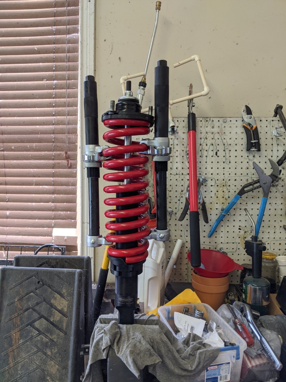

    After lowering the seat height down to 213mm and logging 450-500 miles on it I am sitting right at 2.5" of lift. That's with the 314 coils and all stock weight up front. The ride has been really nice since dropping the extra preload off the springs. On a side note, for those looking for a quality diy spring compressor the ones from SPC are well worth the money at ~$125 online. I used them to make the adjustments and they felt every bit as safe as my buddies Branick that I used to assemble them with. You do have to hold your mouth right to get them in there but once they're attached they work really well. Now I just need to get her on the trail, and I can't wait to get some 5.29s in the diffs...

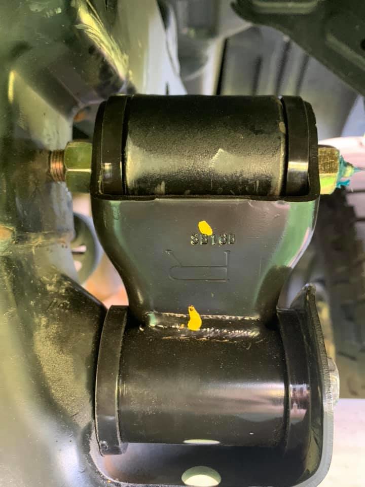

    I installed my Dobinsons L59-111-R Leaf packs. Very happy with the height and the ride quality. Superb. Far better than my single add a leaf with the stock leaf pack. Also, the height has been returned to where it was before I installed the topper and rack, plus I feel the setup will support the weight of my boat when trailering better.
    I ordered new shackles, U-bolts, bushings and the geaseable bolt kits along with my leafs but it seems the passengers side grease bolt is contacting the mount and its making a hell of a squeak when the suspension flexes. Did I do something wrong on installation that caused this? Drivers side has about 3/16" of clearance but the pass side bumps right up to the mount when torqued to spec.

    I ended up having to cut the excess part of the bolt off with a sawzall. Mine was rubbing the hanger as well.

    Same, only I used an angle grinder to shorten.

    I also hit the rubbed off part with spray paint so it wouldn’t rust.

    I had this situation too. We ended up getting in there, and cut the bolt end with a sawzall tool while it was still installed. Not the cleanest fix, but it worked. :thumbsup:
