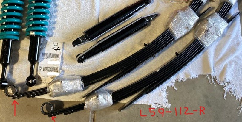

    Dobinsons is working on it. The 2nd leaf will be tapered in and more narrow so that it clears the shackle more

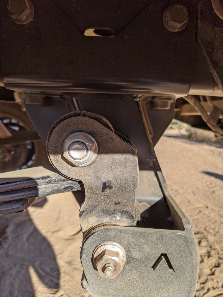

    Contact happens during articulating as leaf slides outboard, and binding can occur if 2nd leaf emerges from shackle and slides outboard, then jams into shackle rib.
    Yeah, for 112s that are out there, the way to eliminate interference is trim as minimally as possible. Best to just clear the shackle ribs so it can't happen. So we're talking 1 or 1.5", definitely not more than 2". And I suggest you check with Dobinsons
    I've conferred with a customer who has the 112s and Hammer hangers + Archive 3.6" shackles, this is his installed pic and the clean spot on shackles is how far leaf extends inside. (110s and 111s do not have this issue)
    Of course this is of interest to me because I offer Hammer hangers and don't want my customers to have interference due to springs, causing damage to my gear.
    Disclaimer: the info in this post is shared as ideas only, you may or may not decide to use, at your own risk or voiding of any warranty.
    @Crikeymike glad they took criticism and are resolving, nicely designed springs and I can keep recommending them

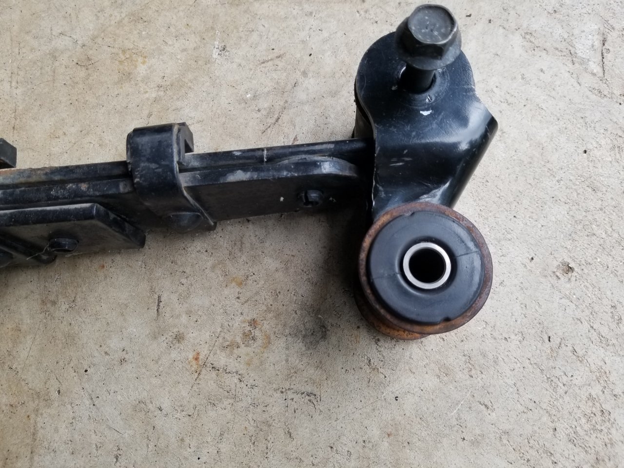

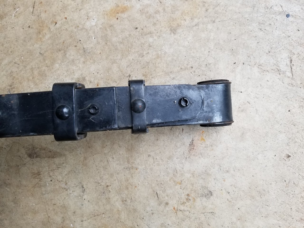

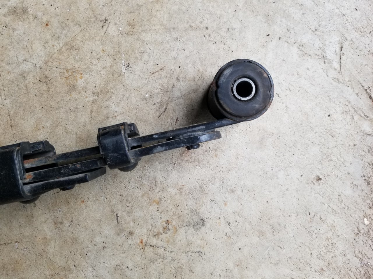

    @CBrob
    Here's pics of a stock 3/1 leaf pack, this is about all it can be without having shackle contact for Tacoma arrangement
