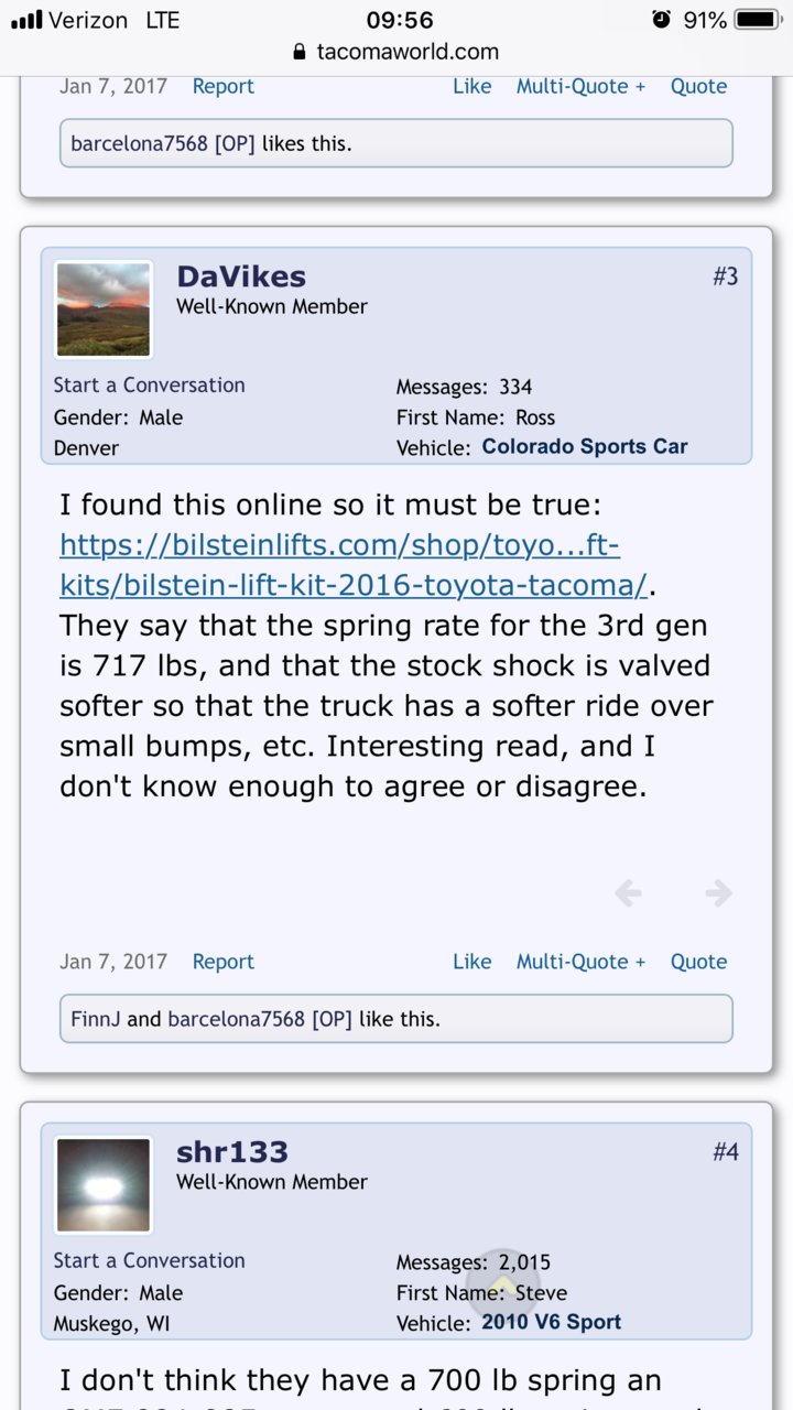

    I read the measure spring rate was 713# on the TRD OR, but I would have to dig up the thread

    Works for me when I click on it. Here is a screenshot of the third post :hattip:

    Ya the post is there but the resource is not, dead link, error 404 to the bilstein site.

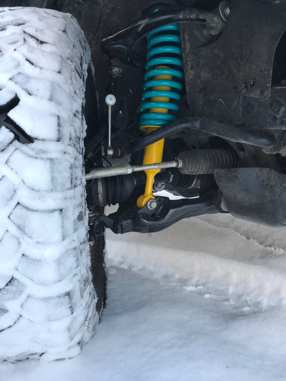

    I swapped out my OME medium kit for a Dobinsons 2" kit and loved it. The Nitrocharger sports are known to be very firm even though they are pretty much bullet proof. The dobinsons struts are valved a bit softer but still provide the improvement in ride quality everyone is looking for when choosing a quality aftermarket suspension system. I also like that Dobinsons offers two different struts for the Tacoma which allow you to get even more lift if that's what you're looking for. Dobinsons has blown up in the 4runner GX world and Im sure its just a matter of time before it makes its way here.
    Crikeymike[OP] and Taco Caliente like this.
