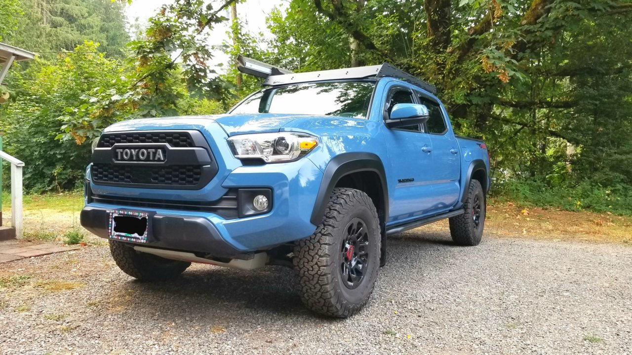

    I would really like to do a 2" lift front and back. I off-road and overland often. Truck is also my daily driver and doesn't always have weight in the bed. No aftermarket metal bumpers, but see them in the future, but not for a couple years. What all should I get?

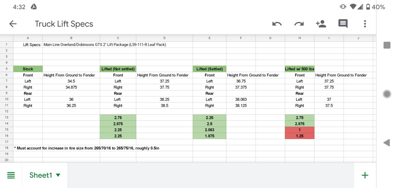

    Is the rated constant load on leafs the amount of weight the truck can handle before sagging? I have 111Rs and have been driving around with an empty bed (rough ride), just threw 500lbs of sand in the back and it rides much better. But while doing this lost 1in in the back. Is this normal?

    The more weight added to a spring, the more it squats. Yes, that's normal.
    How high were you when it was empty, without the weight? You would have been lifted more than the specs list, probably closer to 3".
    2.1" of lift with the listed additional weight on a double cab short bed is what they're rated to give.

    According to my measurements (photo), I was around 2" in the rear after everything settled with an empty bed. Now loaded down I'm only an inch or so over stock height... Something just isn't adding up or I'm missing something.

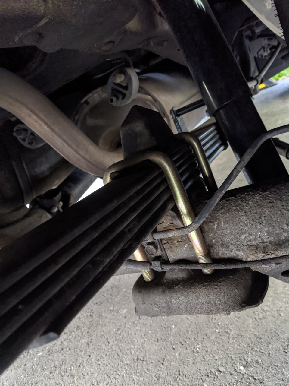

    My leaf packs only have 5 leafs... If that changes anything. Thought the 111s had 6?

    My 111’s have 6

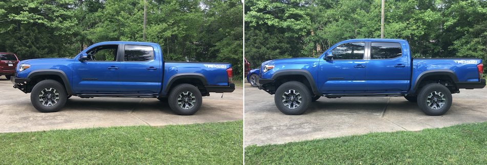

    I have the same set-up as what you ordered except the front coils. I have a front metal bumper and winch, so stronger coils. But you can see what the back looks like before and after the suspension change. I have a high clearance rear bumper also, but no other weight. Again, if you have any questions, ask @Crikeymike. He is extremely helpful and a great guy!
