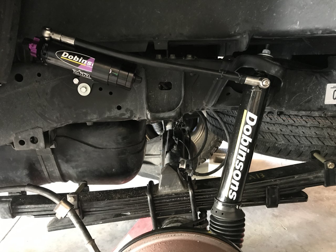

    You didn’t say what kit or parts you ordered so not sure if you’ll have brake line issues. I’m guessing not so much. I got Dobinsons MRA struts/shocks on last week. The one major thing I can tell you is this: there are no parts lists or instructions included. Finding any is a challenge. Adding to that is other parts, bolts, pieces that might apply to another setup like a 4Runner etc. Calling Dobinsons was my best bet. I got to several points in my install where I was like ummm what are these five different bolts, washers and lock washers for? Oh those are for a Camry mount. Ohhhh! Also see if you can find someone on here that has what ever kit you ordered to save you some time and share some pics etc.

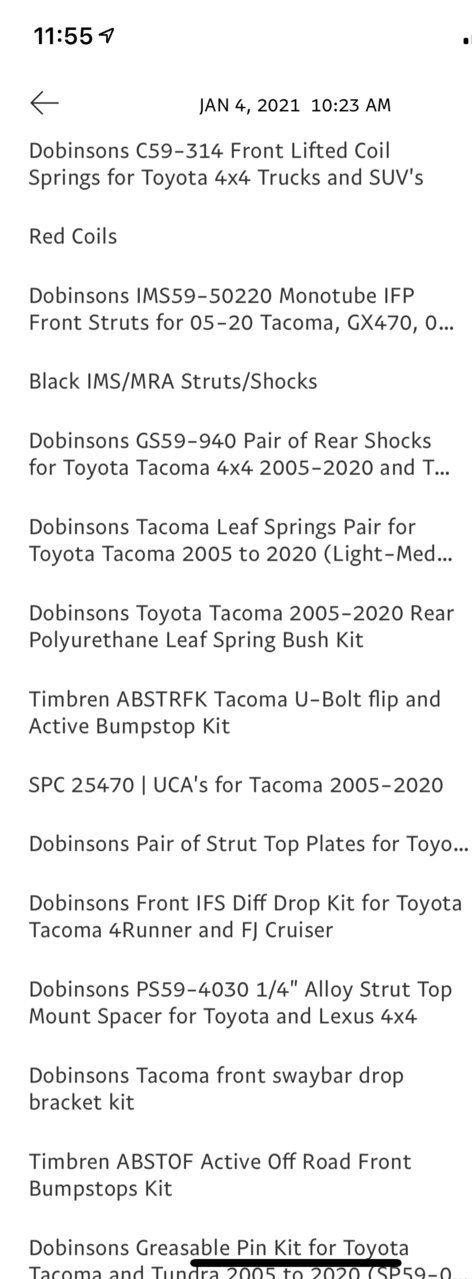

    That’s odd, I attached a screen shot of my receipt showing everything I ordered.
    I went with the IMS shocks, diff drop, u bolt flip, UCAs. Hoping I don’t regret not getting the MRR but I was already above budget.
    Thanks for heads up on lack of parts list or instructions.
    how long did it take for shipping with your order?

    As long as you have the **940 rear shocks, extended brake lines aren't needed. There's a new longer travel shock that brake lines and extended bump stops are needed for though, but you didn't get those.
