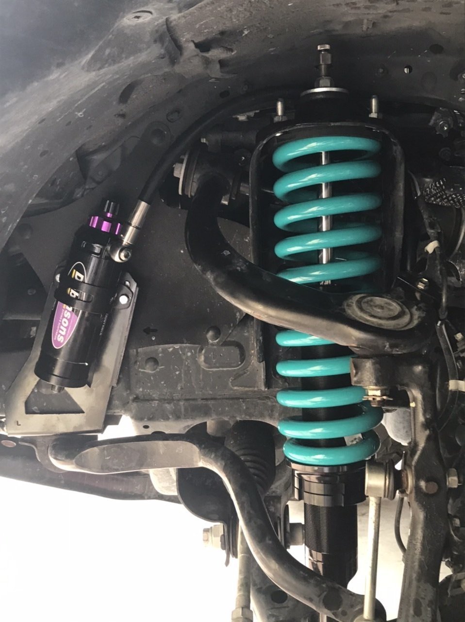

    Does anyone have a picture of where they mounted the front remote reservoir on a 3rd gen? I am stumped, it doesn't seem like the hose is long enough to use the brackets supplied when the suspension is at full droop and I feel like i'm missing something obvious.

    I assume you are referring to the MRA struts. Do you have them mounted like this? https://exitoffroad.com/product/dob...acoma-gx470-4th-gen-4runner-early-fj-cruiser/

    I have the old mount installed like @GrundleJuice pointed out (threaded directly into the frame). Pics here: https://www.tacomaworld.com/threads...o-bay-area-norcal.640100/page-5#post-23778010
    Attached is the new mount to the swaybar as @Greatdane01 posted here: https://www.tacomaworld.com/threads...-3rd-gen-today.399305/page-9316#post-24836818

    Thanks for the replies and pointers - I figured out from the picture above how to get it mounted after some searching which was enough for me to get it secured enough to drive it out of the garage - I'm going to revisit it all when I'm less tired. Thanks again for the help!

    aaaaand i ordered the new mount because that looks way better than the "eh, probably won't fall off" method i went with so I could get the wheels back on - thanks again!
