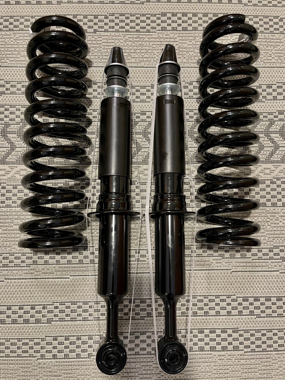

    #939
    fflo81615
    fflo81615 Well-Known Member
    Dec 18, 2017
    #238848
    116
    2017 Tacoma TRD OR
    These are beautiful! Just waiting on the rears! 41B6A674-4879-4AEA-8E08-E46EF9C5BA49.jpg
