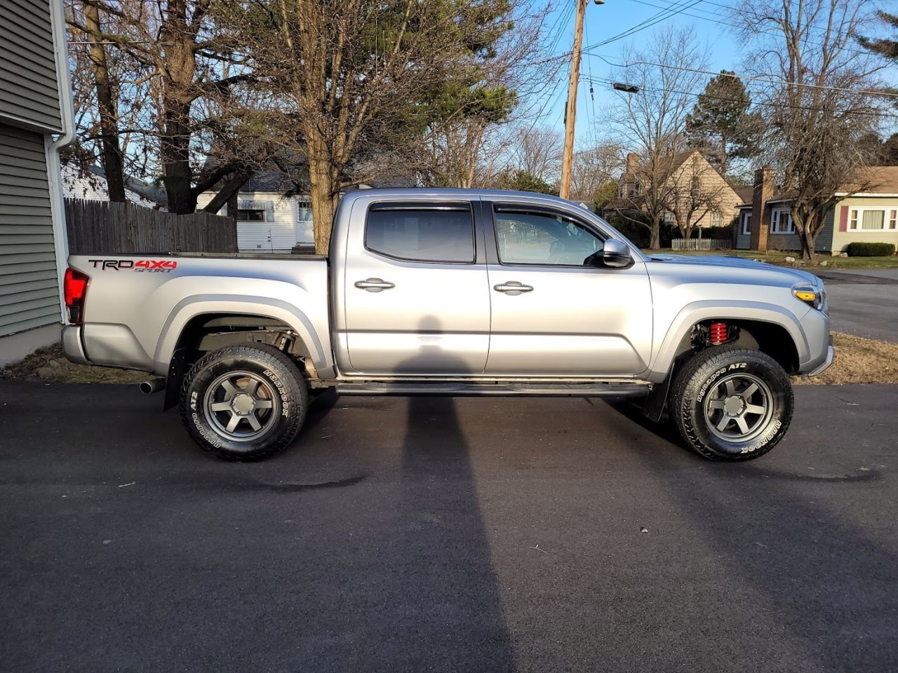

    Finally installed the MLO/Dobinsons suspension, and got exactly 24" from hub to wheel well (this includes a 1-1/2" add-a-leaf in the rear) on all 4 corners
