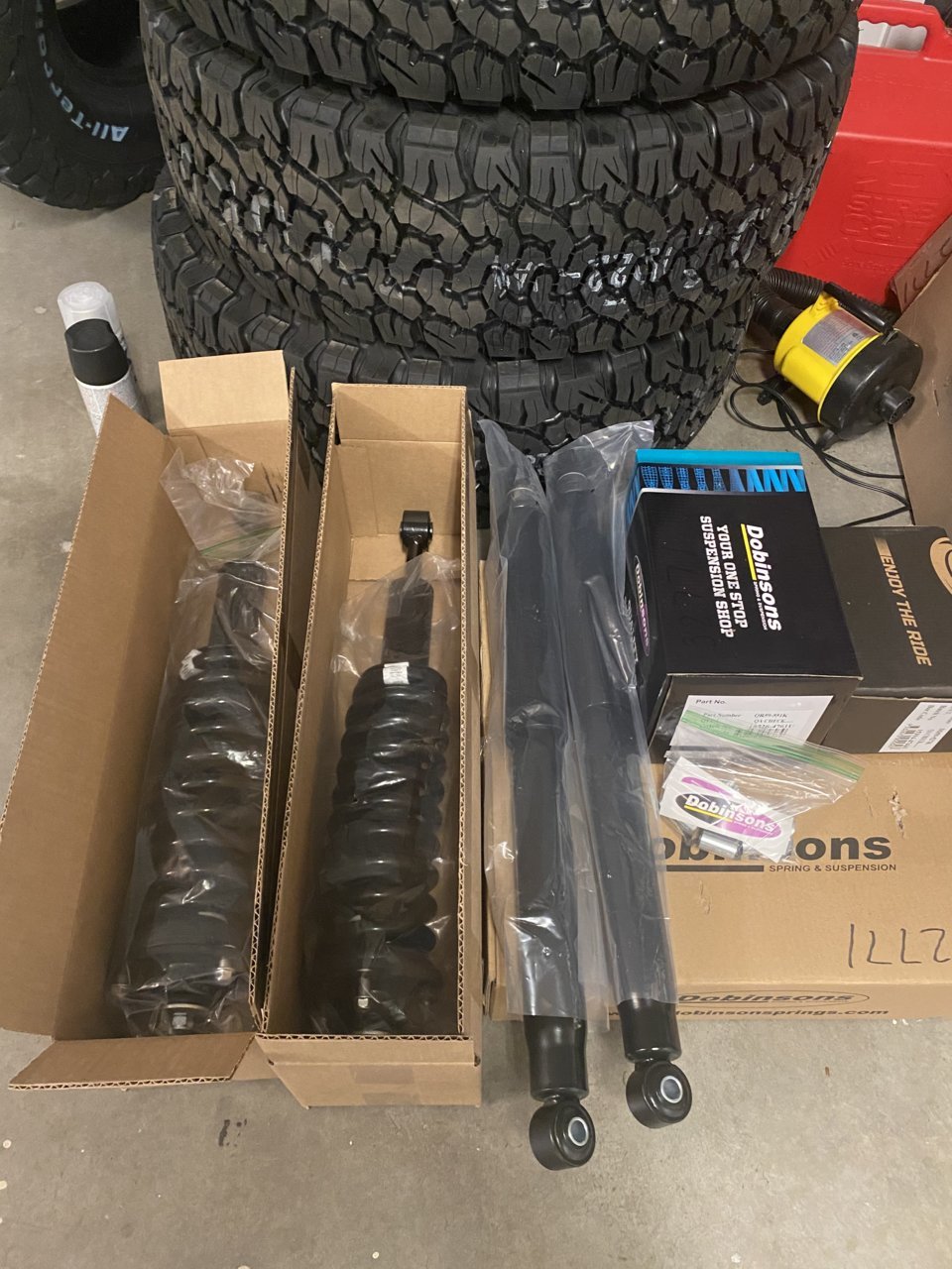

    I have them! Here

    They pair well with the dobinson leaf packs?

    Yes, I can specifically say the L59-111R Heavy Pack fits without any issue in the ARCHIVE hammer hangers
    [​IMG] [​IMG]

    That is one of the main reasons why I got them. :thumbsup: @ARCHIVE confirmed they work worked great with the HH. I confirmed the Dobinsons greasable shackle bolts do not work with the HH's because they're too long, etc. :rolleyes: So, pass on the greasable shackle bolts unless they're for the front only.

    Thanks, this is great info!
