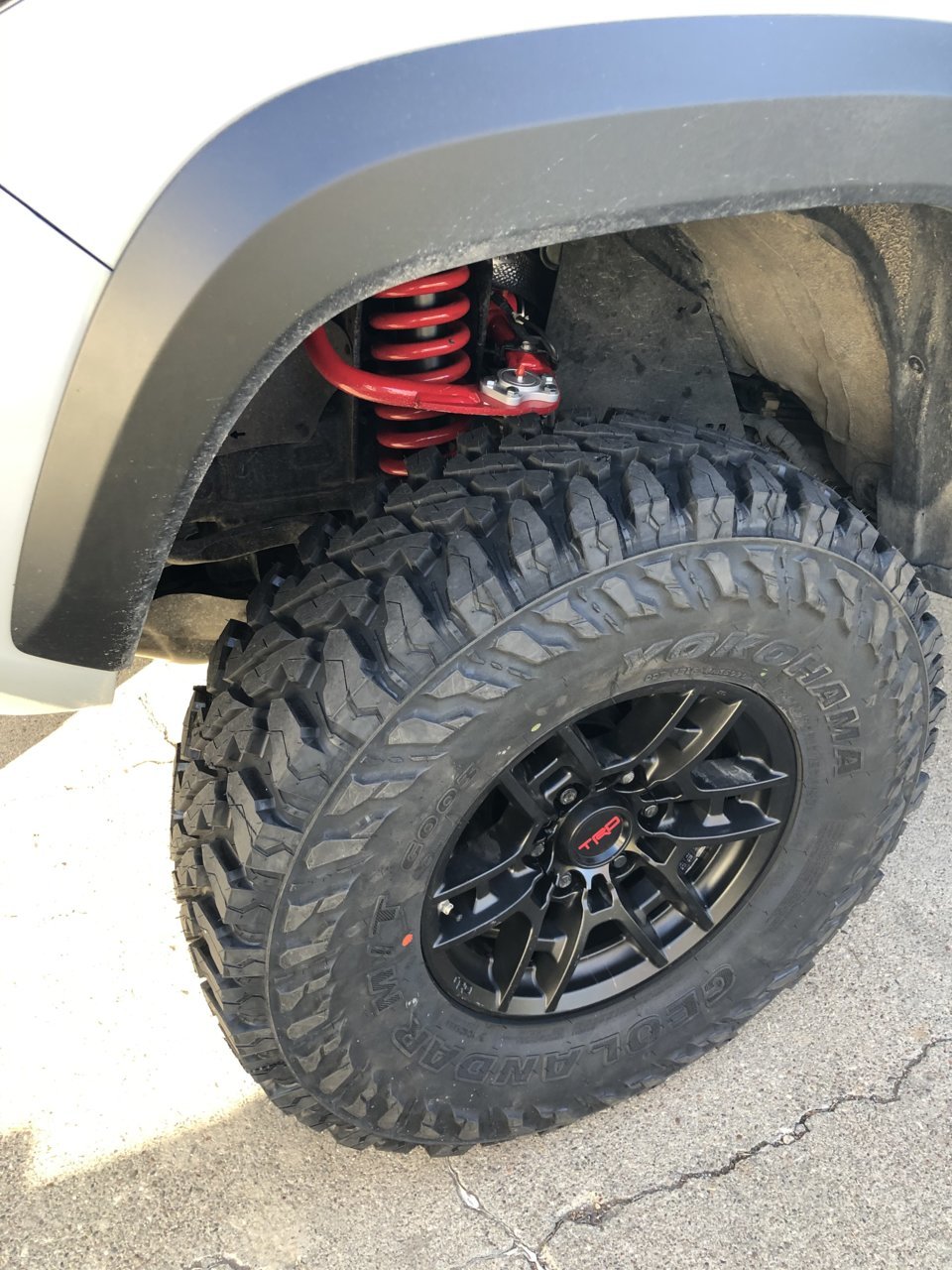

    I have the 352 with no weight set at 220mm got 2.75 saving my pennies for winch to go in my ARB bumper. Ride is a little bumpy but not bad.91BAEC9D-5B28-428D-91FC-F4349E568AAA.jpg

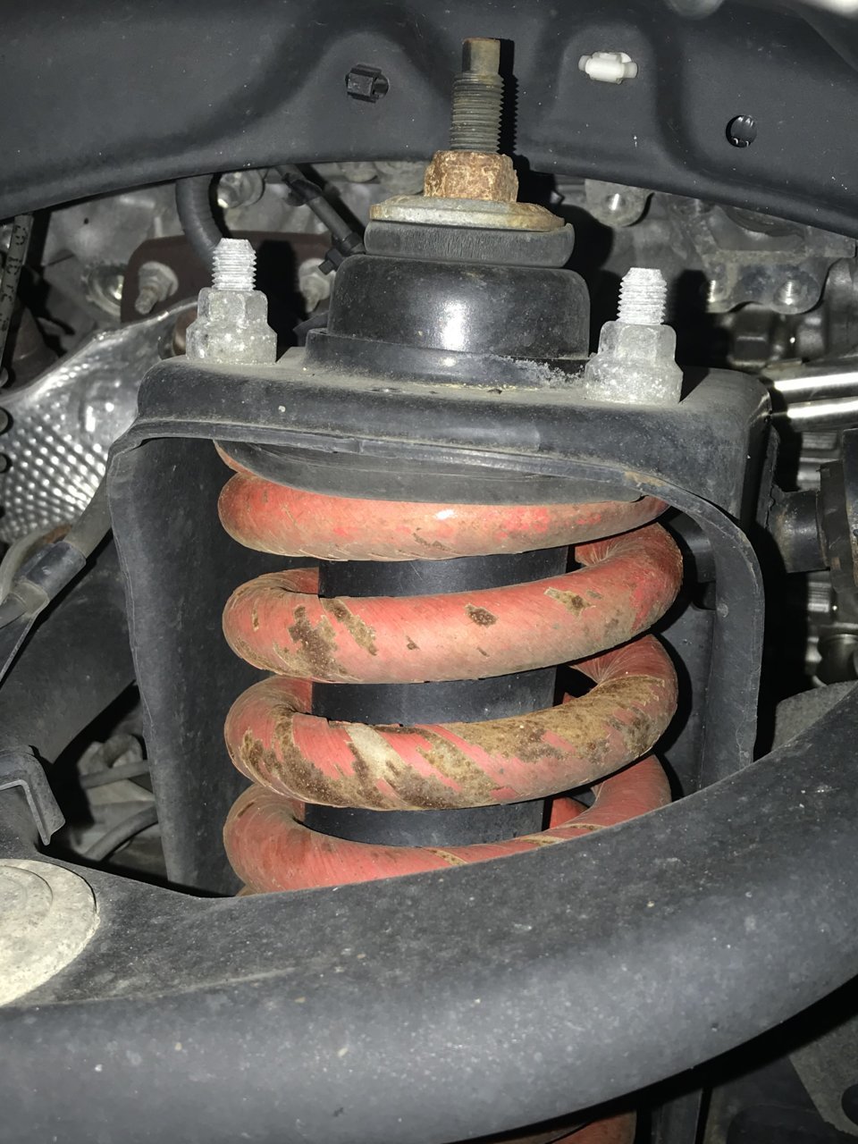

    Dobinsons Quick Ride 2” suspension kit, IVD Vector 6, Falken AT3W 285/70/17, SSO Slimline, Smitty 9.5
    8C45F3C2-866C-4045-B092-5F73AFEEC4E8.jpg Has anyone had an issue with their coil spring powder coat? I ordered a quick ride kit with C59-352 coils back in Oct 2019 and both are badly chipping. I’ve inquired with Dobinsons on filing a warranty claim but they need the serial numbers off the stickers on the springs themselves. These are unfortunately located on top/bottom of the coil requiring me to uninstall the front end (take a picture of these before you install!). I’ve debated on just ordering another set of coils and hoping for the best with the powder coating. Before I do I want to make sure this isn’t a known issue. The truck is my DD and I’d rather not take it apart multiple times.

    Dang dude, so you wouldn't recommend these dobinson springs? I have em on backorder lol but if this is gonna happen might as well get the plain black old man emu's (still going with dobinsons rear suspension)

    I’m on the fence at this point. They ride great but I want to find out if the chipping is an isolated incident. I hope others will reply on how theirs are holding up. I’ve never had coils peel powder coating like these have.
