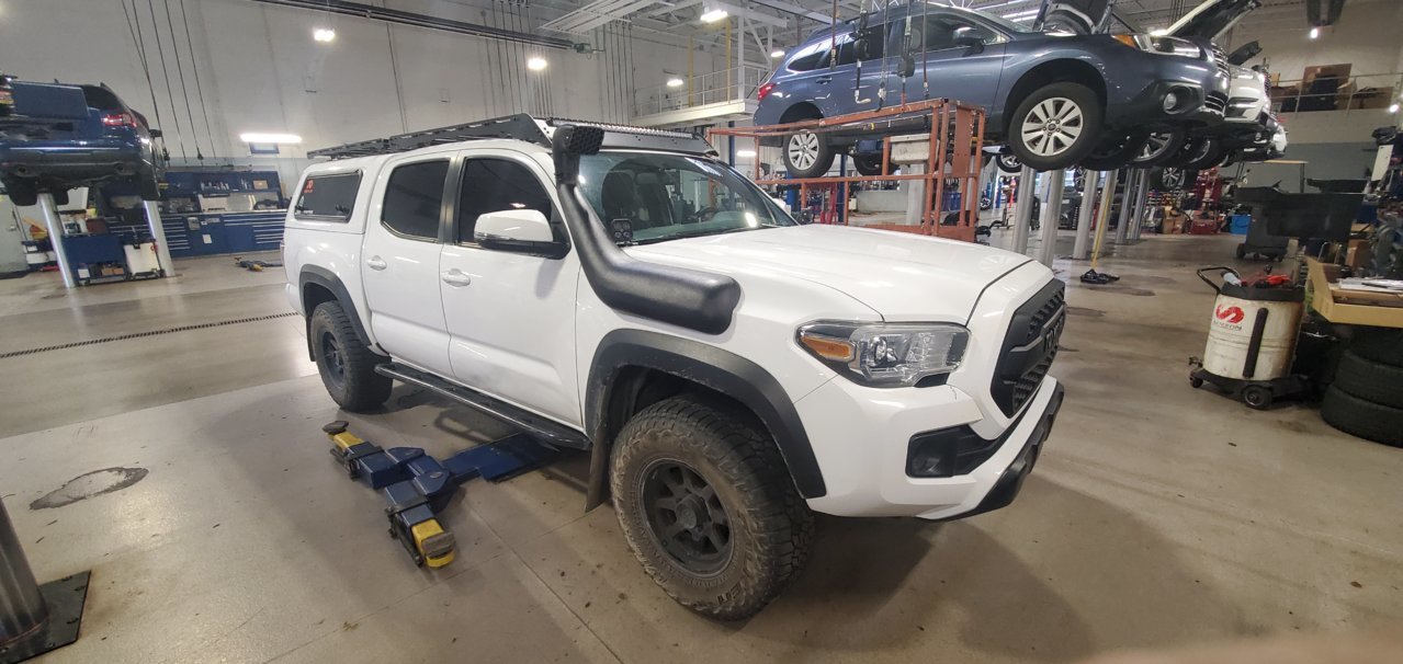

    Got part of my order in and installed after work today. Quick shipping for in stock parts and good upfront communication on the back orders parts. 20210510_192052.jpg
