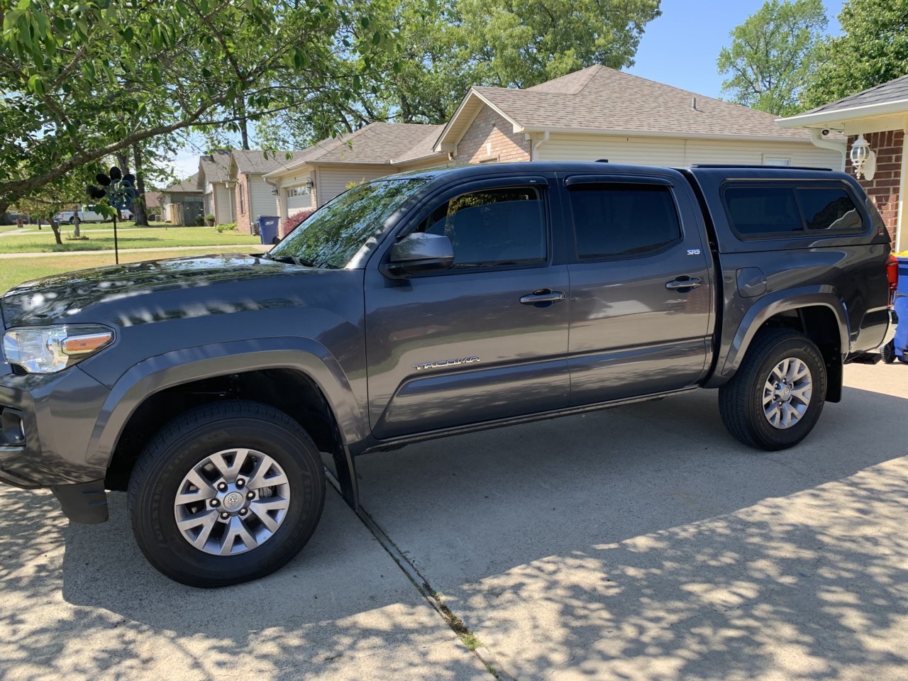

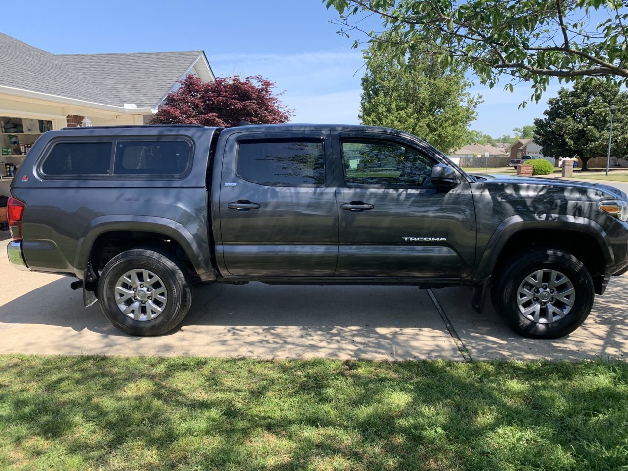

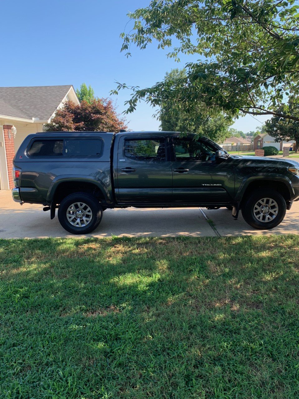

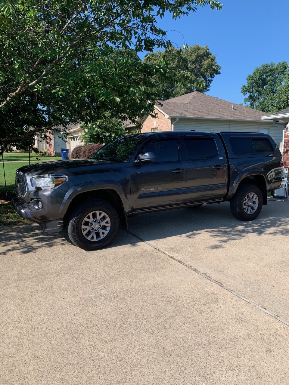

    Dobinson L59-110-R leaf pac's Installed.
    Before install. Camper Only (no extra weight)
    After install. (weight same as above)
    Before (different view)
    And after.
    EDIT as sugested by @Crikeymike:
    Unfortunately I don't have the earlier measurement of my rear suspension. But I did take earlier measurements and determined that I lost ~3/4" with just the topper alone. As of today (taking measurements like suggested earlier), I measure 22.5" on the driver side (with full tank of gas). And 22.75 on the passenger side.

    That's great to hear. An after-measurement can still be helpful (and add it to your post with the photos for future reference, to help others), from the center of the hub up to the fender edge. Probably 24" or so usually with those springs and some weight.
