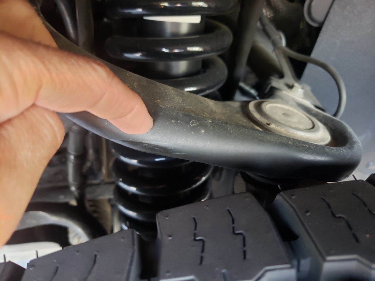

    This is where it is rubbing. Think your UCAs will work, or might I still be looking at spacers as well?
    CygnusX191 likes this.
  8. Aug 30, 2021 at 10:10 AM
    #1188
    Crikeymike
    Crikeymike [OP] ExitOffroad.com Vendor
    Oct 17, 2016
    #199985
    2,079
    Jax Beach, Florida
    I think you'll still need to space the wheels out, either by adding wheel spacers or new wheels with a greater offset. The Dobinsons UCAs "might" get it done, but I can't guarantee it.

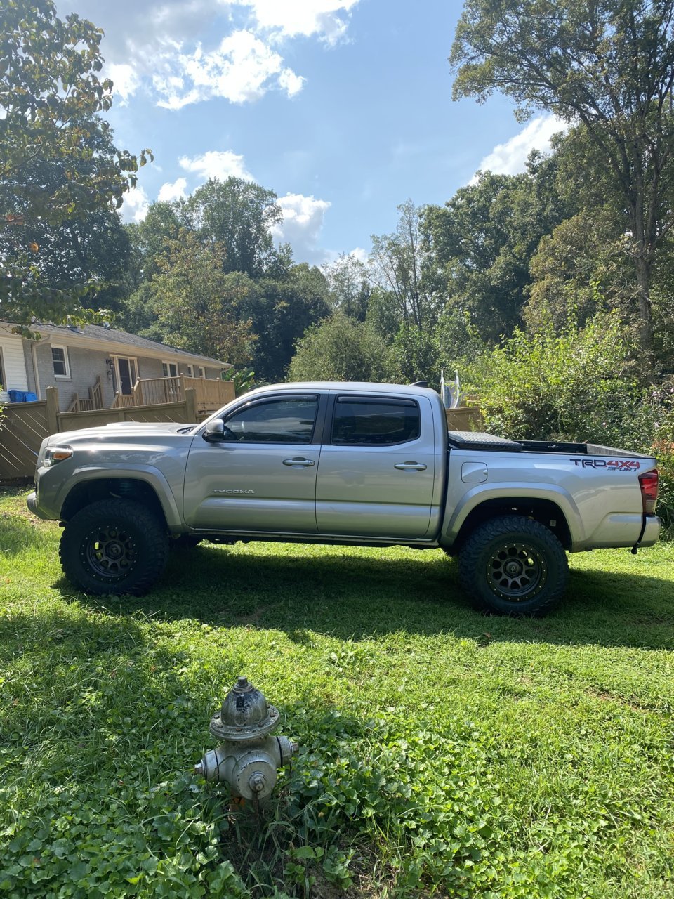

    CygnusX191 and Crikeymike[OP] like this.

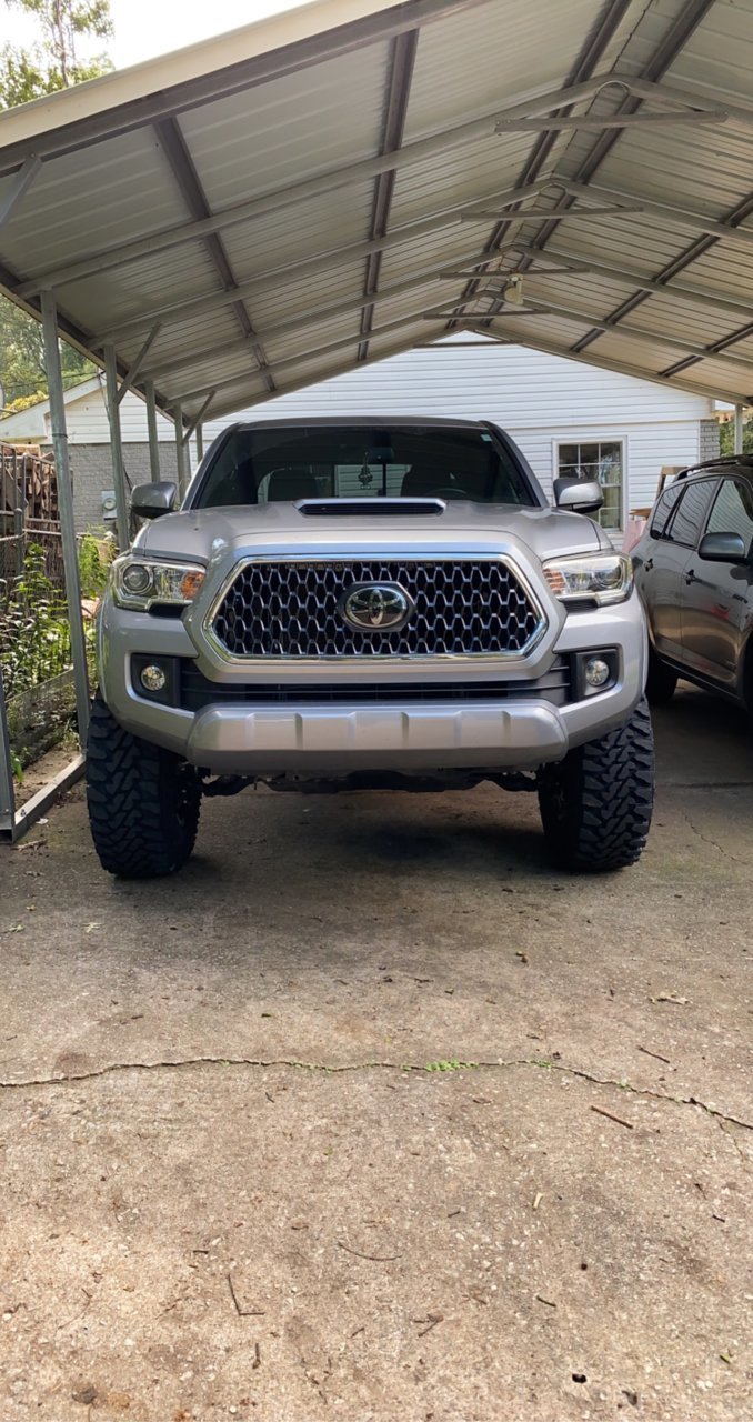

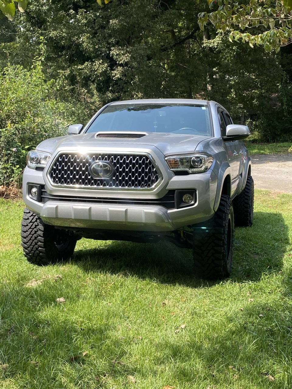

    Some more pics I took today. I’m really happy with how my set up came out. More smiles per mile !CDBA0F68-D9DE-4E83-BB31-E0D171B7A1C4.jpg 78780AD8-F223-4A1C-9CCC-77722041EDBC.jpg
