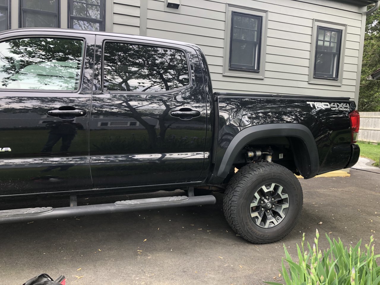

    Swapped out basic Dobinsons rear shocks for the MRAs.
    I'm just going to say it bluntly for anyone considering: if you're replacing the the leaf springs with even the lowest weight Dobinsons leafs and don't regularly have a load in the bed, skip the basic rear shocks and just save up for the MRA's. The entry level Dobinsons rear shocks with 110R leaf springs really made me dislike the ride A LOT. The MRA's are a huge step up in comfort for just leaving them at the lowest/comfort settings.
    My only complaints:
    - vehicle specific installation instructions would be incredible. I know that would be a ridiculous pain the in the ass logistically and don't actually expect Dobinsons to provide it since that's asking a lot, but it would be nice. I also fully understand shock and strut replacements are a super basic vehicle modification, but, for example, I didn't fully realize the rebound adjustment was on the shock's bottom mount (I thought it was the "knob" [not a knob] on the bottom of the reservoir) so had one side facing towards the axle mount that I had to redo. Not a big deal but I guess I just didn't understand the verbiage used in the instruction sheet in regards to that adjustment. Maybe I'm just a dummy, which would be embarrassing since suspension modification is what I've done the most on all of my vehicles...
    - that brings me to the universal reservoir mount. Dear lord, trying to tap a hole horizontally while crouched under a wheel well with gravity working against you is a ridiculous pain in the ass. I could never get enough "oomph" behind it to actually get the tap to bite. After two hours and three trips to the hardware store, I just said "fuck it" and did thru holes with bolts, lock washers, and nuts on the backside of the frame. Guess that's one advantage to a c-channel frame. Wouldn't have been possible with a boxed frame. But would be nice for Dobinsons to supply an extra M8-1.25 nut and lock washer in the kit to allow for that.
    - finally: now I guess I need to buy front MRA's :rolleyes: since the rears have made the stiffness in the front stand out so much!
    Really though: huge upgrade in daily driving comfort on the MRA's. No longer feels like I'm riding in a covered wagon on some of the shitty torn up roads around here and for the price, hard to beat for sure.
    I only took a photo of one side because I need to redo the mount on the other side as I put it in a really dumb spot but was too worn out to redo it by the end of the day.
    Since the shocks didn't change the ride height as I've already installed the 110Rs and 314 fronts, I'll just post a previous photo for posterity:

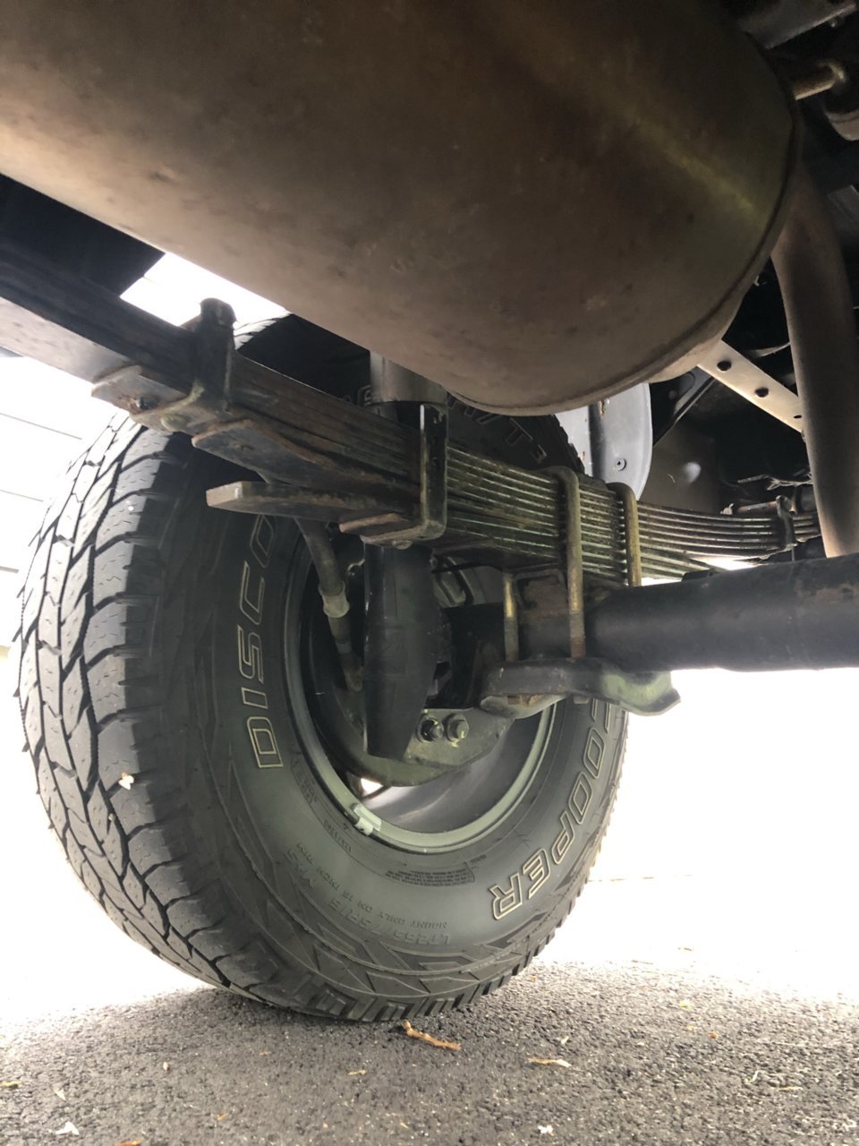

    like I said in the last post, previous owner said his truck had dobinsons leafs but not sure which ones. I do have one picture I didn’t post that says “0294” in yellow print and I’m pretty certain they’re Dobinsons. It’s very (too) tall unloaded. Of course looks decent loaded. Again, i'm probably being too picky but if its between the 111 and 112s i'm not sure what is best for me, someone who runs a truck camper half the time.

    It looks like the 112's for me (and yeah, about 3" of lift or so without any added weight), and with the weight of the camper, that's what he should have been sold. It's what you should run too, but you're right, you can't have it both ways. A stronger/thicker spring to support the added weight properly will of course sit up higher when that weight isn't on it. When you're loaded down is truly when you need the support, and the right amount of it.
    Sure, you can run the 111's and airbags still, but the airbags will still be doing a lot of the work, and that's a very heavy payload. I'd recommend the 112's, run them how they come and see how it is, then take out a leaf (making them 111's) if you can't stand the way it sits. Leaf springs are progressive by nature, and I've had many people tell me the ride "was fine" with the 112's and unloaded, but it won't ride as well as it's supposed to without the correct amount of constant weight added to them.
    The guy that ran those springs with that camper would be the right guy to talk to here, and hear any issues or positives he took away from that setup.

    That clears things up, thanks! I know the right answer is the 112s. I was just having a hard time accepting that. And it's good to know that I can mix and match the setup a little bit too. I'll be sure to post some pictures in the 2nd gen thread as well, since i have a 2nd gen as mentioned before. But either way the 111 vs 112 debate sort of applies to both gens equally interchangeably

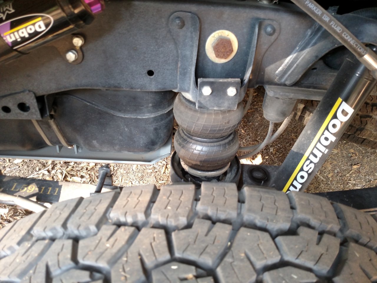

    Has anyone removed a leaf from a 111 leaf pack (to make it comparable to a 110)? I read that it was the fourth leaf that was supposed to be removed but the clamps/cradles are riveted (it looks like) to the fourth leaf from the top. So maybe its the third leaf that is supposed to be removed.. Has anyone done this?
    CygnusX191 likes this.

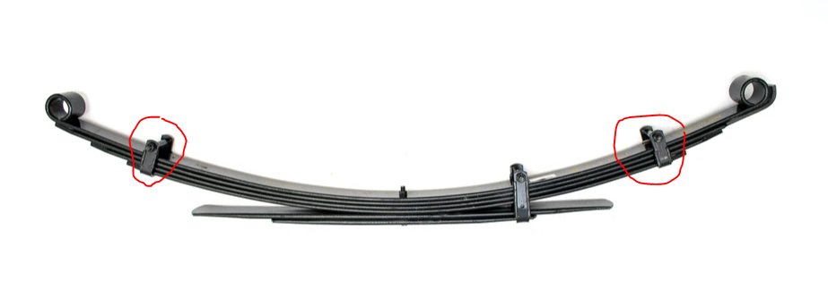

  20. Oct 9, 2021 at 11:10 AM
    #1220
    RyanDCLB
    RyanDCLB Well-Known Member
    Jun 13, 2019
    #296235
    3,543
    4/19 DCLBOR
    Edit: the design must have changed. 4th one down - the one just above the large overload. You should be left over with 3 main leafs and two overloads.
    Picture of my older leaf pack in the spoiler below:
    Should look like this when complete:
