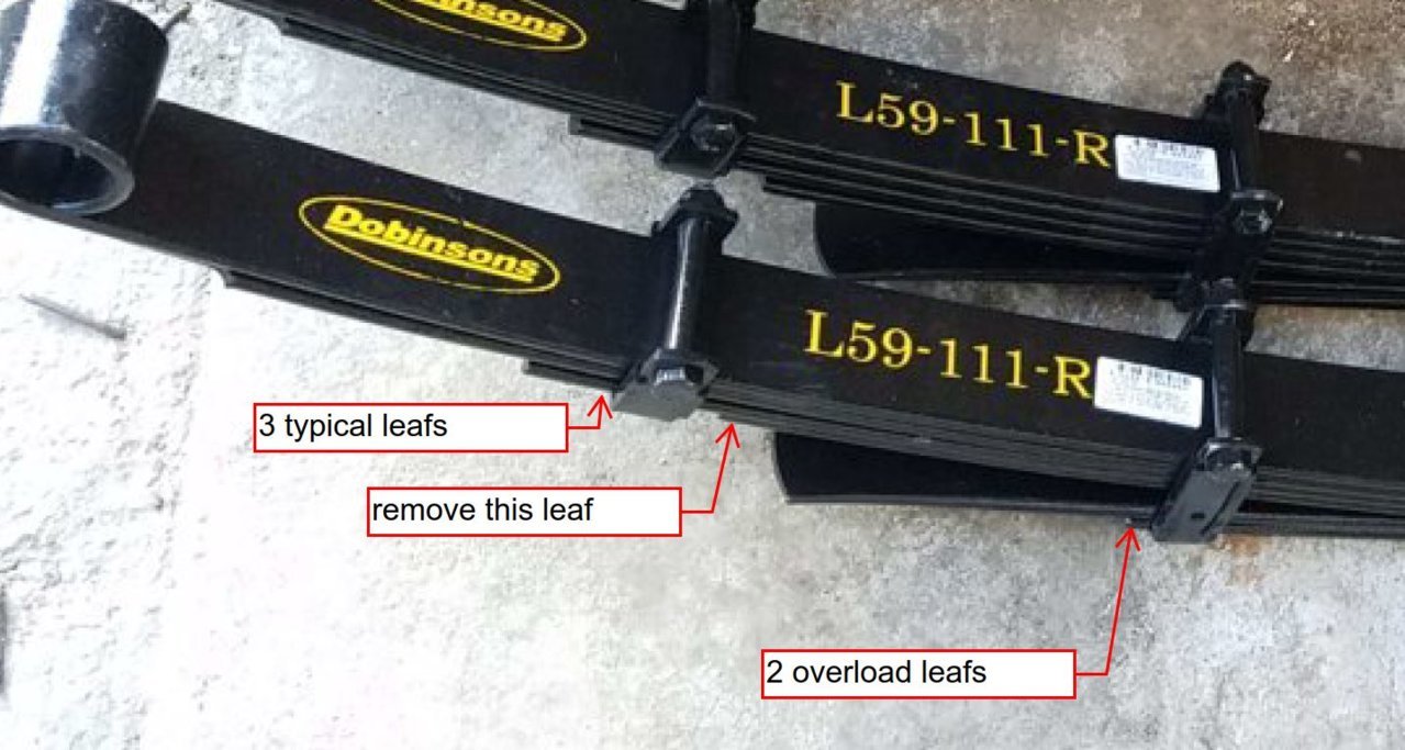

    Thanks - to me it looks like the third leaf down would get me the closest to looking like the picture of the 110 pack. The fourth leaf is an issue to remove because two of the three brackets are attached to it.
    The picture of the 111 pack in the post above looks like the old design - second leaf is different and the bracket placement is different than the newer 111 pack.

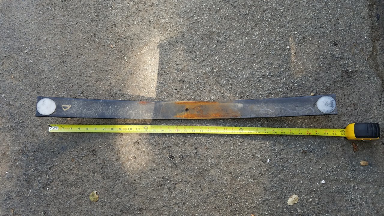

    My 111 pack had 6 leafs. The extra leaf was wedged in below the bracket leaf, above the two overload leafs. The picture you provided looks like a 110 pack as it only has 5 leafs.
    Picture of the leaf I removed (older design) in the spoiler here:

    The picture I posted has 6 leafs and is accurate to what I have (there are 4 leafs and 2 overloads). I think this is the updated design which is why it looks different than yours. There isn’t a comparable fourth leaf that is wedged below the bracket leaf so I think the only one that can be taken out is the third. Has anyone done this on the updated 111 leaf pack?

    Here is what I did. @Crikeymike can confirm if the leaf pack design has changes since I received my pack.
    Description of the leaf I removed in the spoiler here:

    Sorry, my bad. I see the 4th leaf. So, the design must have changed. Please disregard my info.
    All I got is the link to the extra 111 leaf, and it looks totally different than the leaf I pulled out. IMO, correct, it looks like the only option is to pull the 3rd one down, but you should probably confirm with Mike or DobinsonUSA :notsure:

    Good find on the extra leaf. It certainly looks like the third leaf. @Crikeymike can you confirm that this assumption is correct (taking the third leaf out of the latest design 111 pack effectively makes it a 110)?

    It's the 3rd leaf that would be removed
