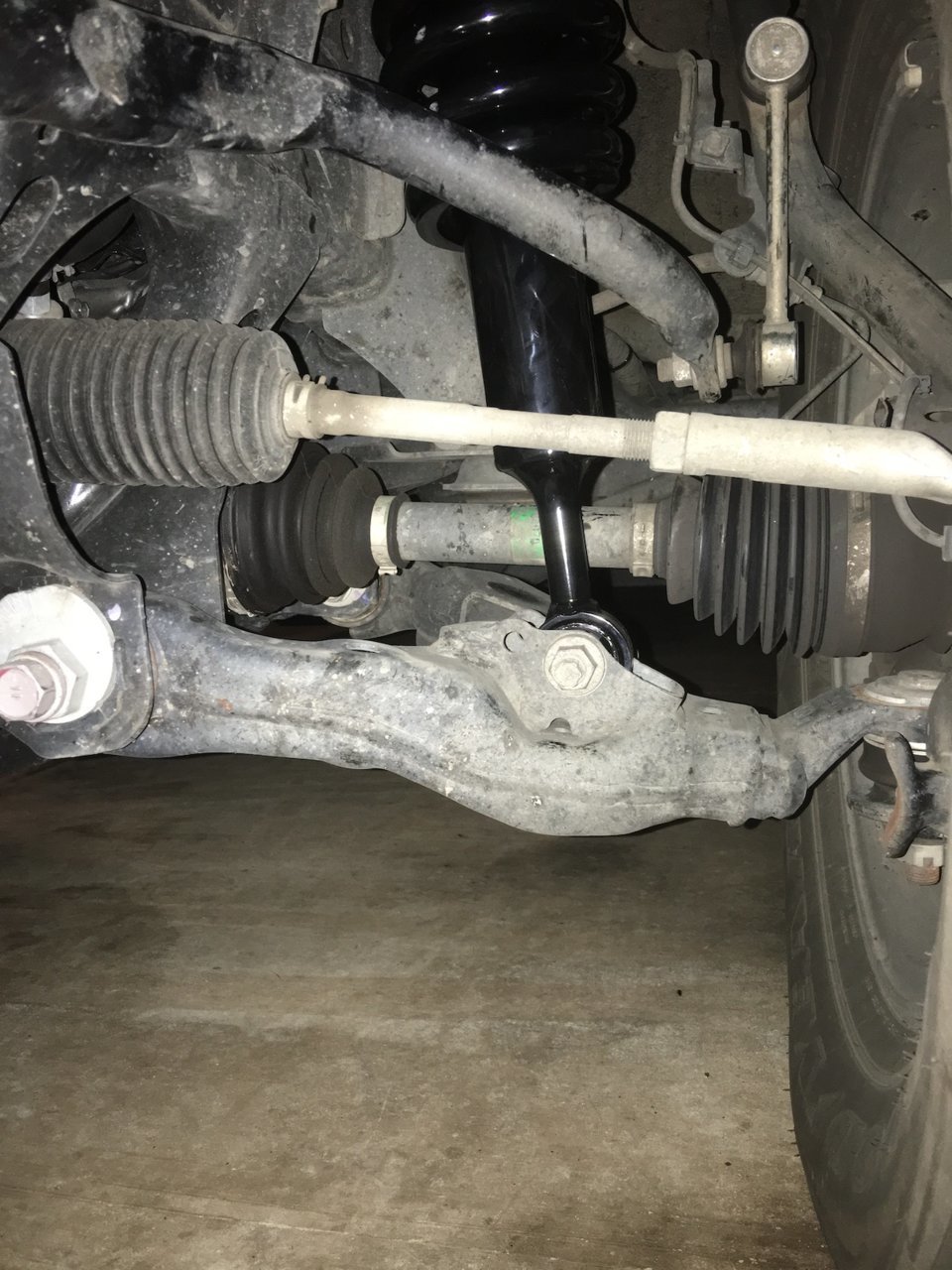

    That’s what I’ve heard/come to understand. Is there anything I should do for better CV angle or will the new UCAs take care of any issues?
    EDIT: or does it matter at all? I am under the impression I run it as whatever it is and if a boot rips then I’ll take it it somewhere to do the boot slide mod since it seems a bit more involved than I understand currently

    To be fair, if you do mostly overlanding or lightweight, a div drop won't hurt you.
    Also, if your suspension lift is under 3 in you might be able to get away without any CV boots tearing and whatnot. It does happen though, there are plenty of aftermarket extended travel CV options, or various mods (like the boot slide)

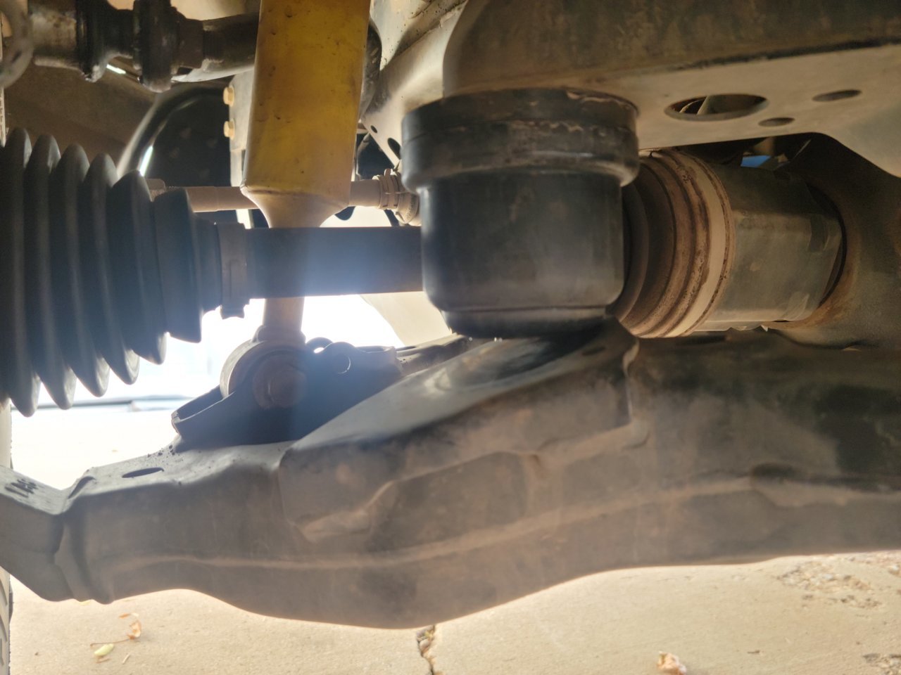

    I don't have any install pics, but here is one of the left side boots. I don't think you will have a problem with the boots rubbing. I don't have a diff drop and have had no problems.

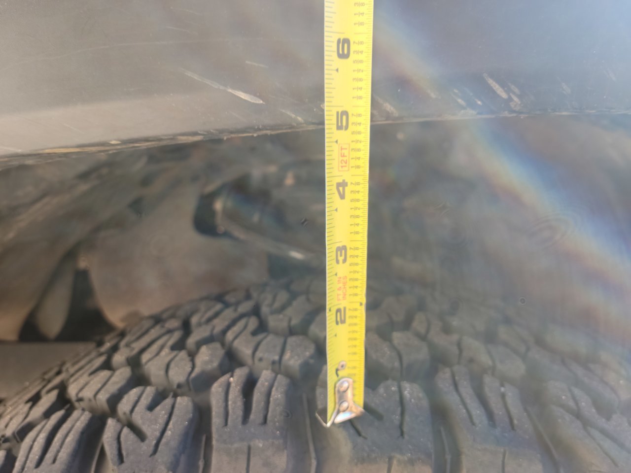

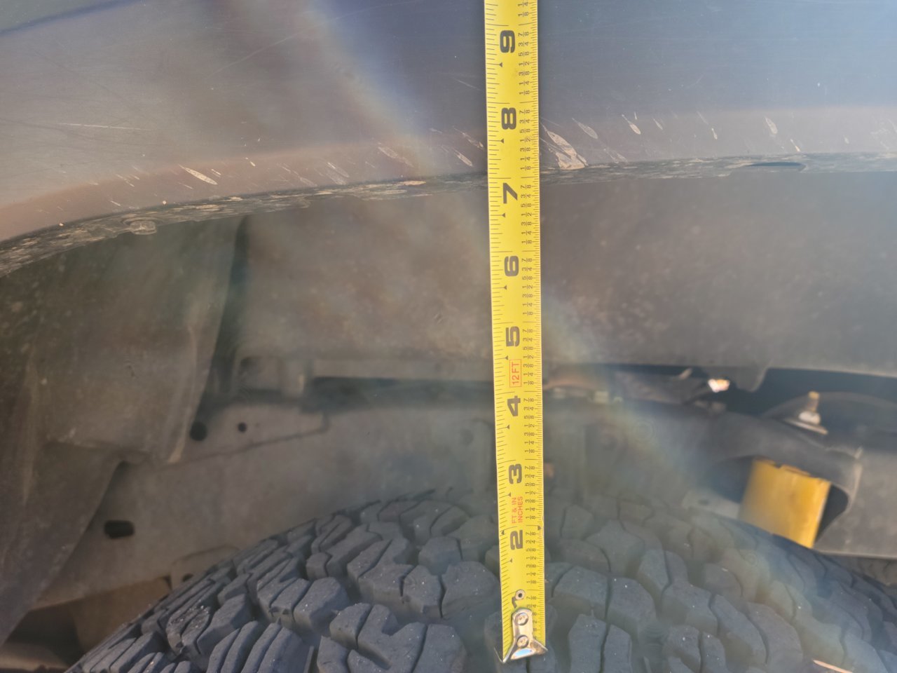

    Just wanted to share for anyone running C59-350 springs and GS59-220 struts up front and trying to stuff 35's. I've had a hell of a bad time with this setup as it simply does not lift the truck enough and you will get major rubbing on the top of your wheel well, even on dips and bumps around town. My truck has quite the rake (2" from back to front) since that front combo doesn't lift the truck very much.
    For a cheap 'fix', I added wheelers superbump spacers to my wheelers superbumps and it has mostly solved the issue. The suspension does basically ride on the bump stops at all times but it's not super rough as those bump stops are pretty soft. If anyone has yet to buy C59-350 springs and GS59-220 struts I'd highly advise against it if you want to run 35's. I think dobinsons stuff is good but I would not go with that combo as it does not lift the truck enough to clear big tires. Something with an adjustable collar would be better and I hope to upgrade to something like that in the future.

    Back clearance, front clearance, and riding on bumps
