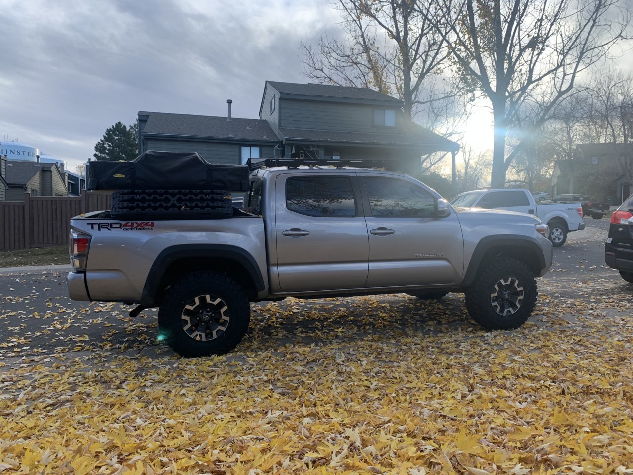

    These skinny’s are… skinny. I think with some spacers in the meantime before I get wheels it’ll help the stance look a bit. Just got it aligned at a Brakes Plus right by my house.

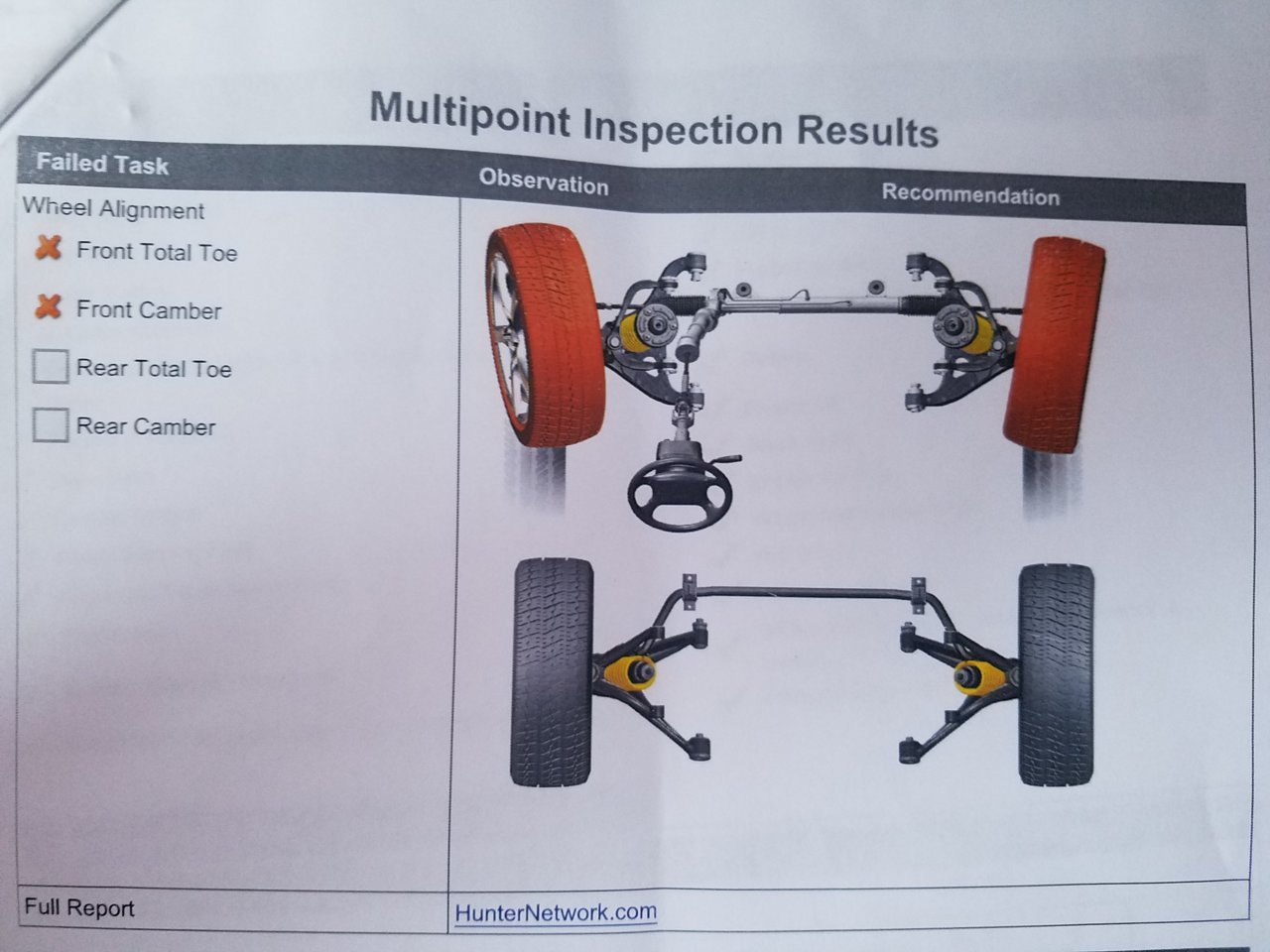

    Just got back from the dealer for my Toyota Care service, and they rotated the tires. What do you think is going on here? Truck drives fine, just a little choppy feeling from rotating the tires :notsure:

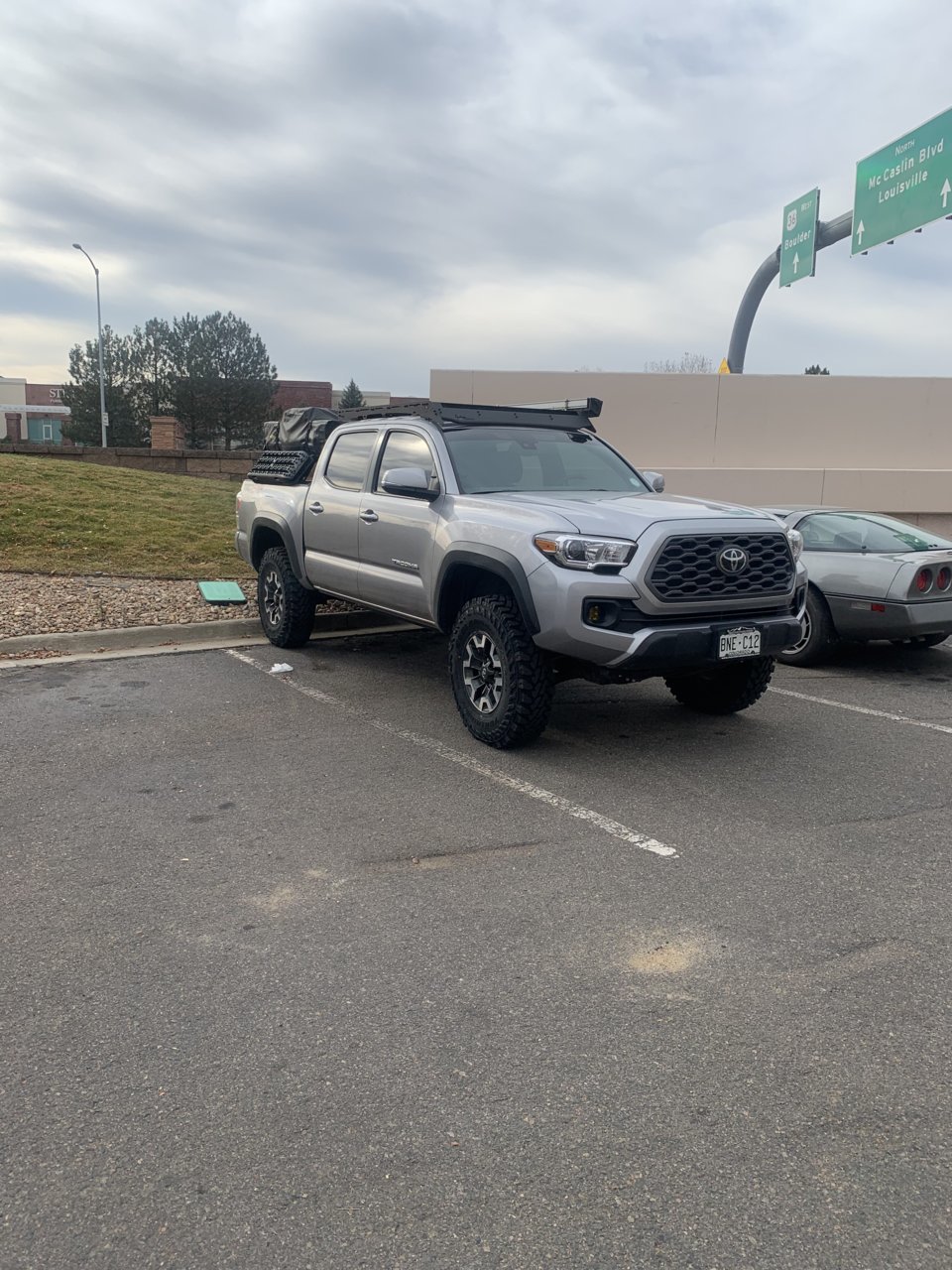

    These look mega skinny. Yokohama Geolandars G003, 255/85/16 on stock 2020 TRD OR wheels. Might go 285s. Might try spacers first.
  20. Nov 10, 2021 at 7:55 AM
    #1280
    MountainManGuy
    MountainManGuy Well-Known Member
    Jul 26, 2019
    #300316
    808
    Colorado
    2019 Toyota Tacoma TRD Off-Road DCSB
    Your truck is just wearing high heels
