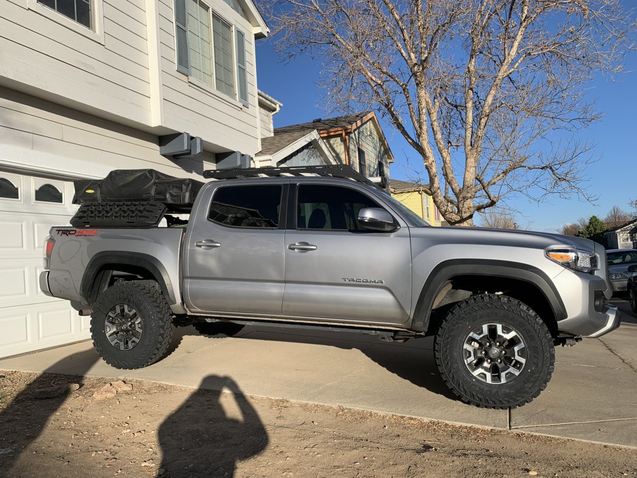

    I just measured hub to fender on all 4, I think I only got an inch of lift in the front with 352 coils on stock weight? In the rear right now I have my CBI overland bars, Smittybilt tent, and 4 Falken Wildpeaks in my bed (old 265/70/16 tires).
    Front Driver: 22.25”
    Front Passenger: 22.5”
    Rear Driver: 23”
    Rear Passenger: 23”
    Am I missing something here?

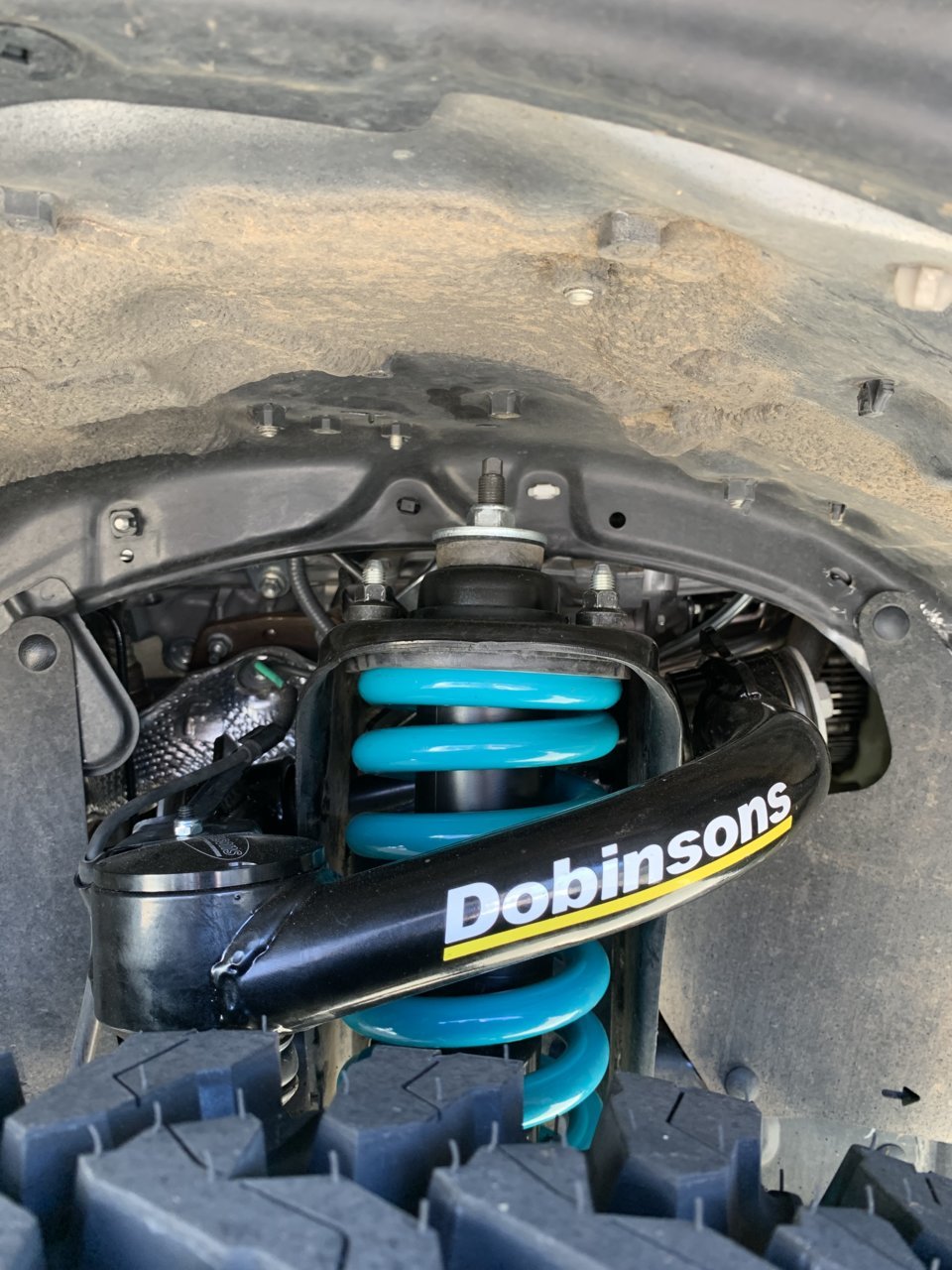

    #296235
    3,547
    4/19 DCLBOR
    Did you max out the 226 mm distance as shown in this post? If not, what's your measurement? It took me 3 tries, and I'd still like another 1/2" (;)). 1st was to install the coilovers as assembled, 2nd to crank the threads to 226mm, 3rd to add the 1/4" top spacer. The springs also settled somewhere in-between. If it were me, I'd go a spring up from what Dobinson recommends.

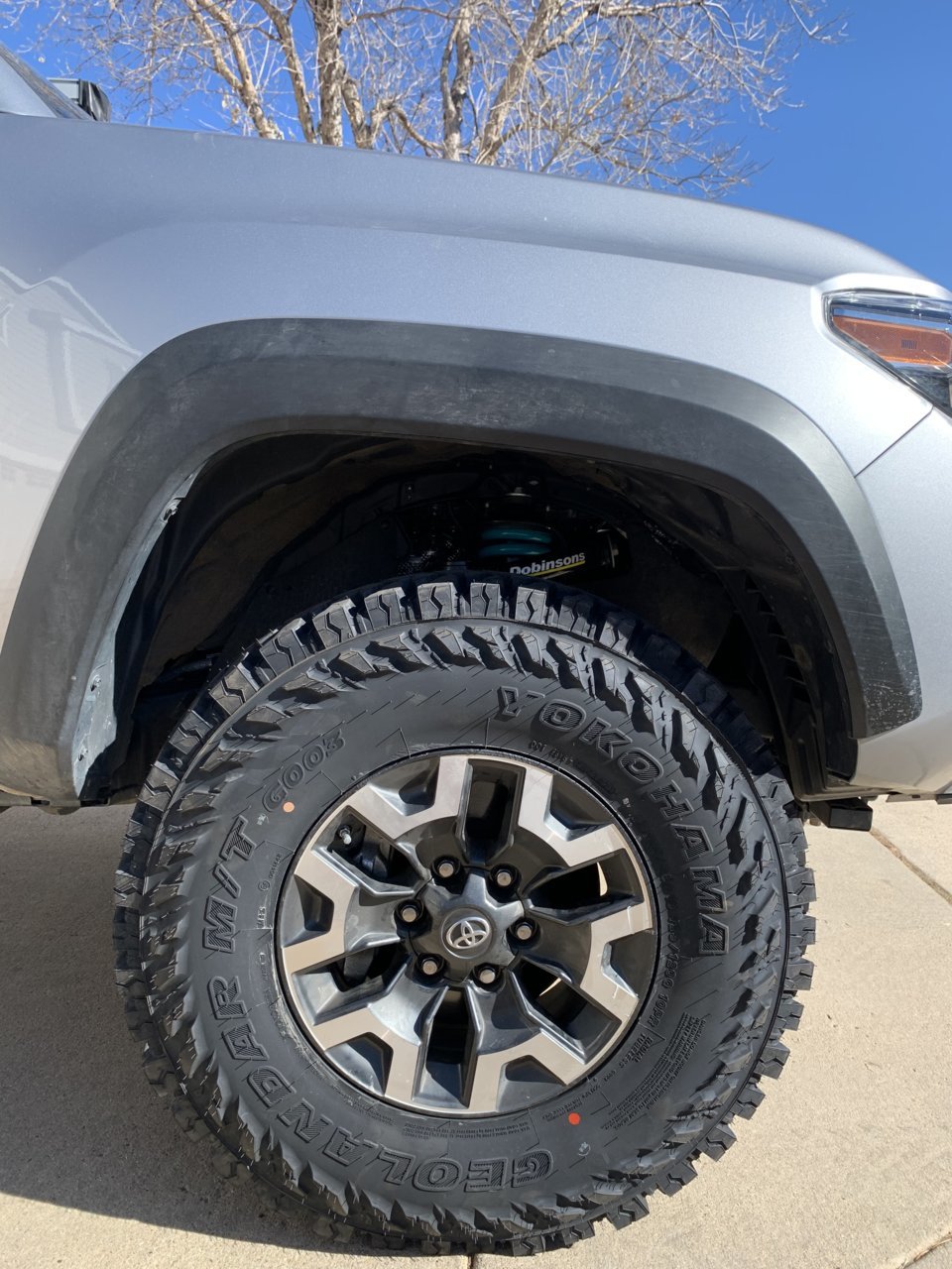

    I didn’t do the adjustable ones. Looked like the spring just dropped onto the strut and then I assembled the rest. Here’s a pic:
    Tire is 255/85/16 so I think if it was only 1” it wouldn’t have that much fender clearance? I’m just confused all the way around now.

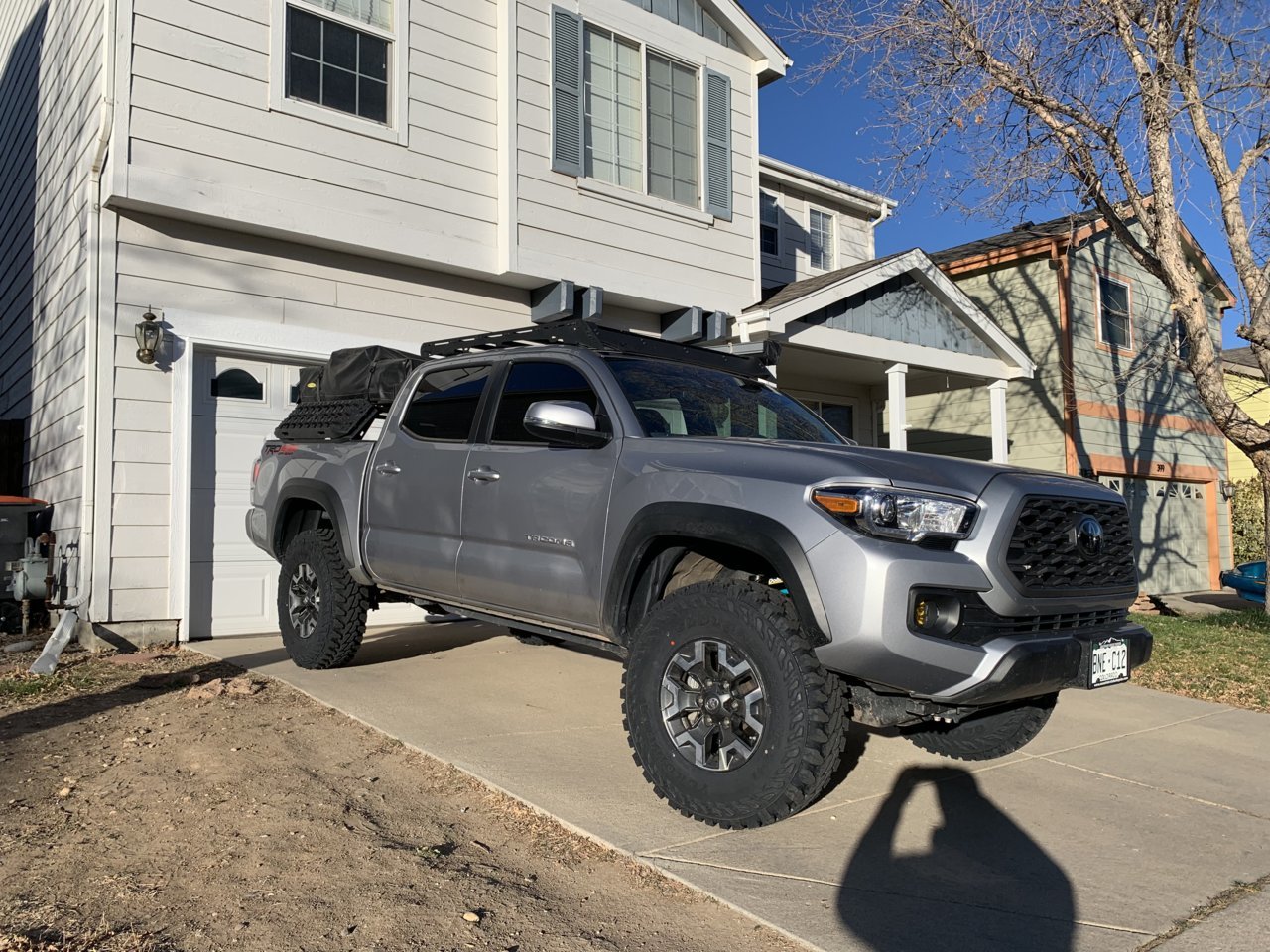

    Some better pics of the skinny’s and lift before I put the 285s on Monday
