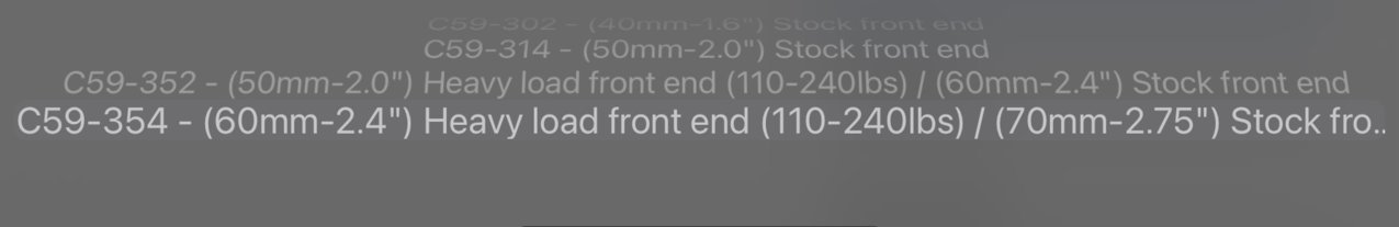

    It will probably settle even a little more...I originally had the 302 coils on the 220 struts and 110R in the back, ended up at just over 1" all around on stock weight, even though those are supposed to give over 2". Upgraded to the 314s and 111R in the back and now I'm settled at a little over 2". I've seen a few other guys post in this thread with the same issue, I'm not sure if some trucks are different or if most people just don't notice the lift settling :notsure:
  2. Nov 10, 2021 at 4:12 PM
    #1302
    TheColoradoAthlete
    TheColoradoAthlete Well-Known Member
    Nov 2, 2021
    #381100
    104
    Colorado, USA
    2020 DCSB TRD OR
    Looks like 302 is 1.6”, 314 is 2”. 352 should be 2.4” on stock front weight.
    Edit: you said 220 struts so add 1” to above, sorry. That is a massive bummer. I would have gotten the other struts and the heavier leaf pack if I knew what’s advertised isn’t correct.

    I reached out last night to Dobinsons Direct. Explained what’s going on and they confirmed 2” front and 1.25” rear. I mentioned I submitted my full order just a few days before the 10% sale. AAL to 110s to make them 111s is 5% of my order total, so getting those for free would make me get the advertised rear height and account for ordering just before a sale. I don’t know what to do about the front. Should probably get the other struts because 354s instead of 352 coils would make the front unbearably stiff I think. But that’s like $600? At the end of the day, I should be getting what was advertised. I ordered UCAs because I thought my lift would be 2.5” and I wanted to be safe. But if it’s 2” now and settles to 1.5-1.75” then I wasted money on the UCAs and didn’t get what I wanted or what was advertised. I’m hoping Dobinsons helps me to resolve this as I really do like the suspension and I’ve enjoyed the customer service so far.

    Spring rate on the 354s is the same as the 352, only the length is 1/4" longer. Somehow it all works out (stiffness should be the same).

    As mentioned, I'd personally go for the 354s. It will feel stiff in the rear with the 111 add-a-leafs, but that is technically the correct application for the RTT. If you're always removing the weight from the bed, then I'd consider keeping the 110s.

    Seems like 354s and 111s gets me what 352s and 110s advertises. Hopefully they send me the new parts and I can ship them the current ones after I install the new ones. What a mess. Just advertise the right numbers. Thank you for the info.

    I found the rear leafs gave a higher lift than advertised, while the front coils gave a lower lift than advertised (especially after settlement). But as @Crikeymike said, tacomas vary from 20, 20.5 and 21", so there's a range depending on the model weight. For anyone considering this suspension, if looking for max lift in the front, then you may consider going one size up. :devil:
