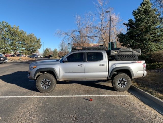

    Well I was right after all. I was definitely not recommended the correct springs (350's) and should have gone with the 352's or 354's. I added a .5 inch spacer from toytec and it lifted the front 1inch. Looks WAYYY better now. Only have 1 inch of rake now from back to front. I took it wheeling today and I could not get the thing to bottom out and rub like it was previously. This is how it should have been sitting all along... I'll try and snap a pic tomorrow if I can remember to.

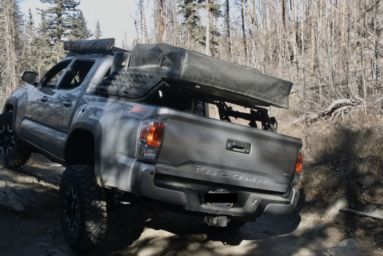

    Solid flex there man! Yea I'm down in the Springs area and am always down to go wheelin. Ran China wall yesterday solo and it was a blast. We gotta hit a trail before the snow gets too crazy

    That is some great flex!!!

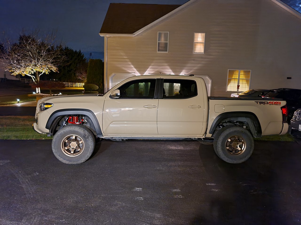

    Finished up my install. Really happy with how it turned out, still trying to dial in the adjustments but it already rides a thousand times better than stock.20211124_223812.jpg

    Whatcha got on there
    CygnusX191 likes this.
  11. Nov 27, 2021 at 9:04 AM
    #1331
    Aje0010
    Aje0010 Well-Known Member
    Jun 27, 2019
    #297574
    48
    Alec
    2019 Quicksand TRD-OR MT
    Coils: C59-314
    Front strut: MRA59-A220
    Rear shock: MRA59-A940
    Leaf Springs: L59-110-R
    TMoSD and CygnusX191 like this.

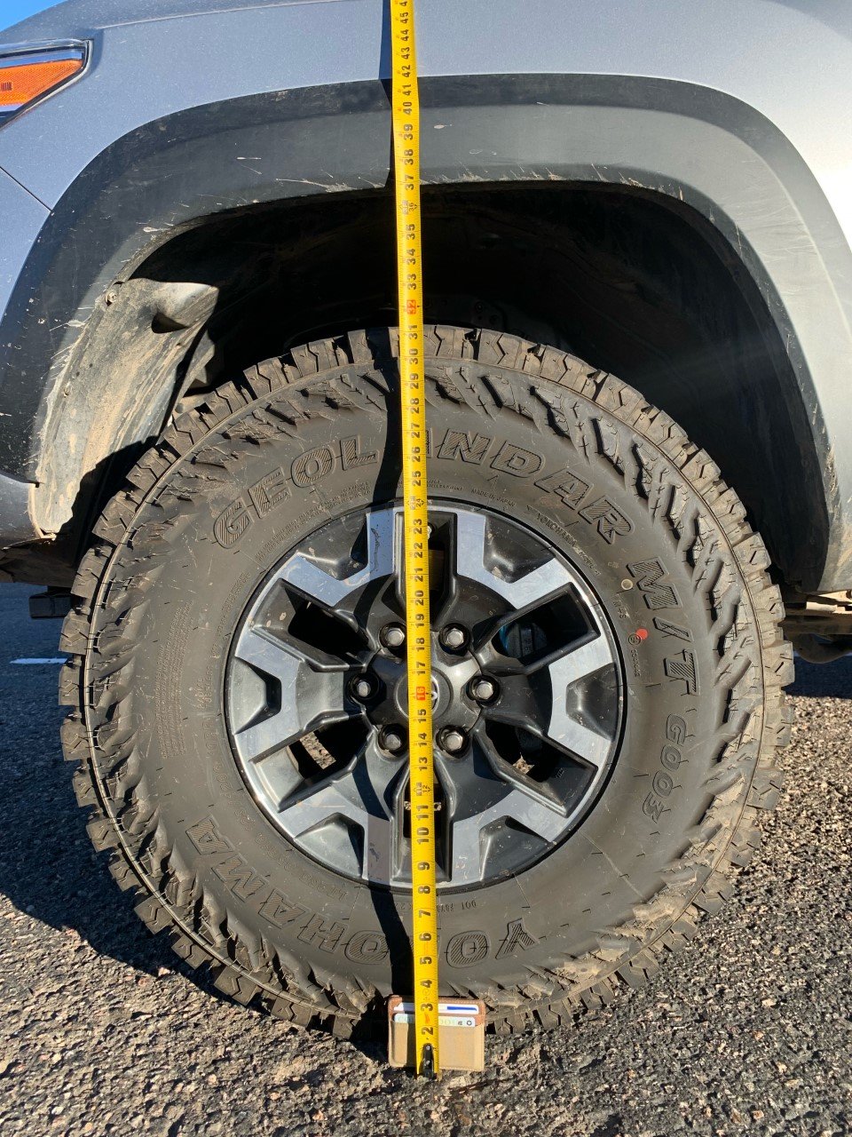

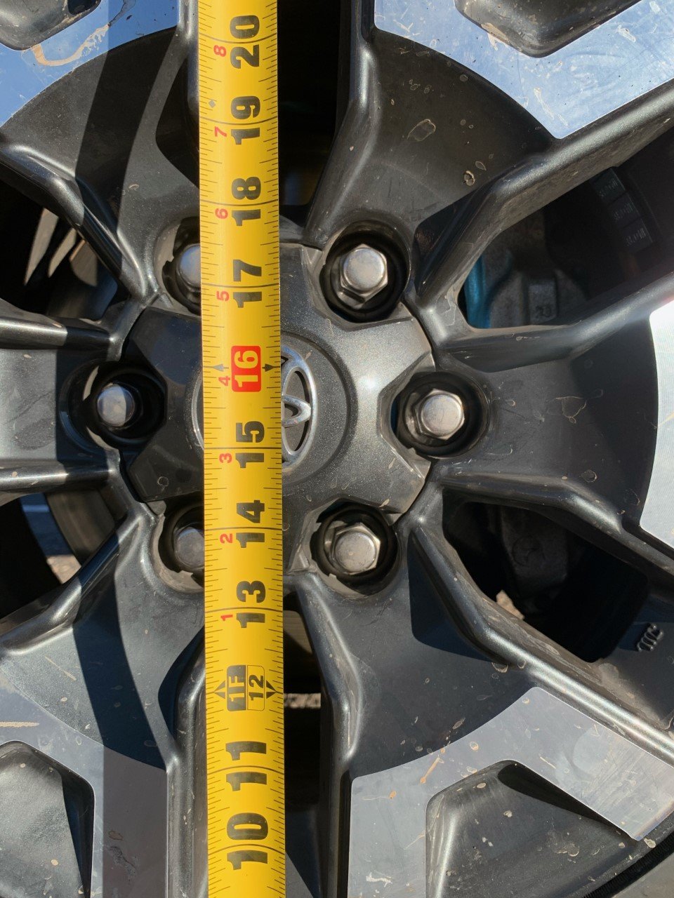

    Update:
    My hub to fender measurements after 1 month are now:
    21.5 and 21.75 in the front
    22.75 in the rear
    That’s about 3/4-1” of front lift and 1/2” in the rear?
    Parts installed:
    221 struts
    352 coils
    UCAs
    940 shocks
    110R leafs
    I’m stock weight in the front and 150lbs in the rear. I’ve emailed Dobinsons again to try and get this resolved ASAP because I am now rubbing around town on $1300 new tires.
