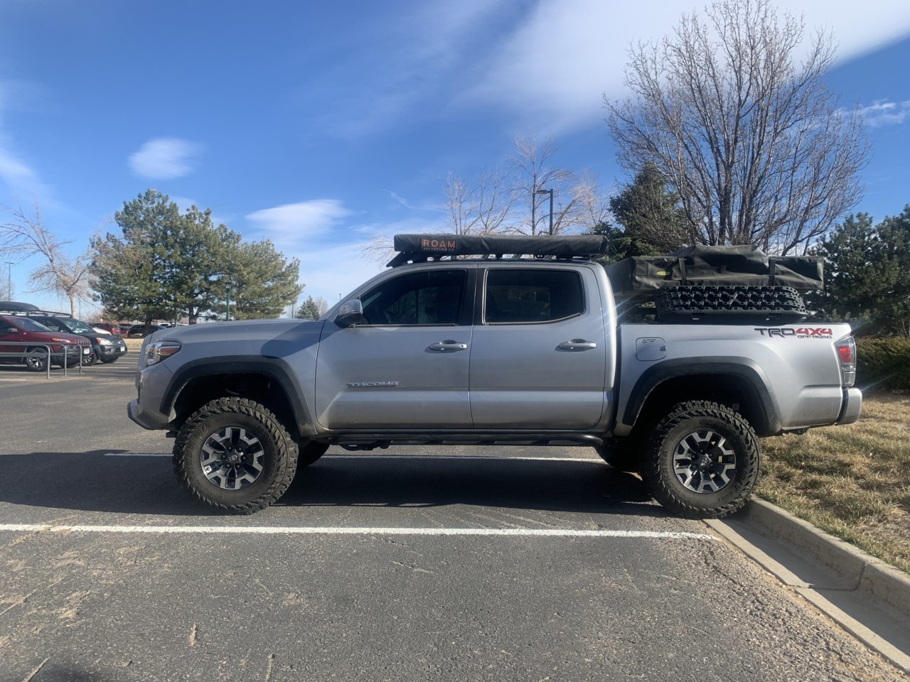

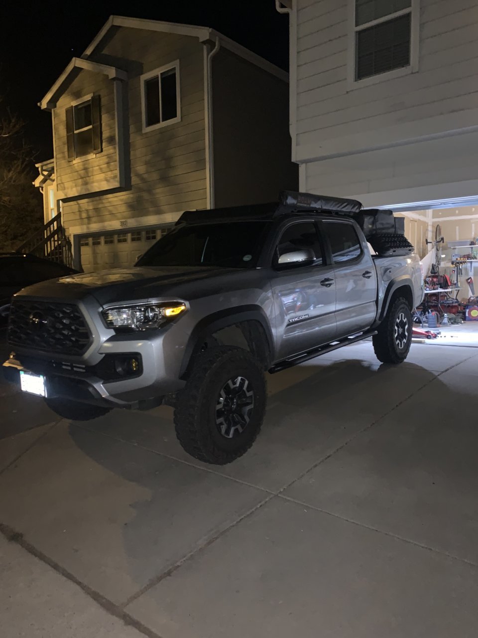

    Update:
    Threw on the 220 struts with the 352 coils tonight. I’m at 40” ground to fender, 24” hub to fender. Will remeasure in a few days after I do the AAL and let everything settle.
  8. Dec 13, 2021 at 7:33 AM
    #1348
    TheColoradoAthlete
    TheColoradoAthlete Well-Known Member
    Nov 2, 2021
    #381100
    104
    Colorado, USA
    2020 DCSB TRD OR
    Front: 220 struts, 352 coils, UCAs
    Ground to fender: 39”
    Hub to fender: 23.5”
    Rear: 940 shocks, 110R, AAL
    Ground to fender: 40”
    Hub to fender: 24.5”
    2020 TRD OR DCSB with the following additional weight: roof rack, awning, CBI overland bars, Smittybilt tent, RCI sliders, and some light shit bolted to the rack (axe, shovel, recovery boards). No bumpers or winch yet.
    Tires: 255/85/16 Yokohama Geolandar G003 M/T on stock 2020 TRD Off-road wheels

    2024 dcsb TRDOR blue crush
    Stock
    Can we get a front pick to see how the skinnies look? I bet very nice

  18. Dec 20, 2021 at 10:00 PM
    #1358
    TheColoradoAthlete
    Nov 2, 2021
    #381100
    104
    Colorado, USA
    2020 DCSB TRD OR
    Sure thing, I’ll take one tomorrow
