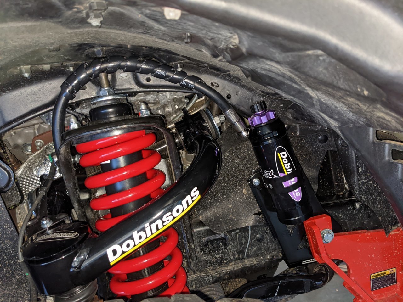

    Anyone have any suggestions?
    Yep, just went through this. It was a pain in the ass to get the UCAs in. Had to do a little bit of cutting.

    My rear MRA's came with some thick plastic sleeves that you could use to protect the hoses from rubbing. Did yours not come with those?

    '21 DCLB TRD Off Road - Army Green
    I have two plastic sleeves in the box with the rears, but my fronts didn't come with anything like that.
    I cut up a hose for the time being, but I want to find something that'll cover it better and maybe look cleaner.
    brtnstrns[QUOTED] and CygnusX191 like this.

    Ah interesting. I figured fronts would have them as well.
    How do you like those struts? I've only got the basic Dobinsons ones right now.
