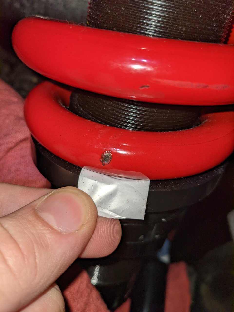

    I also had some concerns and frustration with the quality of some items.. here's just two below.
    Here's a sticker that was placed to cover raw metal. I had to order touch up paint before even finishing the install.

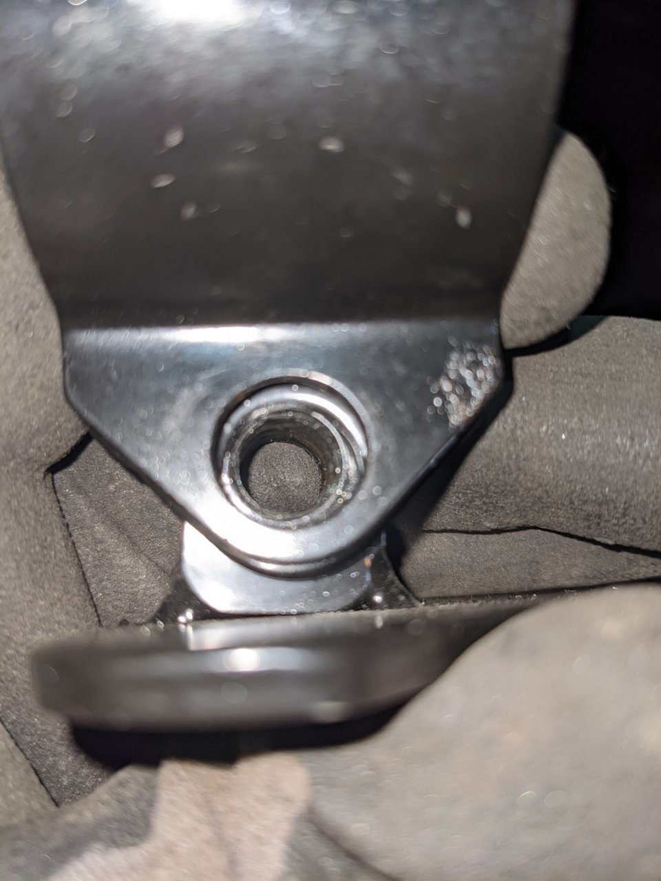

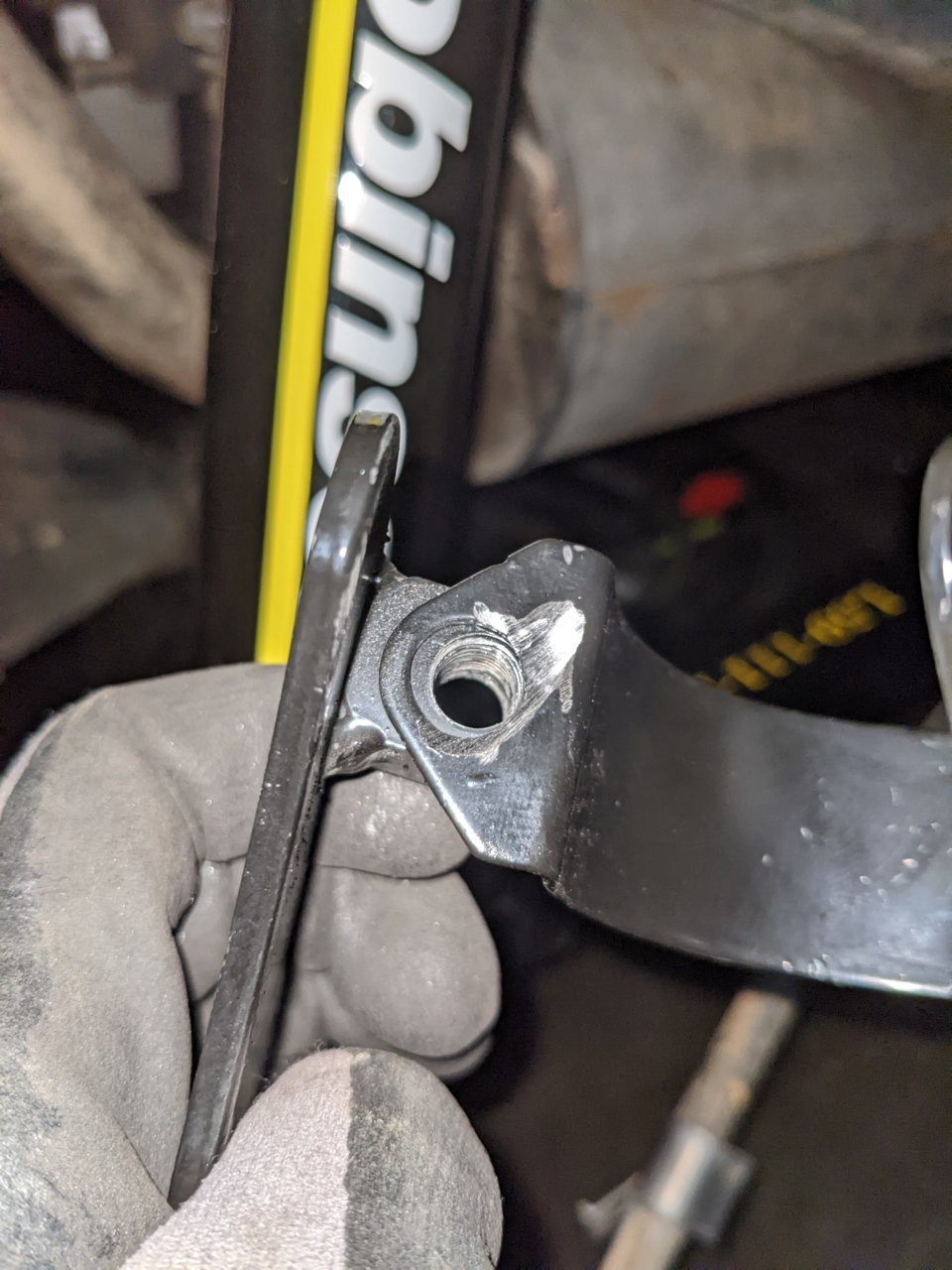

    This is a reservoir bracket to mount one of the rear reservoirs. A weld was made too close to the hole, and it wouldn't allow me to put the bolt through. The only bolt included that would fit that hole is about 2 inches long, maybe a little longer. The bolt was much longer than the hole. Dobinsons included a nearly inch long washer, but the bolt was still too long to tighten. I had to grind down the weld, re-tap the thread in the hole, then repaint the exposed metal. Wasted a lot of time.

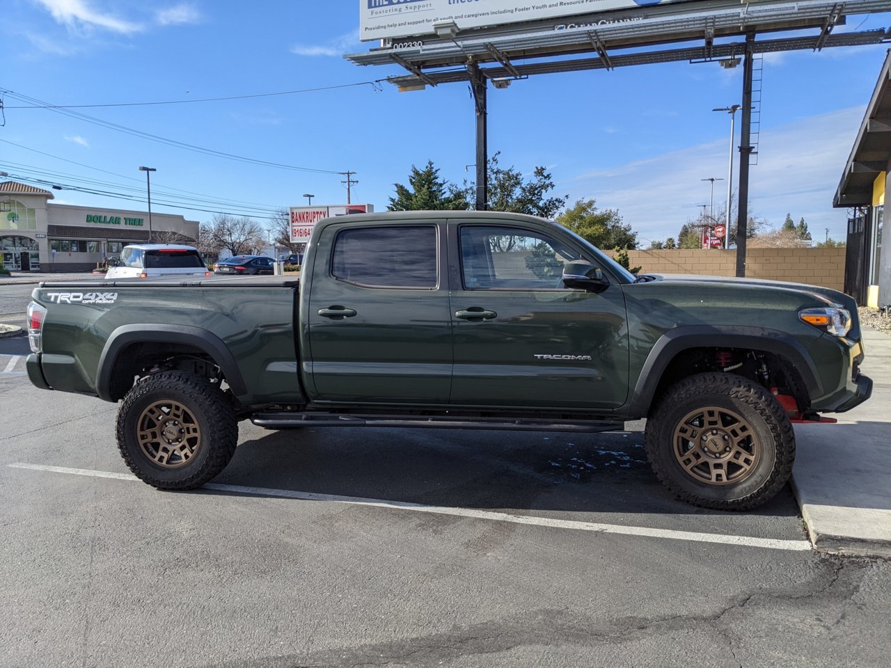

    Edit: I figure I'd add my before and after measurements (hub to bottom of fender).
    Prior to lift:
    Front driver: 20.5in
    Front passenger: 20.6in
    Rear both: 21.5in
    After lift:
    Front driver: 23in
    Front passenger: 23.1in
    Rear driver: 24.5in
    Rear passenger: 25in
    I'm sure it will settle a bit more. It went up a bit higher than I was hoping for.
