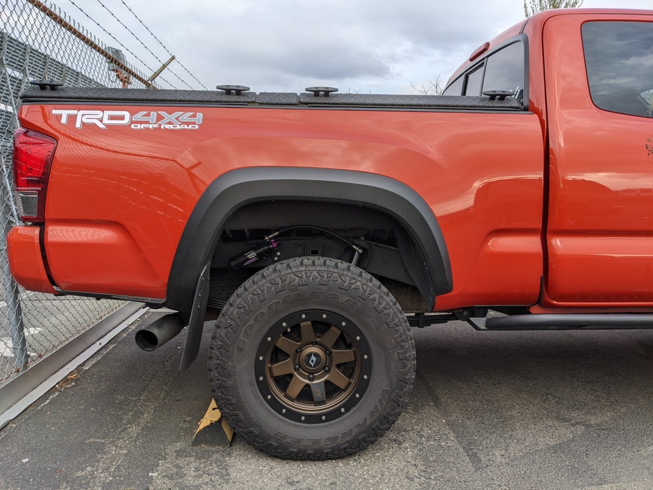

    VLTHNTR77 Well-Known Member
    May 27, 2016
    #188028
    697
    Andrew
    Everett, WA.
    2016 Inferno TRD off-road
    RCI skid and sliders, GoodYear Ultraterrains, HID's, SCS SR8s, lots of ME-SO goodies, Diamondback HD.
    Here is a picture of of mine.
    Only about a week after installation.
    Tires are 265/75 R 16.
    Hope it helps.

    CygnusX191
    CygnusX191 Gangster of Boats
    Nov 29, 2016
    #203575
    21,058
    Timm
    St. Louis, MO
    So. Many. Stickers.
    The best color
    Did you do extended brake lines with it having that much rear lift?

    VLTHNTR77
    May 27, 2016
    #188028
    697
    Andrew
    Everett, WA.
    The stock lines aren't too bad since I didn't get the extended travel shocks.
    Mike at Exit Off-road is very knowledgeable if you have questions.
    I did order the 2 inch longer lines as a "just in case ". Just don't have them installed yet.
    I'm going to give the suspension some time to settle. Then decide later.
