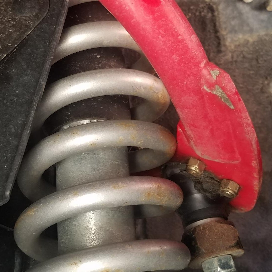

    To get the full travel out of them, and avoid issues, you should run aftermarket UCA's with the IMS59-50220.
    Here's an example of a UCA design that allows a heap of droop but does not have added coil clearance on the inside, which is why I can't recommend JBA UCA's in conjunction with Dobinsons extended travel struts.

    The JBA's are the only ones I'm aware of that lack the inner clearance.
    Nothing will break if you install the 220's with stock arms, then check for clearance. You'll know during install if they contact.
