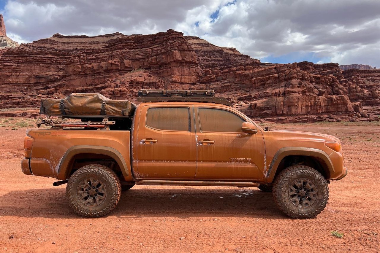

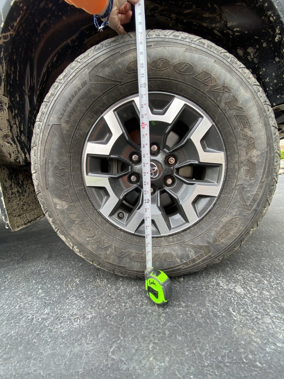

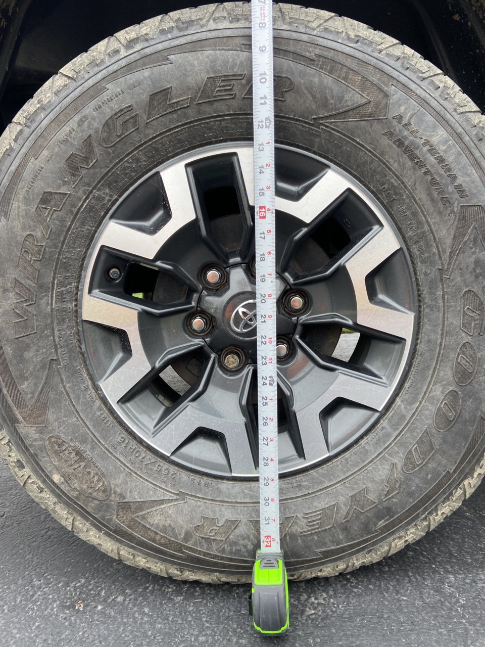

    Making a new post as quite a few people liked my original post and wasn't sure if they would see the EDIT
    I will be taking better pictures hopefully tomorrow for y'all
    My suspension come in and was installed this past weekend by myself and my dad. Full install took about 6 hours with no complications
    New ride height is 23" all around, gained 2.5" up front and 2" in the back. I ended up being leveled instead of having a bit of rake.
    I put wildpeak at3 285/70/17 on the wheels and I have driven ~15 miles very gently on it so far. I have to take care of some rubbing happening this week and then I will feel better giving the truck a real shakedown and pushing the suspension.
    @Crikeymike was an insane help with getting me the right parts for what I was looking for and answering all my stupid questions so fast. Mike thank you again for helping me out, your customer service is incredible and your knowledge is awesome.
    I'm thinking of doing a complete build guide along with a suspension tutorial/guide. Dobinsons and exitoffroad have great instructions however there's there a few things I couldn't find and I had a few different documents combined to make myself a full guide.
    The only issue I had, which i've seen another user post before, was the paint on the springs being all fucked up.

    Looks good man!! It should settle in over the next 500 miles or so, depending how much flexing the suspension gets.
    Looks like you peeled the sticker off, it also covers the spot where the coils are hooked during powder coating.

    That's what I figured, that it was during the painting process. Thanks Mike!

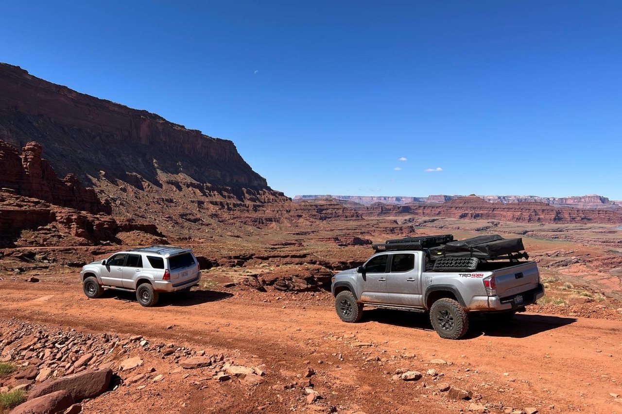

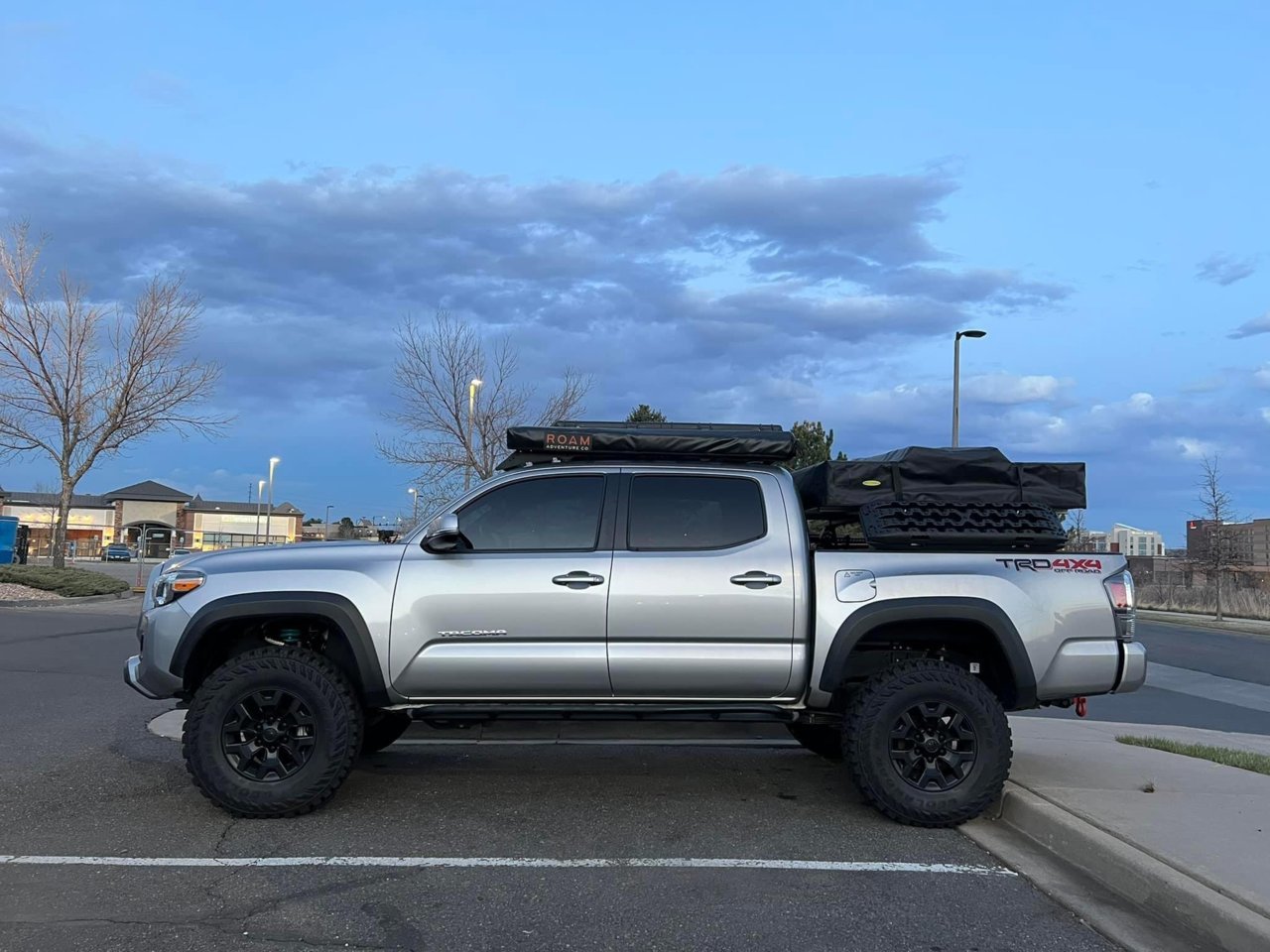

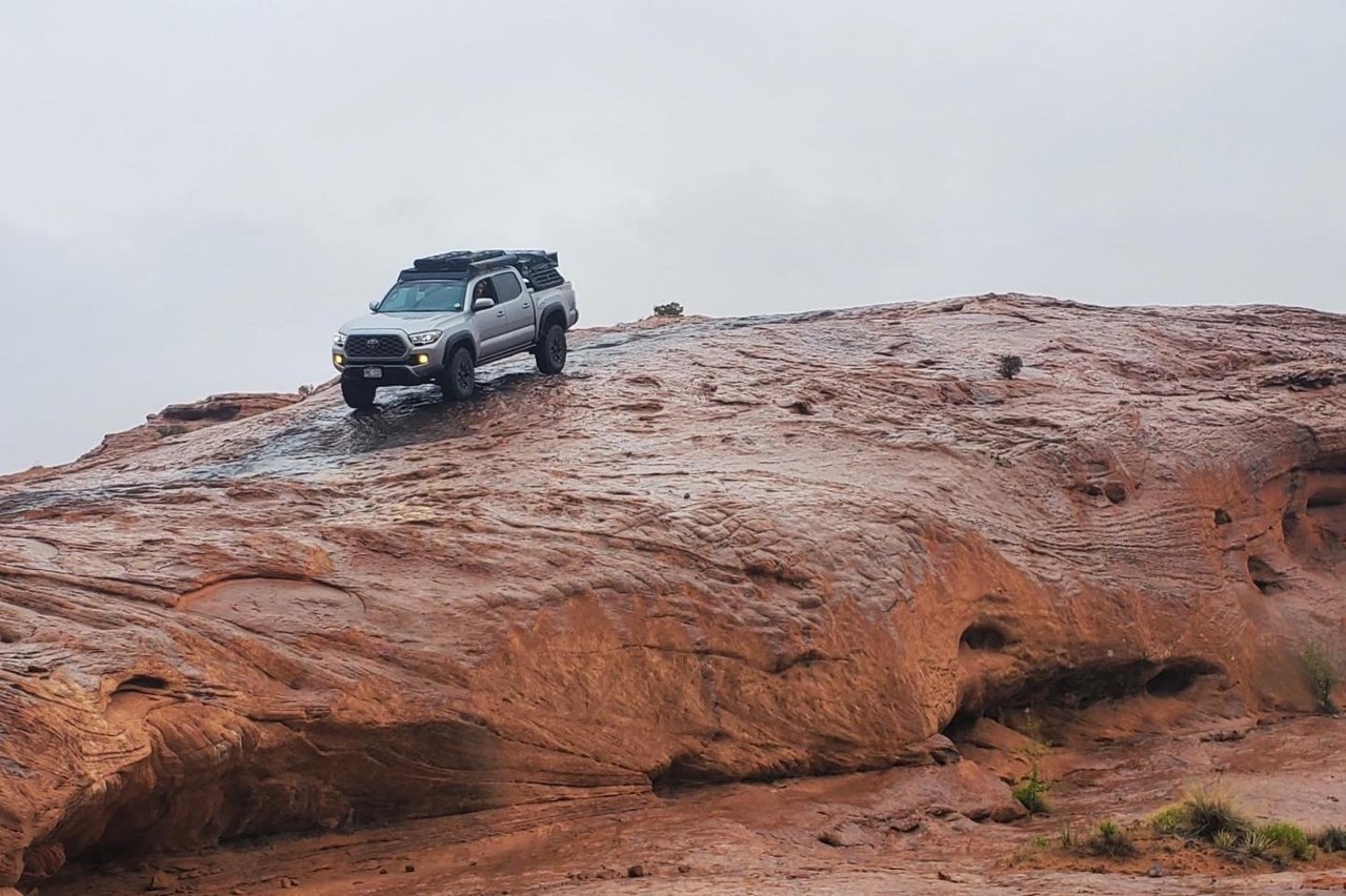

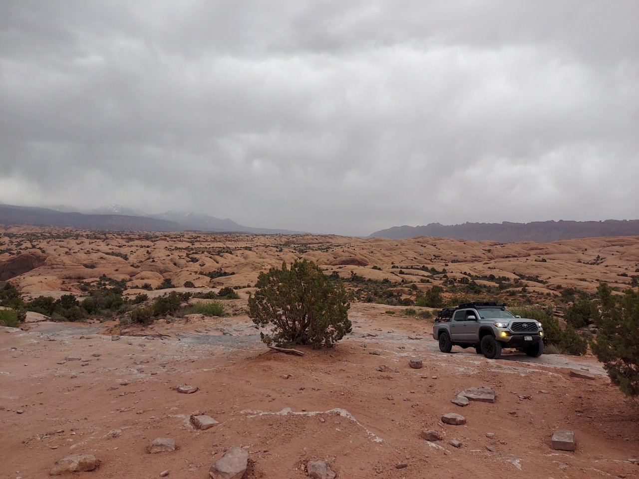

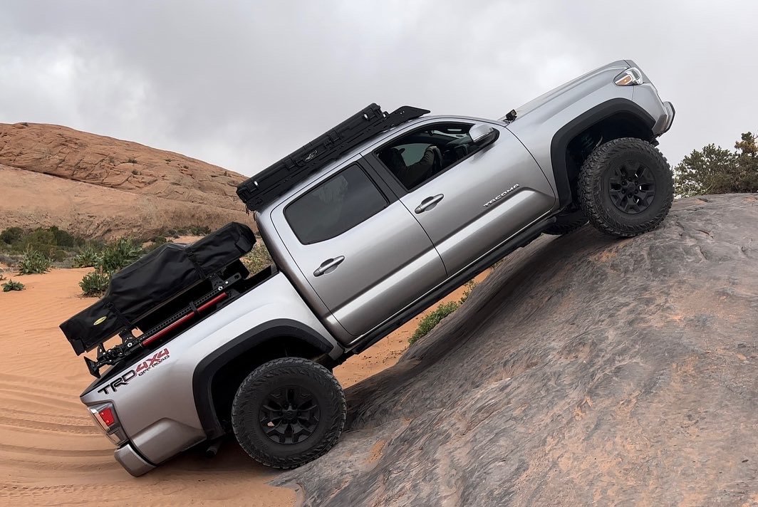

    6 months or so update, meant to do a sooner one but my entire neighborhood burned to the ground in the Marshall fire back in December… oh well, shit happens.
    Went to Moab a month ago, ran the entire Hell’s Revenge trail in the rain. Suspension did great, removed my sway bar and haven’t put it back on since.
    I’ll measure my hub to fenders later today and edit this post.
    FD: 22.75”
    FP: 23”
    RD/RP: 24”
    Components:
    Front: 352 coils, 220 struts, UCAs
    Rear: 940 shocks, 110R, AAL
    Wheels/Tires:
    Stock 2020 TRD OR wheels (dipped)
    1.25” spacers
    255/85/16 Yokohama Geolandar G003 MT
    Daily Weight:
    Prinsu rack
    2 rifle cases with tools and recovery gear
    Roam 5’ awning
    RCI sliders
    CBI overland bars
    Smittybilt tent
    Traction boards
    HiLift jack
    1Up HD 2 bike rack

    Oh man!! It must have been fun dealing with all that mud, and then getting into your tent!! hahaha
    Thanks for the post and the photos. The truck is looking awesome!!

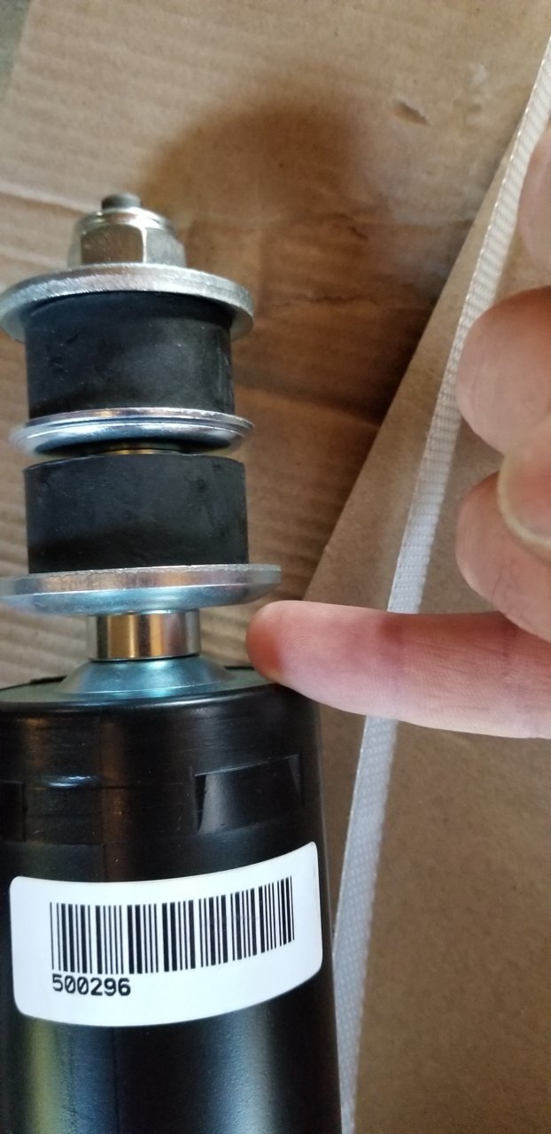

    Could anyone advise on this small spacer. I am installing my coils, this small aluminum spacer is not mentioned on Mike's video. I assume it's where it needs to be? Any confirmation would be great!

    It stays in if you're lifting more, so that you get a little extra down travel. Leave it there if you're doing 2.5" or more of lift.

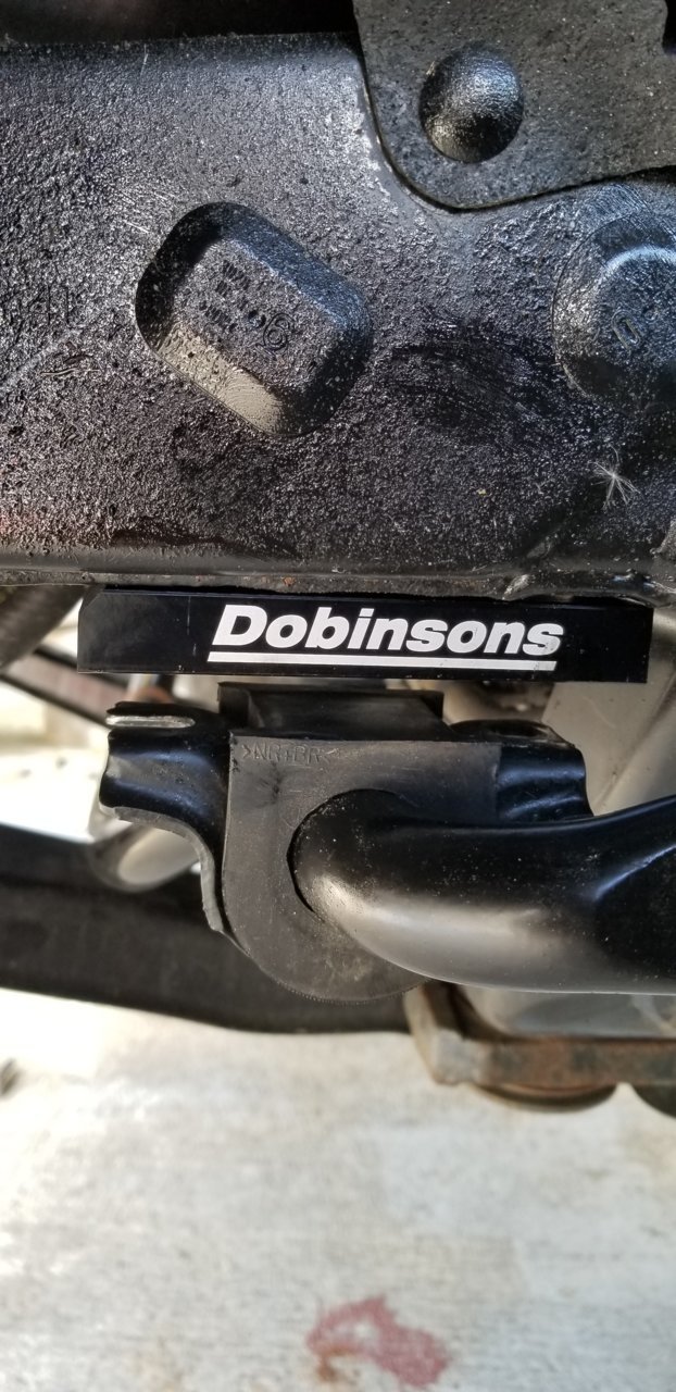

    Having an issue with my sway bar mount after installing my lift. I was preparing to install spacers when I noticed this 1/2 inch space on the driver's side. Logic tells me to remove the "Taco lean" spacer to correct it. Has anyone else experienced this?

    Update!
    Spacer removed all is well.
