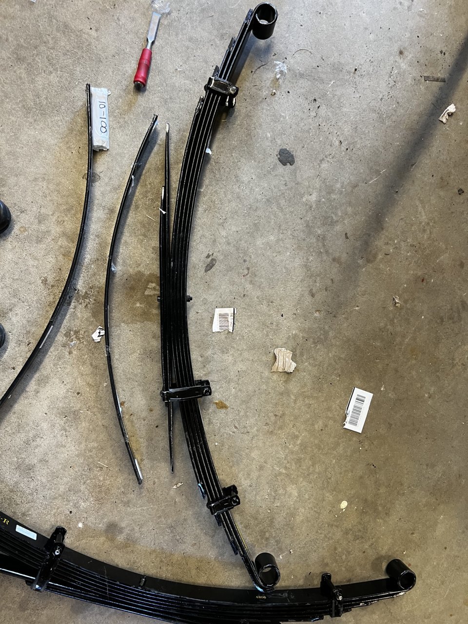

    I see, so is the photo of the rebound clip basically just showing that you need one with enough room to support the additional leaf? Does the bolt on these need to be removed, or can it be left in place?

    Does anybody have instructions on where the L59-123-R add a leaf spring sit on the L59-112-R pack.

    It becomes the 6th leaf down from the top when installed. The part number of it ends in 6, which is the position designation.
