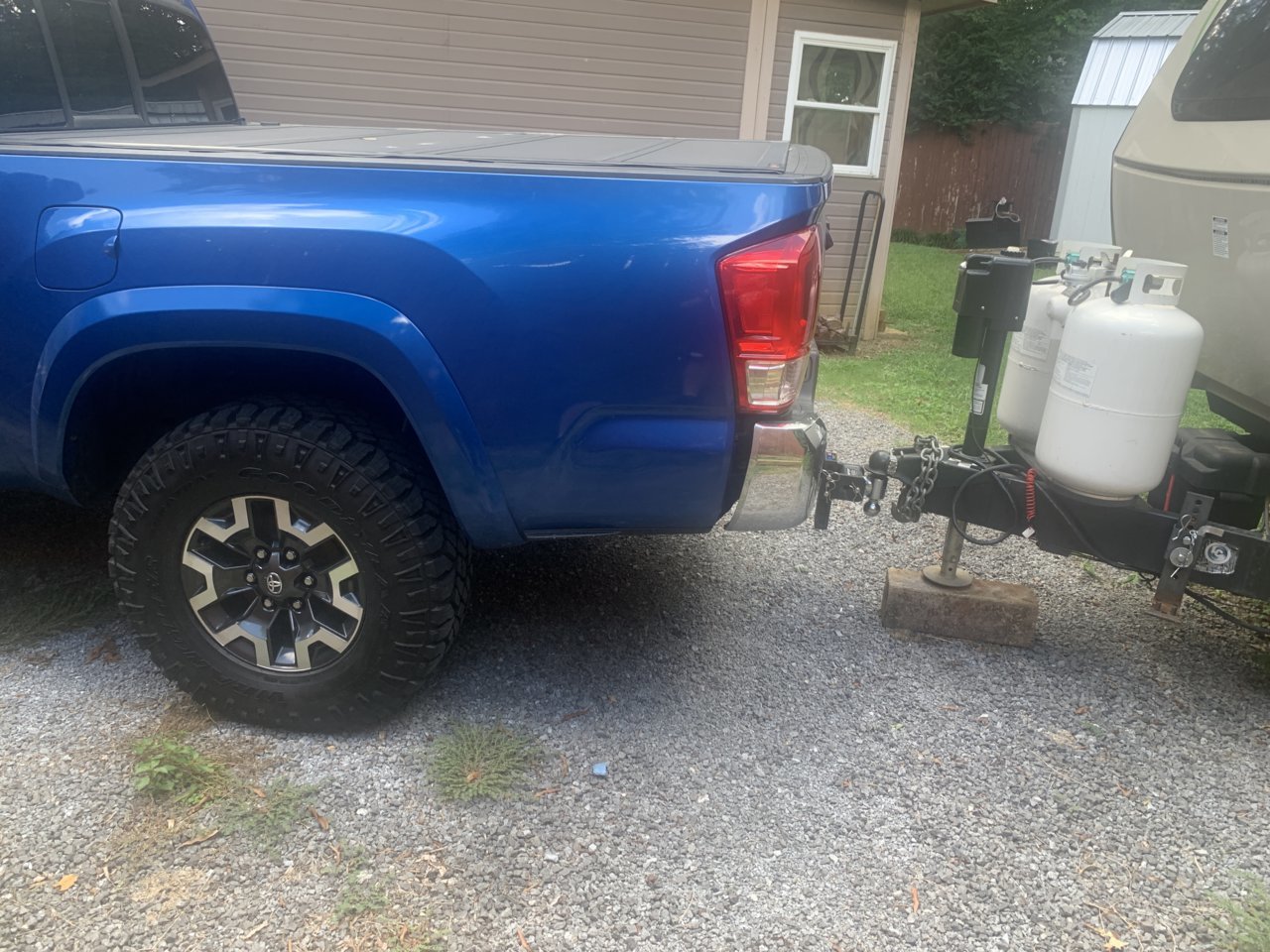

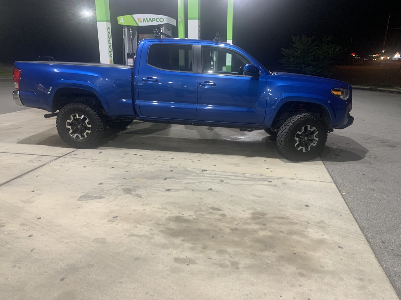

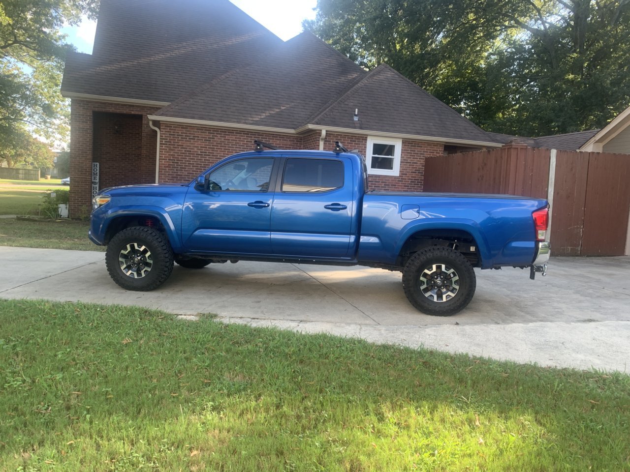

    Update to my previous post with more details, now that the entire lift is installed. Better pics to follow.
    front: 314 coils on 221 struts
    Rear: 111r leafs with -940 shocks
    265/75-16 Goodyear Duratracs
    1.25” Spidertrax spacers (front only, rear haven’t came in yet)
    EDIT: I put my 7K+ lb camper on it today to help the springs settle.

    Why the spacers? Looking to get bigger tires later?
  13. Sep 8, 2022 at 4:59 AM
    #1573
    Coondawg07
    Coondawg07 Master of none
    Aug 2, 2022
    #402691
    136
    Alabama
    2016 DCLB BBP
    i had originally planned for 285s. I don’t know where the plan fell apart. I probably should’ve forgone the spacer with this setup, but it does look nice on the front.
    CygnusX191[QUOTED] likes this.

    Looks nice.
    How's the ride with the 111r leafs?
    On my 2nd gen DCLB, I switched to Dobinsons IMRs front/rear and 314 coils last spring. The rear stayed stock springs with a 3 leaf progressive pack from Headstrong.
    CygnusX191 likes this.
  15. Sep 8, 2022 at 5:22 AM
    #1575
    Coondawg07
    Aug 2, 2022
    #402691
    136
    Alabama
    2016 DCLB BBP
    i can only describe it as riding like a truck. My last truck was a Titan XD (no judgements, I loved it). When I switched to the Tacoma I felt like I was driving a Crown Vic. It was very soft and floaty. It’s now firm, but not harsh; No more brake dive.
