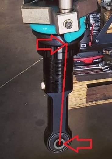

    Picture of the measurement points:

    :frusty:

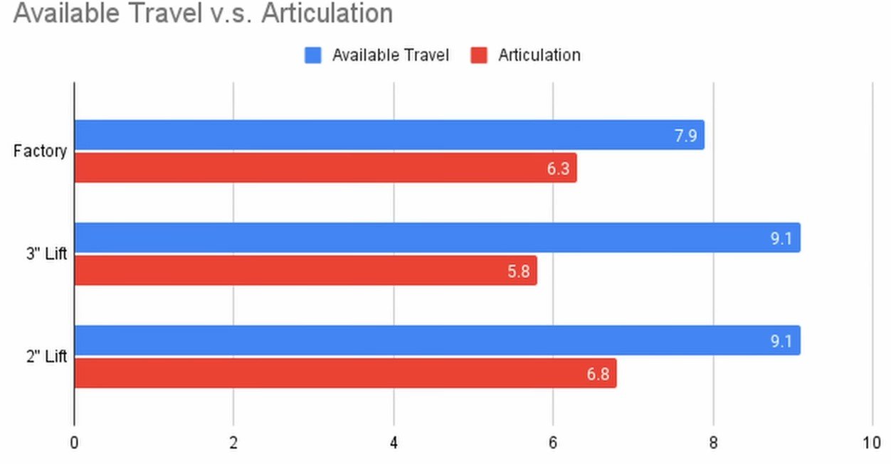

    Who would have thought that limiting your lift to 2 inches actually gives you more suspension travel? :evil: @7:55 Part 2

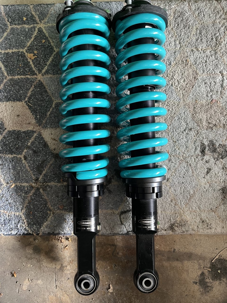

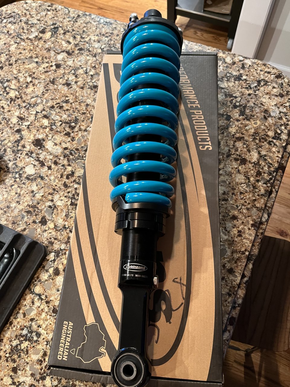

    @Crikeymike dont see my struts marked A/B and want to be completely sure. Left strut in the pic is seated higher so this is the driver side correct?

    Been saying this for years and I show people this video and people still think they need a 6-in rough country lift. :rofl:
