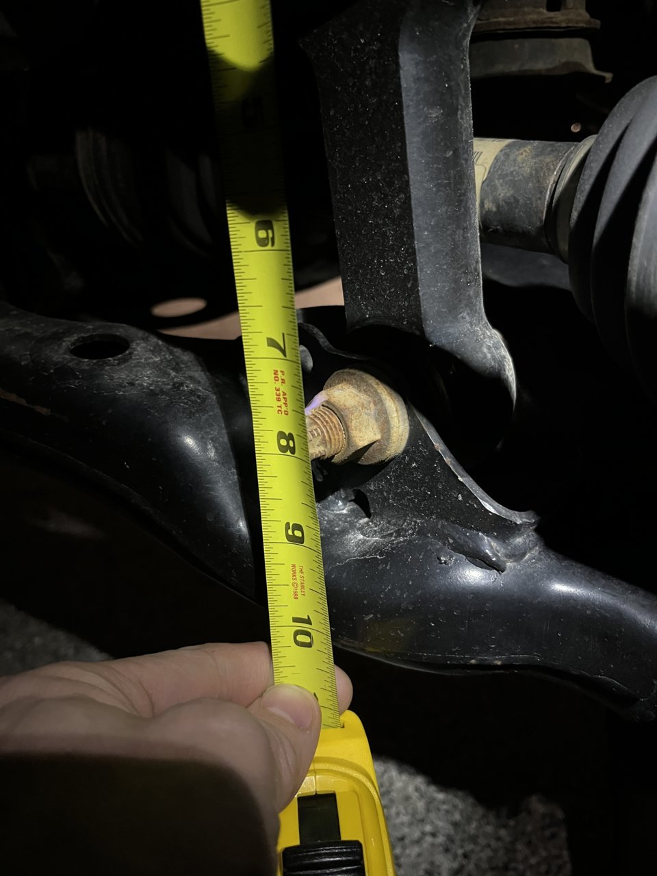

    They said “We use the 5074 struts since it has about a 1/3” more droop than the 50220 which pairs well with the aftermarket control arms that are on your truck”. Not sure how legit that is but as long as it’s valved the same…
    Next curiosity, I’ve not been entirely happy with the amount of front lift so I got under the truck tonight to measure the coil seat height.
    It’s not the most accurate measurement but it seems like the seat isn’t close to 213mm(8.38"), seems like it’s 8” or under. The end of the tape was at the base of the perch, where the top locknut and seat meet.
    What’s your thoughts, does it looks like it’s set correctly for 314s?
    edit: after reading more posts I thought i should add that I’m at around 21.5” hub to fender.

    Can't tell from that photo. You should be at 22" hub to fender with stock weight and those set properly, so you'll want to raise it up a little.
