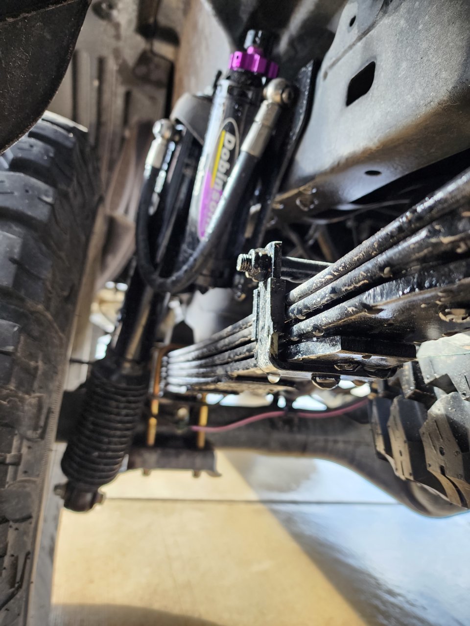

    Boy the shop had my hs at 3 and the LS at 14 all around. Just to be clear you suggest rebound at 1 also for 500 miles?
    I do have a C4 stealth bumper with winch, Dual ARB and rails on the way so I'm hoping the 352 handle it.
    Also I'm looking at the way the shop mounted the rear and worry about the leaf hitting the reservoir. Is this normal with the provided mount?

    Everyone has their own preferences on the settings, and maybe that's the way they like them. Yes, setting it all out to zero for the first bit to let everything settle in is what I recommend.
    The hose should normally follow the frame rail up closer, like the photos on the website:

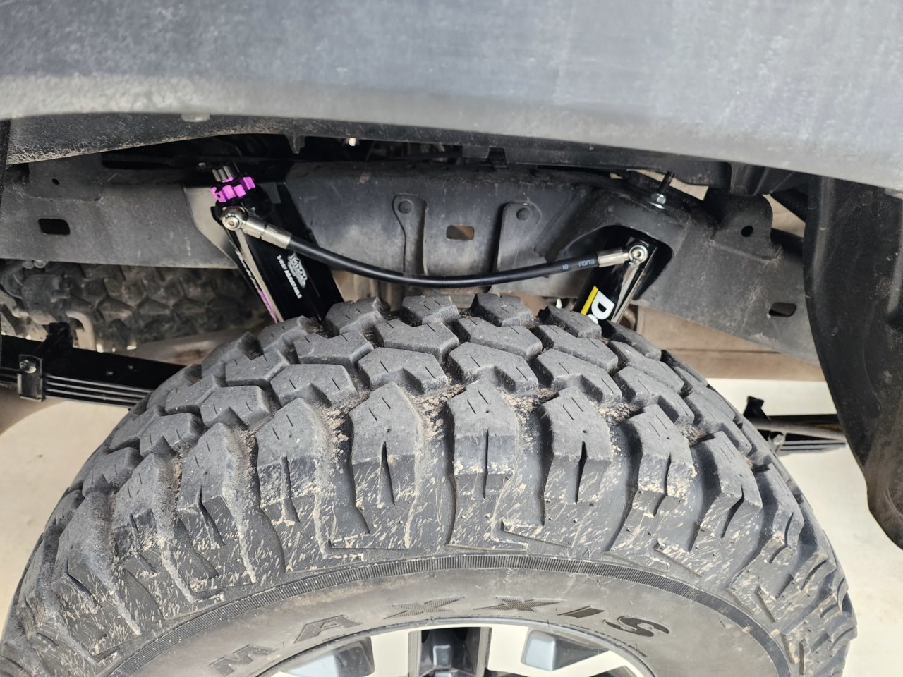

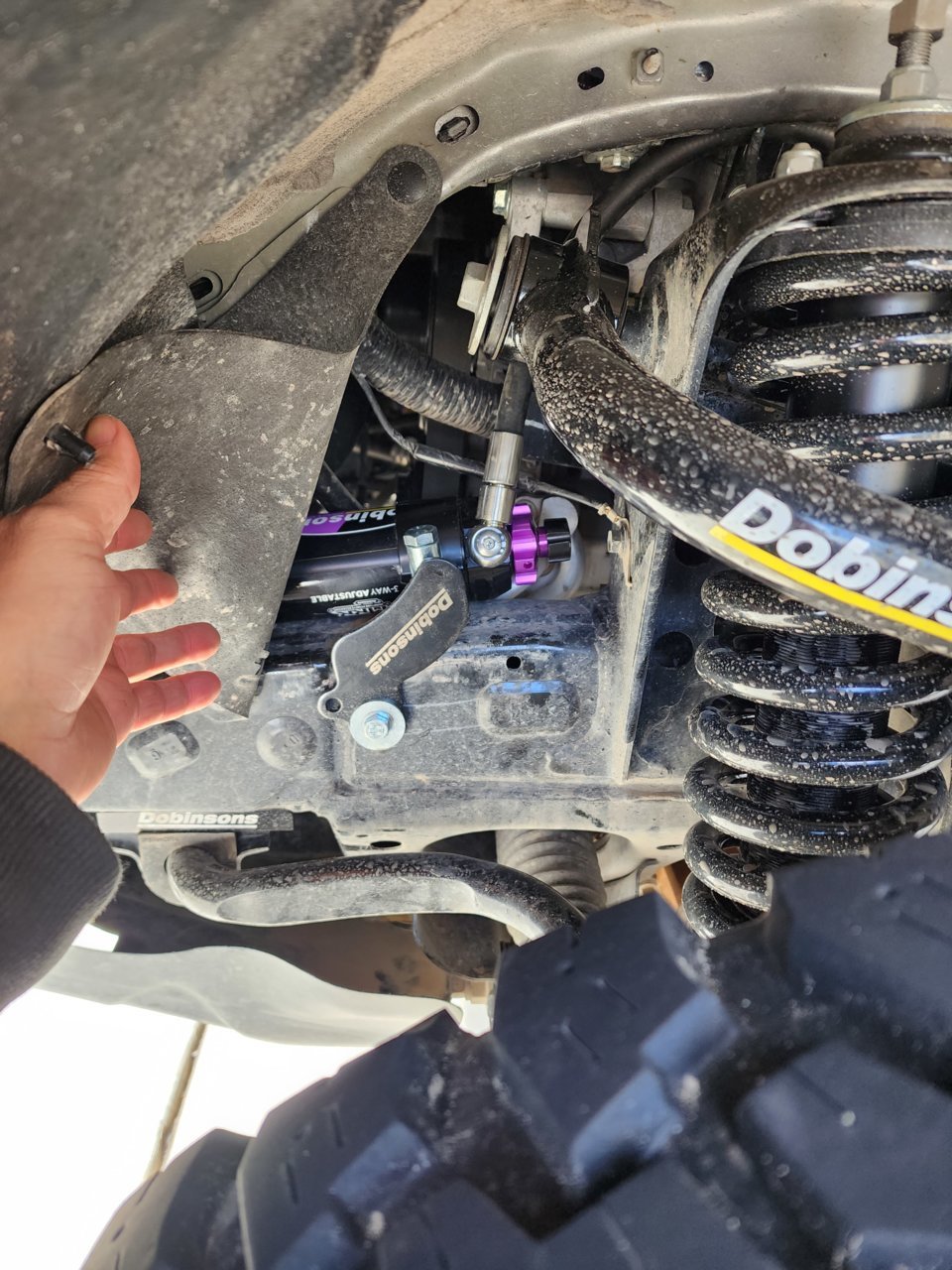

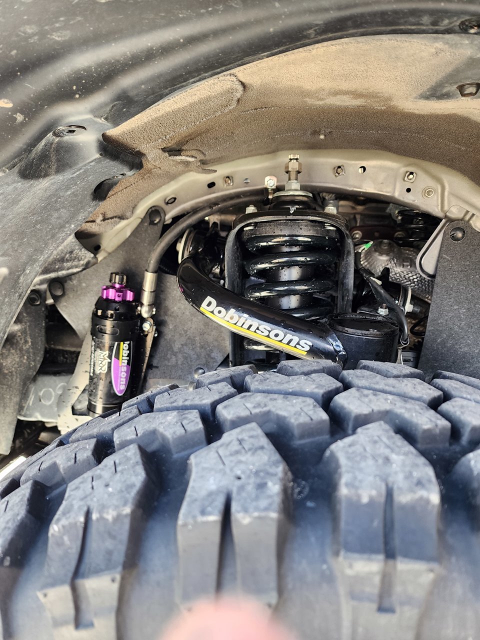

    I wish they did mount like that but unfortunately I wasn't lucky enough. I am concerned that the leaf will contact the bottom of the reservoir but not it looks like the bracket included was ment for this position. Also not a fan on how they put the front reservoir behind the splashguard. Helps keep it clean but sucks to have to open for adjustments.

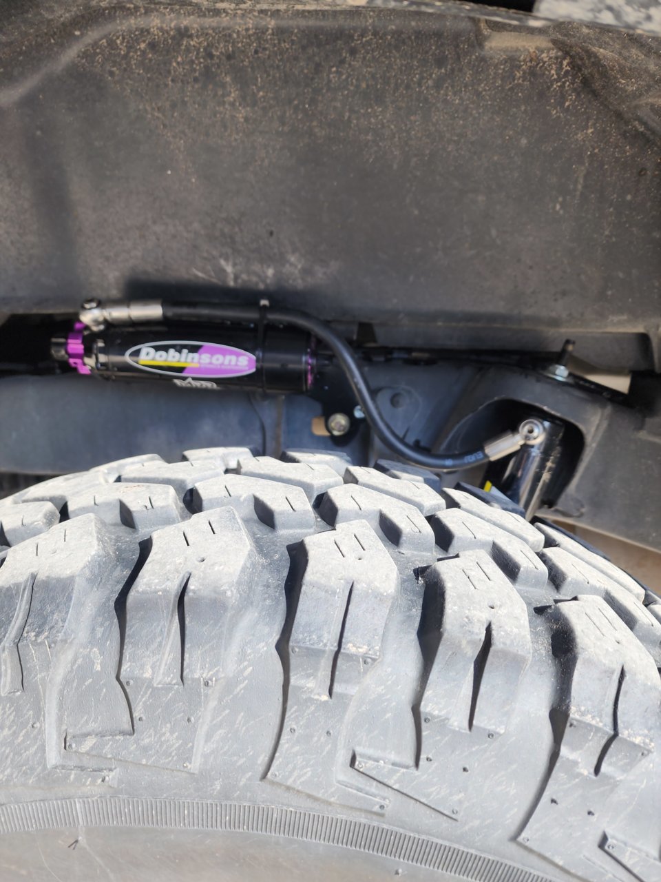

    What's everyone's thoughts? Did my shop use the right mounts for remotes? I feel like they used the rear in front and fronts in rear.

    They put the front swaybar bracket upside-down in the rear, and vice versa. o_O

    The rear brackets came in the box with the rear shocks, and the fronts with the fronts. Someone mixed them up, not Dobinsons lol

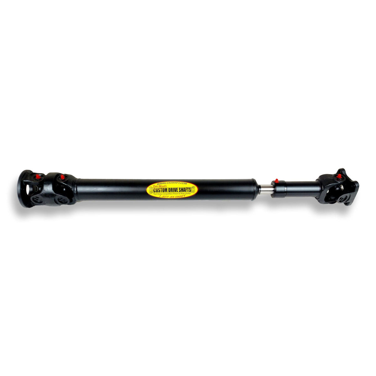

  16. Mar 15, 2023 at 6:51 PM
    #1716
    splitbolt
    splitbolt Voodoo Witch Doctor
    Mar 7, 2010
    #32761
    7,858
    NW Arkansas
    2016 TRD OFFROAD DCSB MGM
    So, your rear drive shaft has a double cardan joint at the front and a standard u-joint in the rear?
    Like this?
    If so, the pinion is supposed to angle up so the rear u-joint working angle is zero; completely straight...when in operation.
    shotgunbilly420 and CygnusX191 like this.
