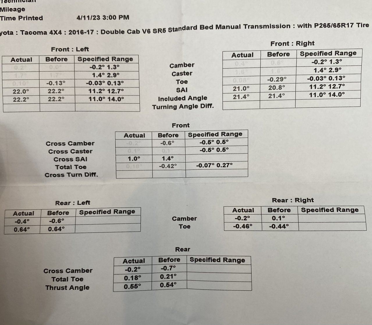

    19’ TRD Sport Dbl Cab M/T
    5100’s w/AAL, Dobinson's 314 coils. 285/70-17 BFG KO2's, 17X8 Pro-Comp 89's 0 offset, BA Highline Front Bumper, K&N FIPK CAI. N-Fab Podium steps, Gatorz Low Profile Hard tri fold Bed Cover.
    Not an alignment expert, actually quite ignorant when it comes to alignments. Put my both 314’s replacing my stock coils on 5100’s on 1st notch I’m at 22.5’ish on LF and 22 5/8-3/4’ish on RF stock UCA’s. How’s this look, can I get by on stock UCA’s for 9-11 months?
    CygnusX191 likes this.
  16. Apr 11, 2023 at 8:51 PM
    #1736
    CygnusX191
    CygnusX191 Gangster of Boats
    Nov 29, 2016
    #203575
    21,091
    Timm
    St. Louis, MO
    So. Many. Stickers.
    Caster is a little weak, should've pushed it farther forward.
    Overall looks pretty decent though. (I'm also tired, so don't sue me if I missed something lol)
